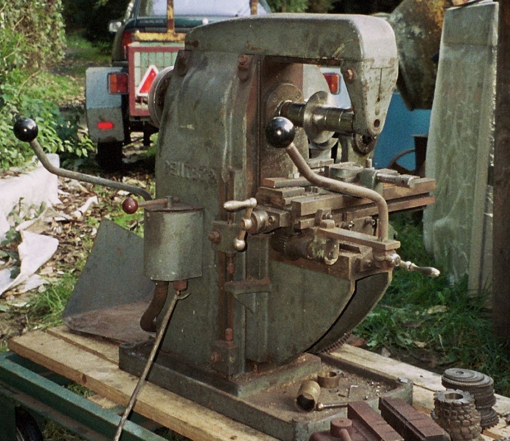

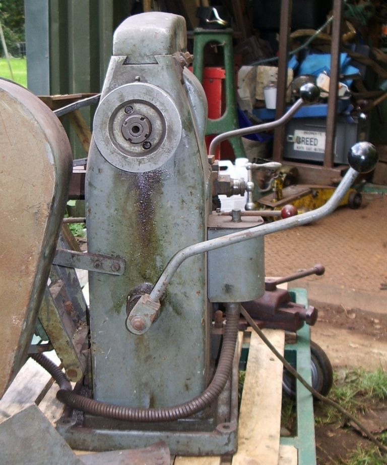

                Hi Brian, Dave is right, the Centec 2 is the first model of the breed and is basic. If your one looks like the two photos below, then that's what you have.
                The lever on the back turns a cam, which lifts and lowers the knee.
                Regards Nick.

                  Nick is right about that particular 'breed' – the ones with a removable overarm – which could be replaced by a vertical head (hence the pulley on the back of the machine). The predecessor, the Centec, had a fixed overarm -so was only a horizontal mill.
                  They clearly had not thought about progressing the original design or they would have called it the Centec1.

                    Thank you Nick and Dave. My machine does have the jack, I assumed it originally had a better system.
