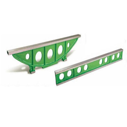

      Hi, does anyone know where you can buy cast straight edges, for the purpose of printing dye on to ways for scraping?
      I found some companies selling them in India and China, but no retailers in the UK whatsoever.cast-iron-straight-edges-500x500.jpg

          Don't know of any new finished ones in the UK. There's a guy in the South West sells the odd casting for 12" dovetail straight edges and they are nice to scrape in but you'll have to machine all the working faces first.
          Kblast straight edge
          Other than that you can buy King castings off eBay but they also need machining, perhaps stress-relieving and then scraping to finish before you can call them good to use. You're looking at 400 quid for an un-machined casting, plus import and vat most likely.
          Used ones are very thin on the ground.

                  Better to get an old English made straight ,where the castings were allowed to "weather" to relieve the internal stress and were often rough machined and then left to stand for some time before final finishing,Using new "green" castings is not a good idea,Try the second hand tool dealers.

                                        Raw straight edge castings need stress relieving. The HKA-x ones you see on ebay are King design and the finished ones they used to sell were stress relieved, rough-machined, stress relieved, machined then scraped, sometimes with a third round of stress relief thrown in. The ebay ones have one round of stress relief and are said to require no more but it's still possible they would move during machining.
                                        Even old, previously-finished straight edges can develop a twist over time. I bought a 36" one which looked pretty good but had about half a thou of twist in it.
                                              So what is the process of 'stress relieving'? I was under the impression it was the casting being left for a period of time? you mention several rounds of stress relieving? what is involved in this?

                                                Parts are heated in a stress-relieveing oven to a specified temperature over a specified time period then controlled cooling. Any good heat treatment place will do it.
