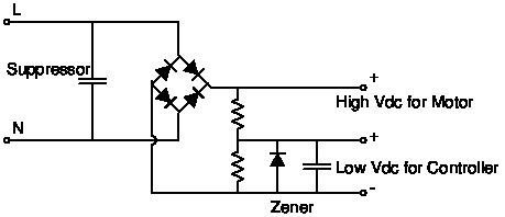

      I've got some capacitors that look like the Brown thingy except they're reddish-brown. Any markings on it.
      If a capacitor, it's probably a suppressor. Next step is to trace out the board to find out what connects to what.
      Are there 5 wires connected to the board or only 4. If 5, two reds?, you might have something like this:
      I've said Low Vdc for the controller, but it might only be for the LED.
      The components look too flimsy to be powering the motor, yet it connects to the mains on/off switch. Is it the only way power can get to the tool?
      Dunno!

        Andrew – Ok, so that could be a problem then. Can you suggest which capacitor might be performing which function and whether it failing would cause high voltage DC on the output?
        Dave – This isn't the motor controller, it only does the LED. Takes 2 wire 240v input (RHS of insert pic labelled L & N) and presumably is supposed to give out low voltage DC on the two wires to left labelled + & -.
        No, I dunno either, web search gives lots of possible circuits but which this is I'm not sure.

          If the circuit includes a capacitor dropper it'll be the brown device that is doing it. The electrolytic will not like AC up it (see note below). I'd hazard a guess that the brown component is dropping some AC voltage, the bridge rectifier is operating at a low AC voltage and the electrolytic is smoothing the bridge output. Although I wouldn't have thought that the electrolytic was really needed. Any flicker will be at 100Hz and probably not be visible.

            Right, thanks. Further investigation to follow, although it occured to me last night that I might be better off gutting a GU10 LED spotlight and using the bits from that, after all if the original failed once it may fail again even if I repair it.
