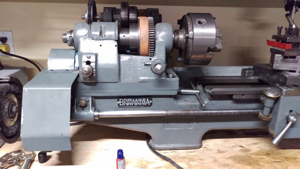

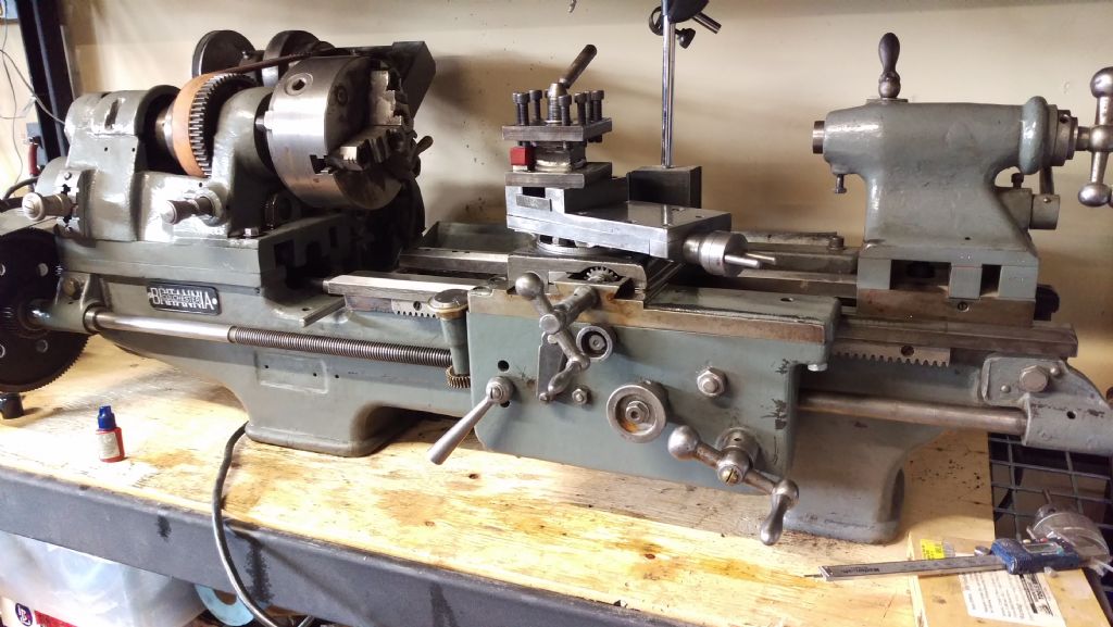

      Hello everyone,
      A question from Vancouver Island Canada:
      I recently acquired an old Britannia lathe.
      I it looks like the lathe has been modified (at least that's what I think) quite a bit.

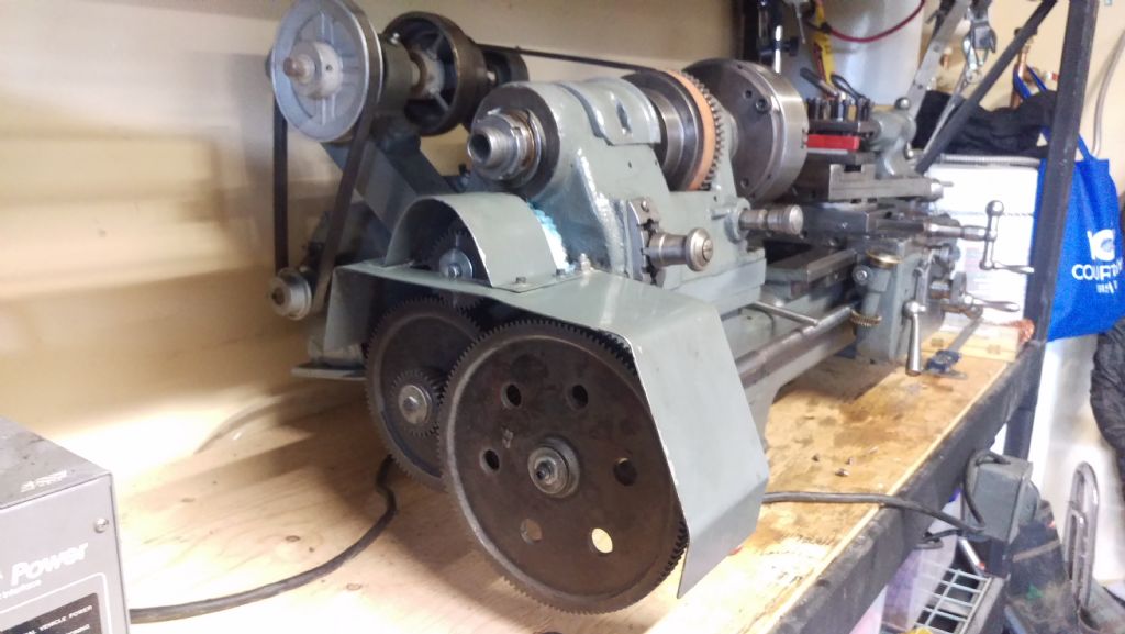

      I have a box of back gears with it but don't have a clue what gears to use if I don't have some kind of guidance.
      The problem is that I can't find any literature on this one at all.
      Is there anyone out there that could point me in the right direction? Of all the sources I found, none of them match this lathe!
      Thanks so much!
      Marinus

          Hello Marinus,
          Welcome to the forum, that is a nice looking lathe.
          Check out this article: http://www.lathes.co.uk/britannia/
          I am sure Tony (whose site it is) would be delighted to see [photos of your machine and may be able to offer advice.
          What you have are change gears for screw cutting and fine feed.
          If you use the smallest gears as drivers and largest ones as drive gears it should give you a nice fine feed for general turning.
          For screwcutting the ratios to use depend on the threads per inch of the leadscrew (probably 8 or maybe 4), what gears you have, a picture of the back of the lathe showing where they fit and what gears are permanently fitted to the machine (e.g. on the end of the spindle)

            Looks to be a later version of the second one illustrated on the Britannia home page at lathes.co.uk and in first set of photographs. No obvious evidence of significant modification.
            Typically machines of that era used fairly standard change gear set-ups. I have listings for some leadscrew pitches / TPI. Easy enough to copy and E-mail if one matches yours.
            The gear peeping out from under the end of the cross slide suggests it has power cross feed but where it picks the drive up from and how it's engaged is somewhat unclear. At a guess one or the other of the two round knob things" pulls out to engage the feed. Southbend et al used a keyway in the leadscrew but I suppose some form of gear engaging in the leadscrew rather after the fashion of a thread dial indicator is possible.

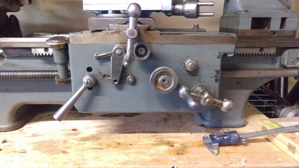

              So far I have figured out the following:
              In the picture below you can see the home made part ( the one with the small bolt sticking out) That one activates the automatic feed. Tightening up the smallest of the round knobs will activate the cross feed, and the large one the carriage.
              Moving the larger lever will cause the half nuts to clamp on the feed spindle and the carriage will move at a greater speed.
              On the left side of the head stock is the forward/reverse lever for the automatic feed. On the right side the lever to slow the lathe to tread cutting speed. (If I disengage the small lock on the front of the main gear in the head stock).
              That's about as far as I've gotten.

                First job !
                Replace that bolt with a socket grub screw and make the handle with the 'detente' to drop into those holes.
                Bonne chance.

                    That is a VERY nice looking Britannia lathe. Might be one of the last they made, a real classic
                    #298087
                    Anonymous
                      Great looking lathe! I nearly didn't open this thread as I assumed it was to do with the steam locomotive. embarrassed
