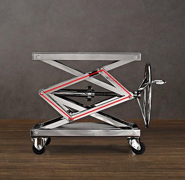

      Is there a specific name for this type of scissor jack:scissor_lift.jpg
      even better, is anyone aware of how to work out the possible pivot points without me having to dust off my rusty geometry ?
      The appeal is it having no need for a sliding joint as in a normal scissor lift
      Thanks,
      Dan

              Cyril – that is where I found the image in the first place unfortunately doesn't help much getting the dimensions worked out.
              Ady – a normal lift table doesn't have the extra/different linkage which gets rid of the need for a sliding joint, that's the bit I'm interested in

                    Sorry, only read the email update which didn't include the second link – that is extremely helpful (or at least will be once I remember how to use fusion 360 to import the solidworks model)
                    Old School – would have done if necessary, but the picture is of a decorative item, no way of knowing if it even works as shown

                        Already did (lego, not meccano). The length and position of the short linkage affect whether the top moves vertically only or also horizontally.
                        Am attempting to look at the model linked by Cyril to see whether it is an exact solution or not.

                          Except for the screw jack each pivot is the corner of a four sided link system. These are mechanism and are free to move in the vertical plane. The screw jack holds everything together because it is part of two (although only one is actually required) three link systems. A three link system is locked and is not a mechanism. I hope this makes sense.
                          The lift is not far removed, mechanically, for scaffolding. Unless there is a diagonal scaffold pipe in each plane the structure is very likely to collapse.

                                True, but it has more in common with a double scissor lift than a single as regards height vs length (which matters for my purpose), which would double your lever bits. In my case the bespoke leadscrew would be replaced by the guts of an electric scissor jack which I already have, so not quite as pointlessly overcomplicated as it looks

                                      I presume that what makes this do it's job differently is the parallelogram within the structure?
                                      It puts me in mind of that screwcutting attachment which the French chap posted a while back
                                      To my mind it looks like the top left hand side has no real support compared to the right hand side, the cross member goes waaay across to the far right before it has a load bearing point

                                          I think he means the short arm appears to give support to the RHS. It is perfectly possible to add a similar parallelogram to the LHS.
                                          The question we all want answered is how you decide on the length of the short arm for optimum performance without having to put in any thought effort into 'O-level' geometry.

                                            In the model, the distance between hole centres for the long piece is 20", the short distance between end hole and attachment point of the strut is 7.5" and the distance between hole centres on the strut is 7.492" (??)
                                            However, having tried that ratio in lego, it doesn't work as I expected, the top still moves off to one side as it goes up. Possibly this is inevitable, may have to actually read Michael G's link (thanks for that)
                                            Bazyle – I think a second parallelogram won't work unless the movement is completely vertical, which it doesn't appear to be in the example. Looking like avoiding thought may be impossible (probably would have been quicker in the first place )

                                              Oops, schoolboy error, used 16 and 6 hole pieced rather than 17 and 7. Works perfectly with ratio as above
                                              #267109
                                                It's congruent triangles (remember those).
                                                As long as top and bottom are identical (but rotated 180 degrees) it should work. Changing lengths will just affect how far it can move.
