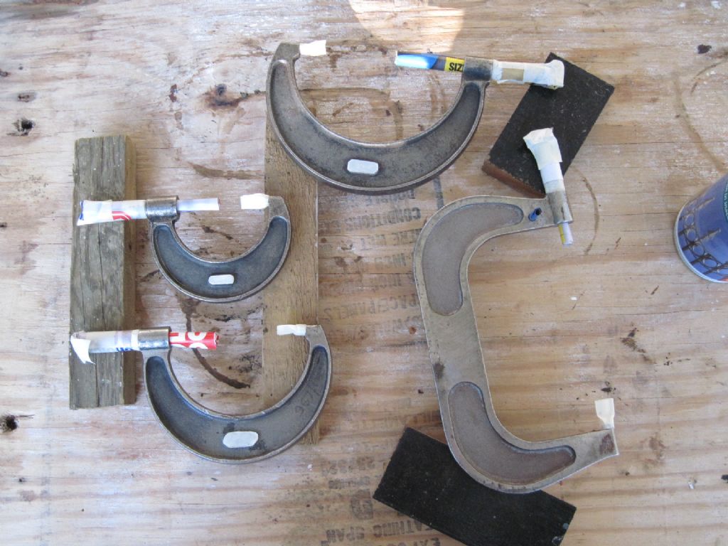

                                            Edited By IanT on 14/11/2020 11:35:27

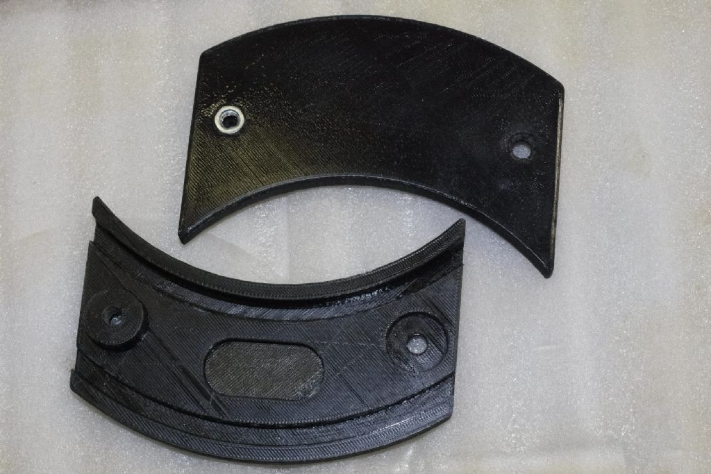

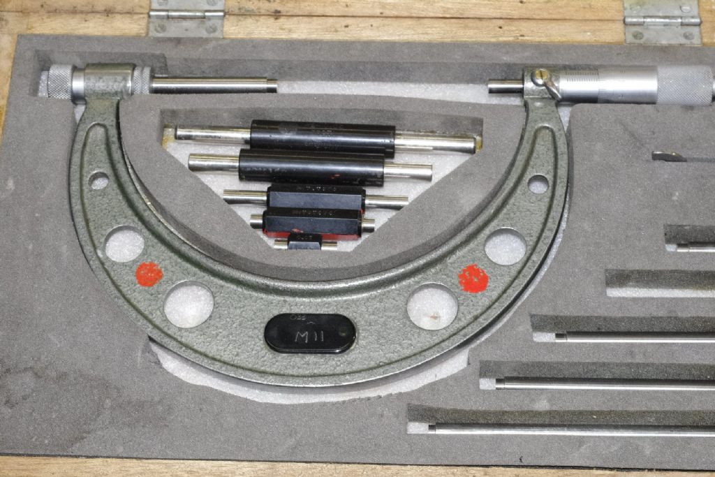

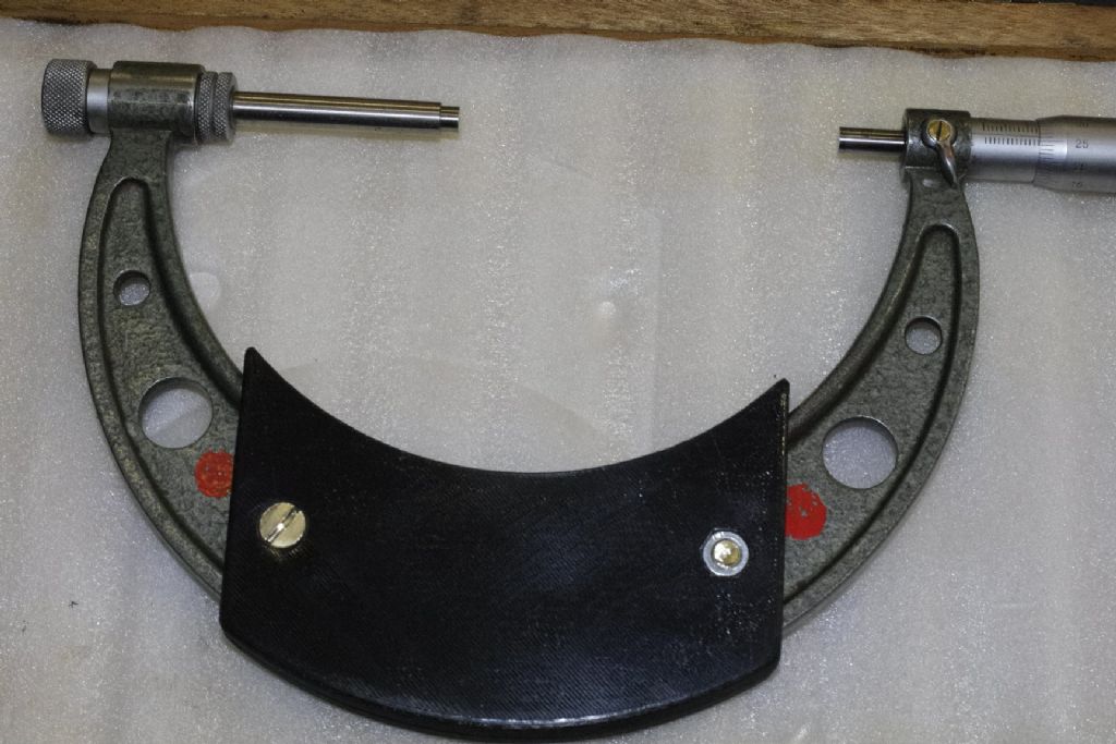

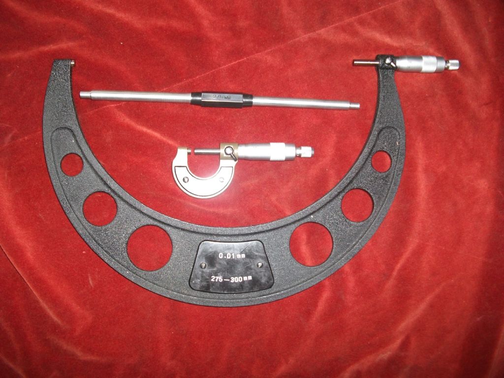

                                                _igp2489.jpg_igp2491.jpg_igp2490.jpg       It would be worth investing in a box of secondhand slip gauges, they have multiple uses, not just for calibrating micrometers.
                                                I bought this 0-150mm micrometer when it came up on ebay, to replace the 0-4" which was stolen from me some years ago. It came with a full set of length bars and the photos show the heat plate that Rod printed to fit it.
                                                Edited By old mart on 01/01/2021 15:44:29
