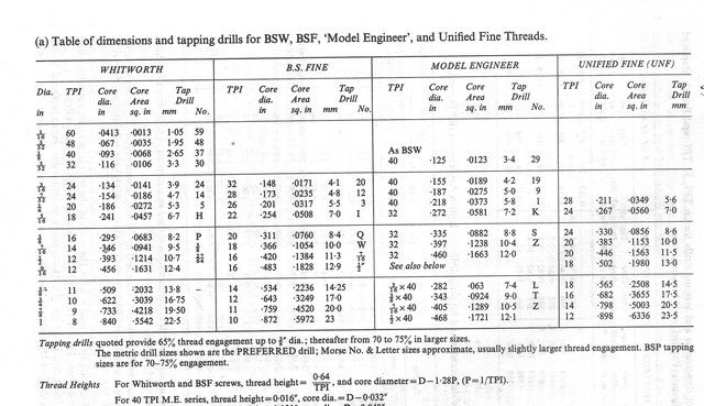

                        My Zeus book doesn't have ME threads per se, I suspect neither does the pocket ref booklet either from what I can see of it. I can scan a copy of my chart that has ME threads on it, if you pm me your e mail address.
                        Geo.
                        Scanned copy from Model Engineers Handbook by Tubal Cain; 2nd edition

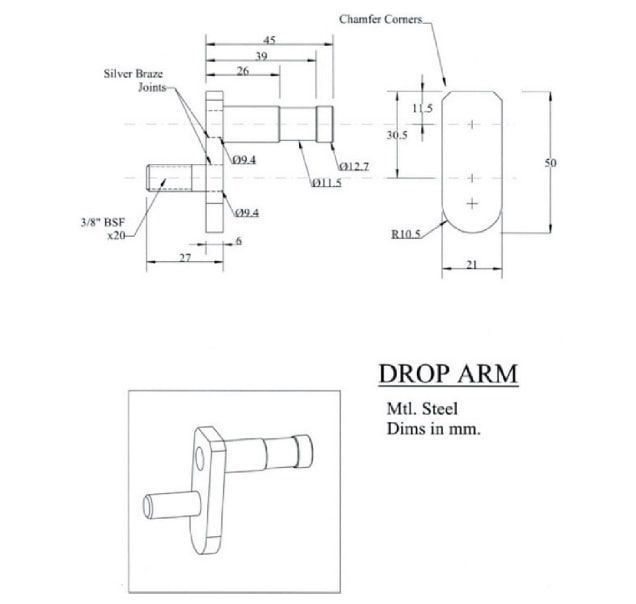

                                Hi David. I believe you will need to make a New thingy. (cannot remember what they are called.) to use the 33-34 gear set. I have a drawing of such an item. So hold on while i find it. Ok so it is called a drop arm & here is the drawing for it. Your welcome.
                                Steve.
                                #549537
                                David Couling
                                  @davidcouling56621
                                  Hi Steve, thank you for the info and the drawing; its the first I've heard that I needed to make/fit this drop arm, although I have the gears I haven't so far tried to fit them to the lathe, but I did have a quick look and saw the diameter of the T33 and T34 gears is somewhat larger than the existing 24T gear currently on the mandrel, and 'assumed' (shouldn't have done that) that the difference in diameter could be adjusted for on the quadrant clamp stud.
                                  Looks like a drop arm is my next project….
