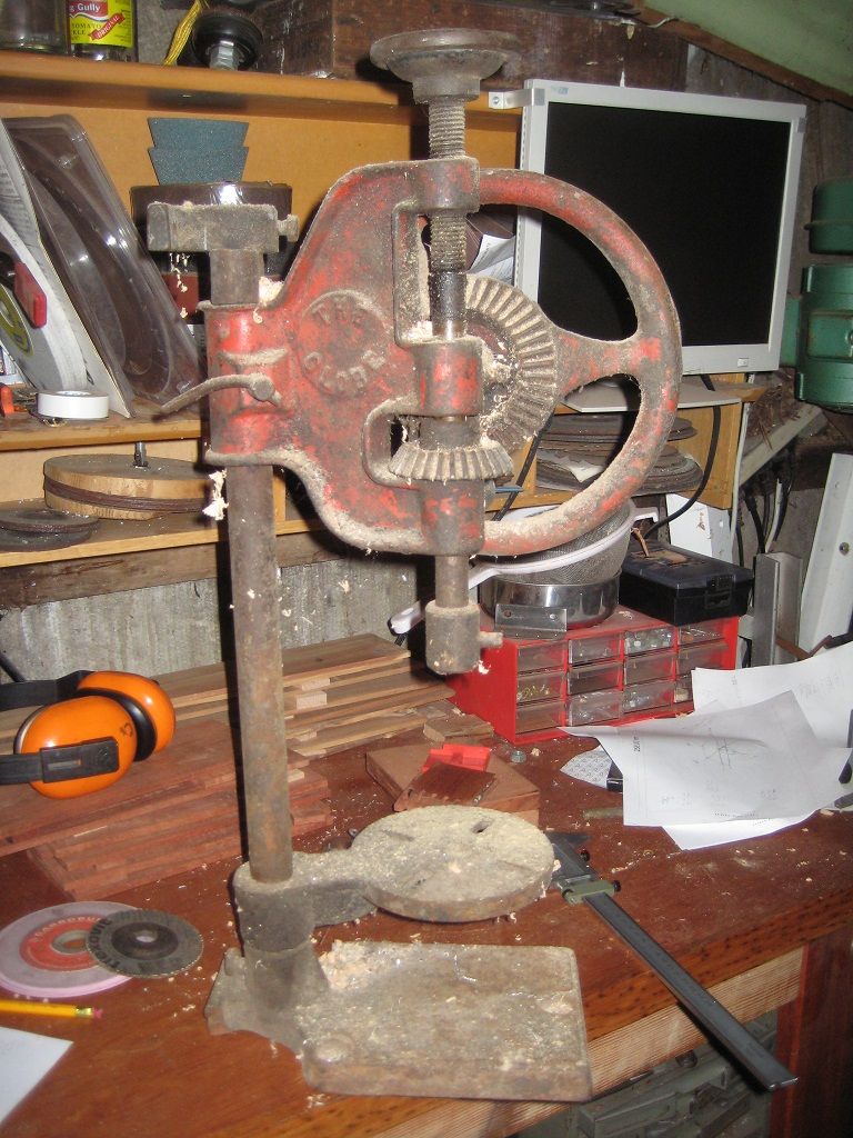

          Hi Steve
          If you are interested and want to pay the freight, I can let you have this one for about $40.00 AUD
          I bought it for my son to clean up and paint several years ago. Unfortuneatly he is not as interested as I thought and I am not either. I paid $60.00AUD for it.
          Weight is about 10KG
          Lawrie
          I should mention though that it has a chuck to take square shank drill bits and so would require the fitting of a three jaw chuck.

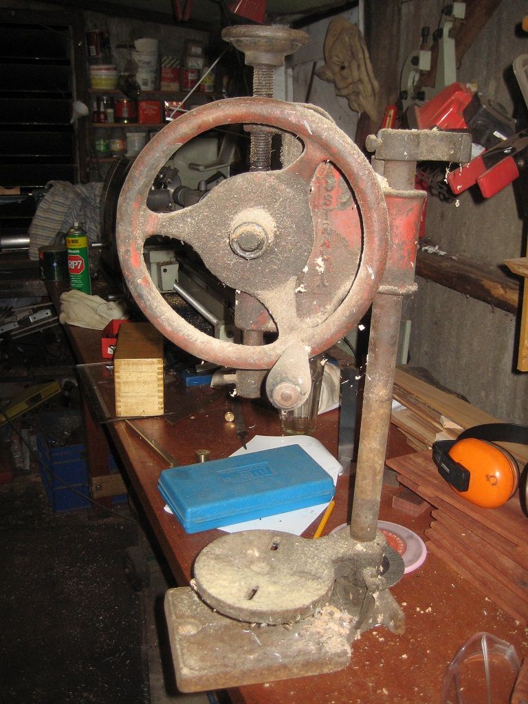

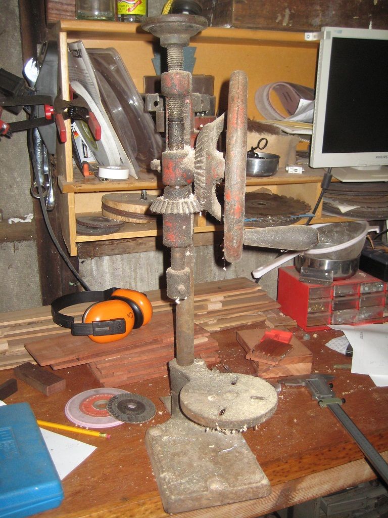

            Lawrie Alush-Jaggs
              @lawriealush-jaggs50843
              Hi Steve
              The pipe on which everything hangs is a peice of one inch water pipe. This machine ws designed to be shipped in bits and then assembled by the purchaser using whatever length of pipe he thought correct. So if you wanted it to drill something a metre long, all you have to do is change the peice of pipe.
              It is designed to be used either as a bench drill or can be mounted on a post as many were.
              There is no ratchet and pawl mechanism with this one and nothing is missing. The feed screw is a bit tight, as I said, I haven’t cleaned it up at all since purchase.
              the paint is about %45 but there is very little rust on it. Most of the gunk you can see is saw dust. I have just finished building a bed for my daughter and quite a lot of the workshop is still delightfully coated in dust.
              It does not autofeed. You turn the wheel with your right hand and adjust the feed wheel which is the round bit at the top. You get about 2 1/2 inches of feed.
              The whole thing can be taken apart quite easily though you may have to send off to the nineteen century for a spanner to fit the bolt heads.
              Yes, I am in Australia, Melbourne.
              Cleaning it up would take about half a day and several days of waiting for the paint to dry at which time you will have a handsome and functional vintage post mounted drill.

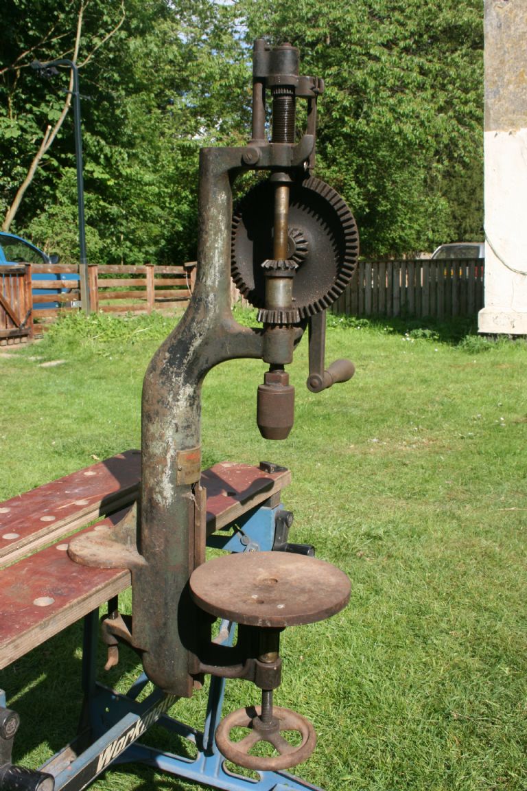

                  Hi Steve, I have dismantled my 2 speed auto drill this afternoon, and will clean all the parts in my small parts cleaner tomorrow and take some photos of them.

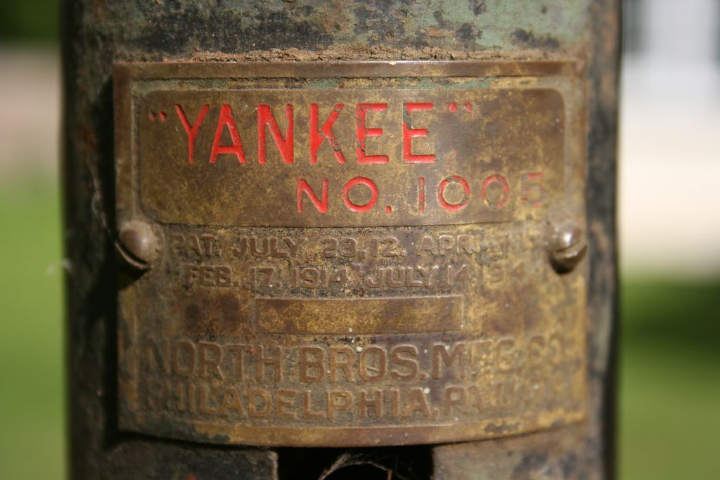

                  In the meantime I’ll tease you with a photo of another auto-feed drill that originated on the other side of our western lake, Philadelphia to be more precise.
                  I was given this one several years ago for doing a simple 5 minuite job.
                  One like this, in much the same condition sold on eBay in Illinois for $250 just a while ago. If you Google Yankee drill press 1005, you should be able to view it, it’s five or six down on the results page.

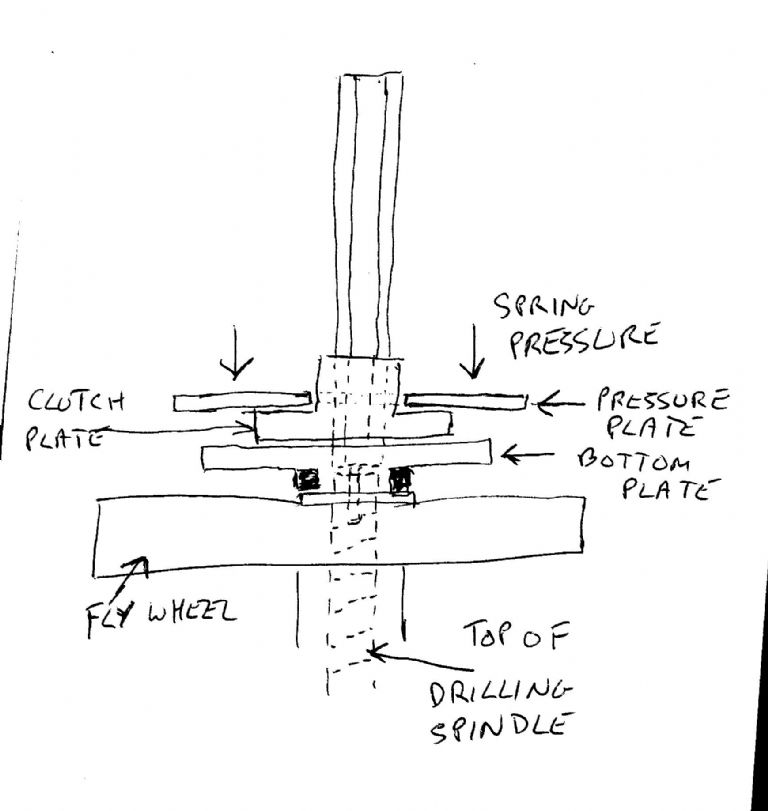

                      Hi Steve, I have uploaded photos of the drill head that I dismantled and cleaned yesterday. They are in the album called 2 Speed Auto Hand Drill. I have included a photo of E.J. Slzlumper’s design which I made for a drill of the same principle some years ago.
                      The drill spindle on this type of auto feed machine, is driven down onto the work, by the thread at the top of the drilling spindle, against a threaded portion inside the fly wheel shaft. The fly wheel remains stationary when there is no feedback pressure on the drilling spindle. Once the twist drill engages onto the work piece, feedback pressure increases the friction between the threaded portion of the drilling spindle and the thread inside the fly wheel shaft. This will start to rotate the fly wheel and most of the downward force on the drilling spindle is cancelled out. The amount of cancelling out can be reduced by increasing the pressure on the ball that acts on the fly wheel shaft by screwing in the pressure screw, thus increasing the amount of cut on the twist drill. If you stop the drilling action before completing the hole being drilled, the fly wheel will continue to rotate for a few revs, (depending on the amount of pressure on the adjusting screw) and lift the drilling spindle off the work piece.
                      One downside to this principle, is that the amount of friction on the threaded portion of the drilling spindle is not quite great enough to start the fly wheel rotating, and thus reducing the downward force on the drilling spindle when using the smaller twist drills and the result is that they break, this is what prompted E.J. Szlumper to come up with his design after reading letters in ME about others having this problem with this type of machine.
                      Regards Nick.

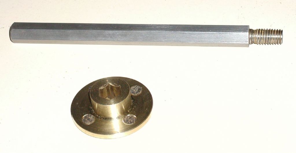

                          Hi Steve, apologies if I’ve confused you, but the hex rod is screwed into the top of the drilling spindle in place of the original stop screw, and travels down/up with it. This hex rod passes through a clutch plate, which is a sliding fit, the plate being driven by the hex rod. The cluch plate is nipped between the bottom plate which sits on top of the fly wheel boss with a distance piece to clear all protrusions and the top of the drilling spindle when in the fully up position, and the pressure plate which is what the spring is pressing onto.
                          Below is a photo of the hex rod and clutch plate, and a simple sketch of the assembly. The spring and adjusting screws/rods are omitted from the sketch. A hex rod was not specified in the original article, but was left to ones own choice, based on the author’s own construction due to the number of different styles of this type of drill.
                          Hope this is not to difficult to understand, as its only a quick rough and ready sketch.
                          Regards Nick.

                            Many thanks for more info of the complete design of this machine! I think I discovered the basic function. I was confused by the frictional drive but infact the spinning drill spindle is based on 2 different threads used. The drilling action turns clockwise while the thread above the spindle and the flywheel turns anti-clockwise. Hence it will push the sliding drill spindle down when it engages the thread whether the drill did touch the job or not. The free turns of the flywheel before and after the cranking stops is due to backlash of the course thread.
                            The pressure of the improved spring plate above is to cut done the backlash of the flywheel. Hence the feeding action is promoted by the torgue of the weight of the flywheel and feed rate control by the pressure nut. I think one of the pic you did not fasten the lock nut of the flywheel. I think is hard to offset the gears axis if I were to make one. I noticed the biggest bevel gears was custom-made with teeth tilted so it can take the smaller bevel gear below.

                              Hi Steve, I’m not sure that you have totally understood the action of the feed mechanism, as there is only the one thread on the drilling spindle that is engaged into the fly wheel at all times. When the fly wheel is rotating, it is in the same direction as the drilling spindle. The drilling spindle is only fed down when the fly wheel is not rotating, or is rotating at a slower speed than the drilling spindle. The slower the fly wheel turns, the greater the feed is on the drilling spindle. The fly wheel will continue to spin briefly after cranking stops, due to the inertia built up in it while in rotation.
                              Did you read the explanations below each picture in my album, the other thread that you may be mistaken to contribute to the feed mechanism, is probably the small stop screw in the top of the spindle with the left hand thread. This only stops the spindle from dropping out of the machine, and serves no other purpose.
                              The feed rate is controlled by the pressure screw by slowing the fly wheel down with respect to the drilling spindle. I did not put the lock nut and bottom bearing on the fly wheel, as I’ve only put it together loosely for the photo, as I will be repainting it before finally reassembling completely, with new pins to hold the gears in place on there own spindles.
                              Regards Nick.
