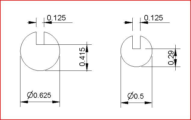

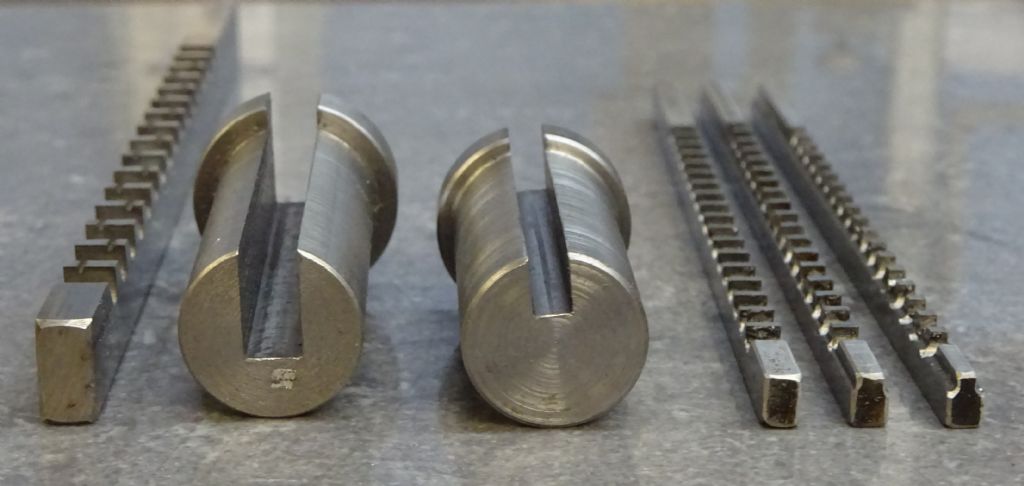

The A size fits bushes with a 1/8" slot which you will also be able to fit 1/16" and 3/32" broaches into.
The B size ones fit bushes with 3/16" slots so you will also be able to use 5/32" and 3/16" broaches in these
Basically its the width of the back of teh broach that determines if it is A, B or C and various numbers of shims are required for each combination of broach and bush
So the one you are looking at will cut 1/8" keyway, has a 3/16" (B) spine and requires a 1/8"B shim
I'll pop down to the workshop and take a photo in a while.
