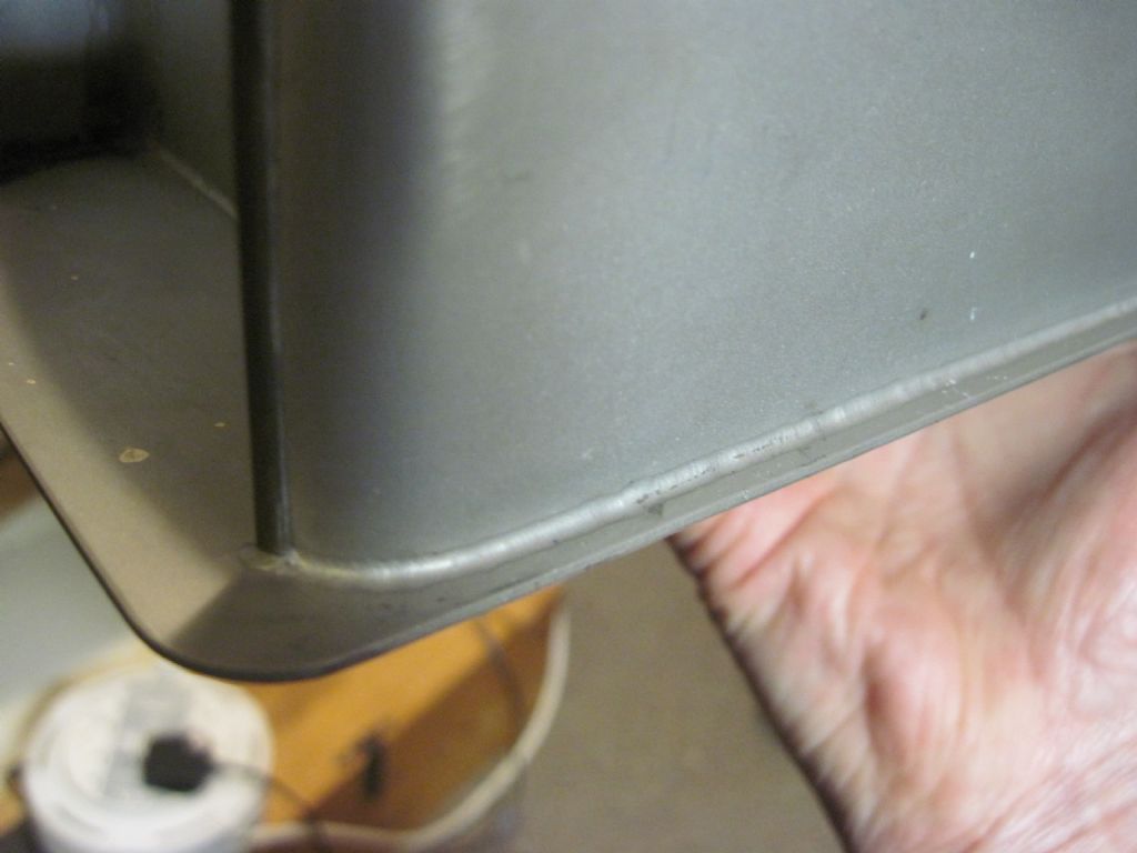

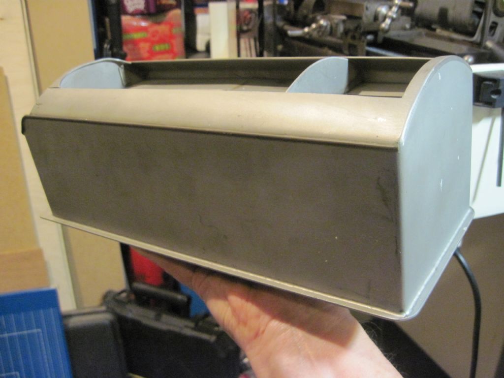

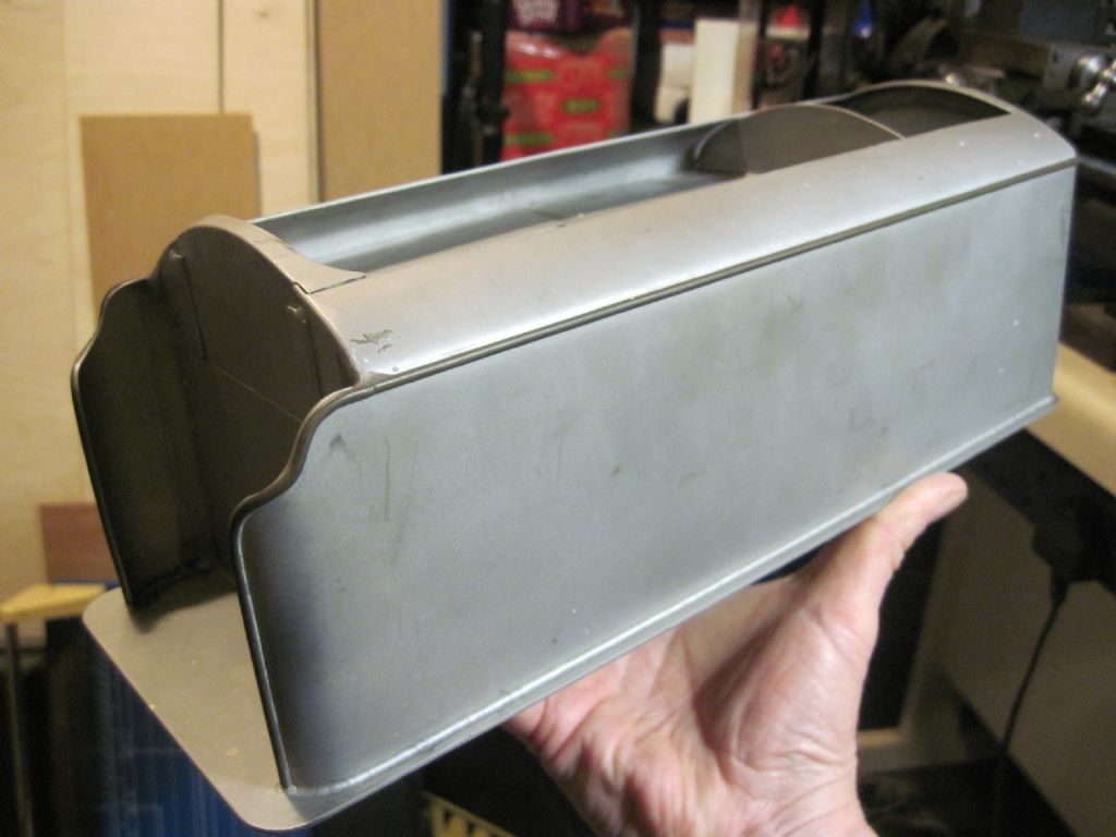

                                I have a stainless steel tender body that will go eventually with a Gauge '3' Pacific (A3) Howard.
                                It's very nicely made (not by myself I'm afraid) and I think it might have been TIG welded – although I'm not absolutely certain. It's a very nice job though, the joints are very even and smooth in appearance – and definitely not soft soldered.
                                If you are interested in a closer look, I'll take some photos of it for you.

                                #505375
                                IanT
                                  @iant
                                  OK – the Wife has gone to bed and I'm not going to watch any more coverage of the US Election tonight (that's for sure!) It's also too late to tidy up a worktop and I've got stuff all over the place, so just some quick shots.
                                  But I think you will get a general impression of the tender body from these pics Howard. Hope this helps.
                                  And that's Goodnight from me now too
                                  IanT
                                  A3 Tender Body rear
                                  A3 Tender Body front
                                  A3 Tender Body - Weld
