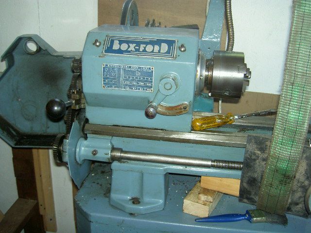

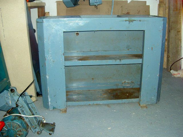

      Hi, I’m rebuilding an old Boxford lathe and want to paint it in it’s original colour (blue) but so far having trouble locating the right paint. I’ve attached photo of lathe showing what I think is the right colour, and would appreciate any help with this. Thanks.

          Hi Mike,
          I simply asked Boxford and got the answer for my lathe of 1950’s vintage as
          British standard 381C – 692 ‘Smoke Grey’ (see here)
          This is rather a bluey grey that looks more blue than grey in certain lights and in Photographs.  I think that your original colour is the same from looking at the base but couldn’t swear to it.
          I spoke to the guys at Boxford and they tell me that the paint they used was a cellulose one after filling the castings with body filler.  I have had the lathe for quite a while now and am hoping to refurbish it sometime in the future but need to get some paint mixed at a local dealer but it could be expensive depending on their minimum order.
          Here is a picture of my lathe (and it really is the original colour!):  Mail me if you need more information.

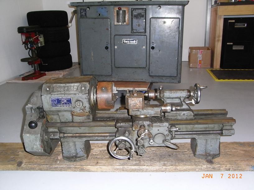

              I have just acquired a Boxford similar to yours, not sure of exact age or model, will have to research a bit. Before I locate it in my workshop I would like to clean it up and refurbish a bit. I came across your post by a Google search for Boxford paint colour and have obviously now subscribed to this forum. I have just ordered 500 ml of enamel machine paint using the colout code suggested, will see what it turns out like. Was an eBay purchase so I think the price was quite reasonable, I am hoping the paint type will be compatible with the original, time will tell
              In terms of refurbishment of head bearings, gear train and slides etc, I wondered if you could guide me to some relevant information that you may have already referenced in this or other forums.

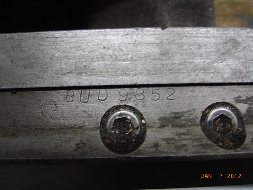

                    Early Boxfords were painted Smoke Grey BS 381 692. Companies such as Johnstone’s Paints (normal caveat) can make it up for you at little relative cost. You need to look up the serial number stamped on the RH end of the bed to confirm the manufacture date, Look up here

                          I just had to got out to the garage and look, here’s what I found:
                          And this is what I’ve got to play with :

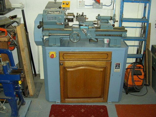

                              I would agree with the other comments re the yahoo site. I’m still collecting bits and pieces for the lathe to make life easier. I converted it to thyristor drive, thus giving me variable speeds, and easier than changing belts also fitted an emergency stop. I’ve attached some pics of the lathe as it is at momement.

                                Bl**dy hell, Mike!
                                Wooden cabinets? Carpets? Spotlessly clean surfaces?…
                                So where’s the microwave and cooker hood?
                                I’m only jealous

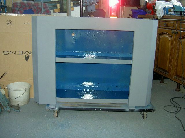

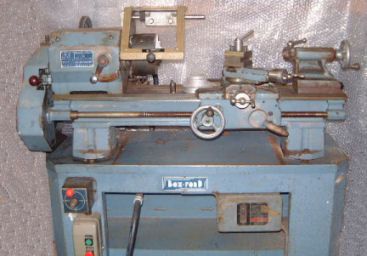

                                  It’s looking very good, My csb which was caught up in a fire is awaiting attention and I’m just repainting a late model CUD but adding a powered cross feed so it really is now a BUD. I’ll add some pictures when I can but I can’t guarantee any wooden doors. Well done so far, I’m jealous too

                                    Funny you should mention cooker hood, I re-fitted our kitchen for the “management” and used most of the cabinets and worktops to fit out my workshop, there is a cooker hood with an extract fan in it, I’m sure it will come in handy one day. The reason for the door on the lathe stand is because there is quite a large dent in the front, above the internal shelves of stand (which I could’nt pull out) and the door was a perfect fit. As for a microwave I’m arranging for a meals on wheels delivery service with (you’ve guessed it) the “management”.
