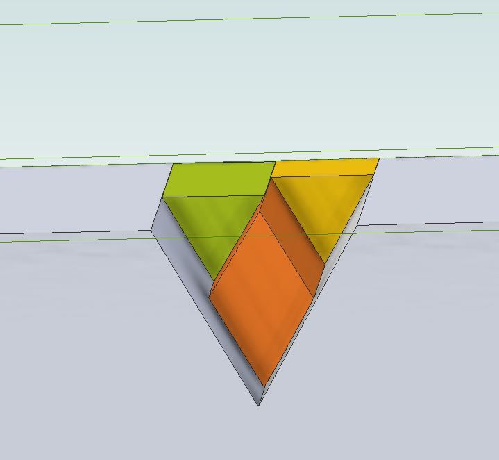

                                  It is not so much the power of the motor that is the issue it is the forces going through the drive train and leadscrew if you power the spindle either by hand or with a mandrel handle which increase as the gearing up increases.
                                  If you further want to reduce the cutting load then the topslide can be set parallel to the lathe axis and a quick bit of cad or back of the envelope maths will have it done with no more load than if cutting a 1.75mm pitch thread (14tpi) Cut the yellow bit first, advance topslide 1.75mm and cut the green then retract topslide 0.875 and remove the orange. As OP has a tap that can be used as a final chaser.
                                  Drive the leadscrew and you can get very large pitches which would be so scary even on the slowest backgear of a Myford as the carriage will be moving at one hell of a rate. A better handle would help as the allen key shown is not ideal
                                  Edited By JasonB on 24/11/2021 18:31:29

                                    I wouldn't be too worried about overheating, the thread is fairly short and the cutting period won't be long. 3.5mm is a coarse thread, but if you work things right the cutting edge will only be about 2mm, well within the lathe's capabilities, even in steel. In aluminium, it should be a doddle.
                                    Use the in two units/across one unit method of infeed and you will only be making a significant cut on half the thread width. No need to angle the topslide.
                                    The lathe is still in storage, so I don't have the change gears to check, but I would be surprised if 3.5 can't be achieved.
                                    The biggest issue is that the carriage will move pretty fast, but with a through thread you have plenty of runout.
