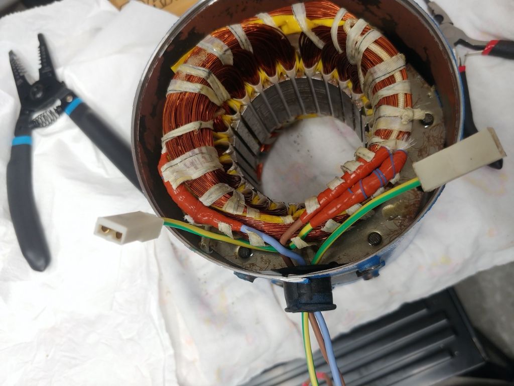

      That's my feeling Gene. Just a guess, but compared with the rest of the motor's wiring, that joint is exposed. Looks like it was soldered, so maybe you have a wire nicked when cut, then baked in flux, left in tension, and open to slow oxidisation for 20 years in storage. No problem passing inspection when new, but time worked on the flaw until it broke. Maybe if the motor had been used heat would have stopped the corrosion. Or maybe vibration would have broken the joint within months and the grinder would have been a warranty failure. We shall never know.

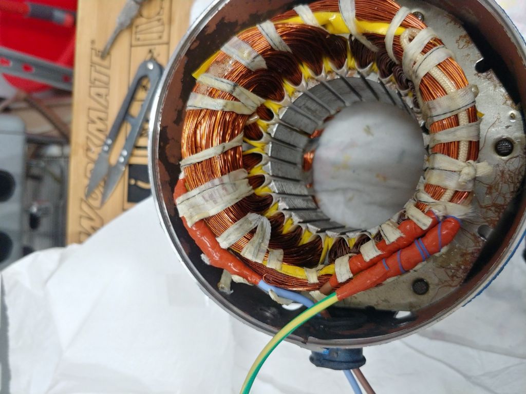

          The connection of the green wire (the other end of the start wiring) also looks somewhat oxidized (as did the black wiring going to the main winding). Should I inspect the red (actually pink) wire connections? Should I resolder all the oxidized-looking connections to improve future reliability?

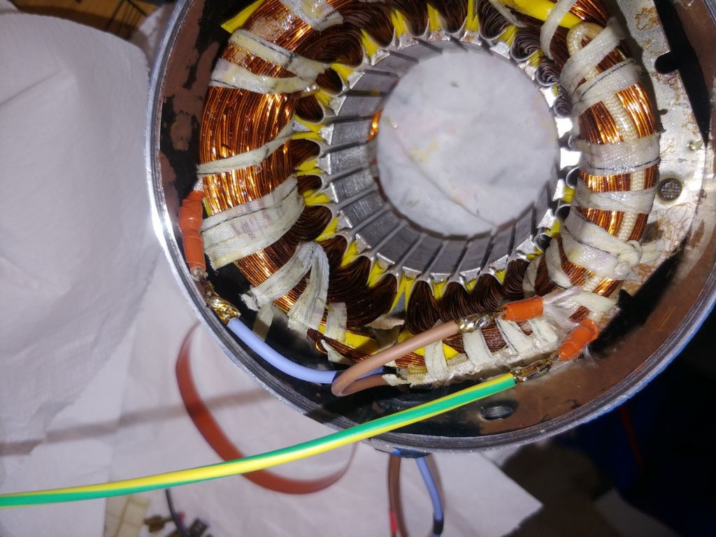

                        In the end I decided to replace all the wiring, as all of the joints looked somewhat oxidized and not that well made.
                        I've bought a length of SIHF-J 3G1.5 cable (180C-rated silicone insulation) and used the individual wires to replace the old ones. I decided against heat-shrink and instead used self-fusing F4 silicone tape which I had.
                        I used high-temp sensor-safe (supposedly neutral cure, although it did smell similar to the regular acetic cure one) automotive RTV silicone sealant, and then some thick-ish polyester thread to tie things up (hopefully it won't cause problems later).

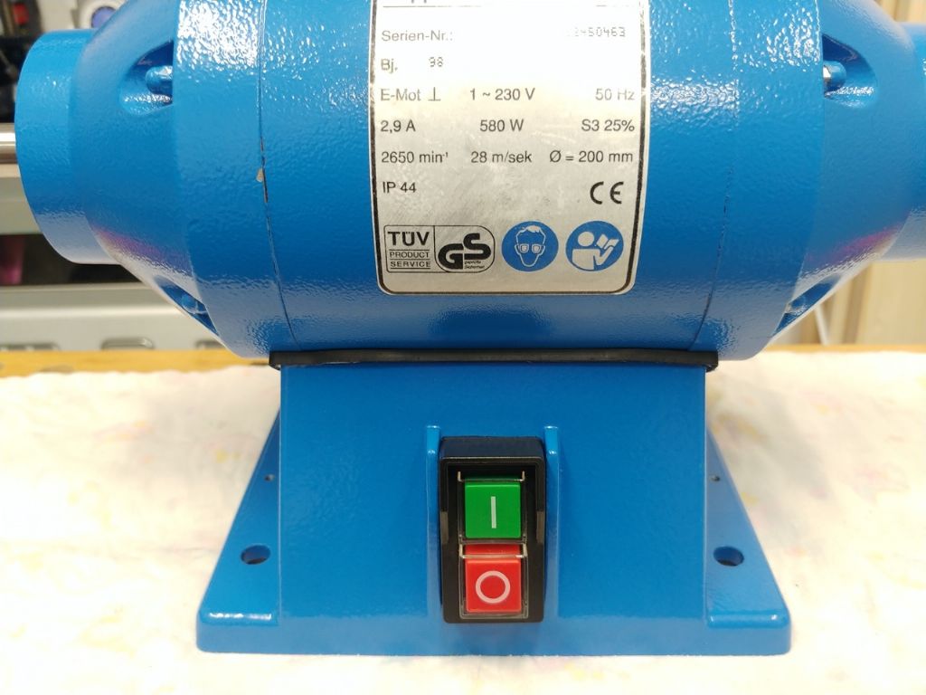

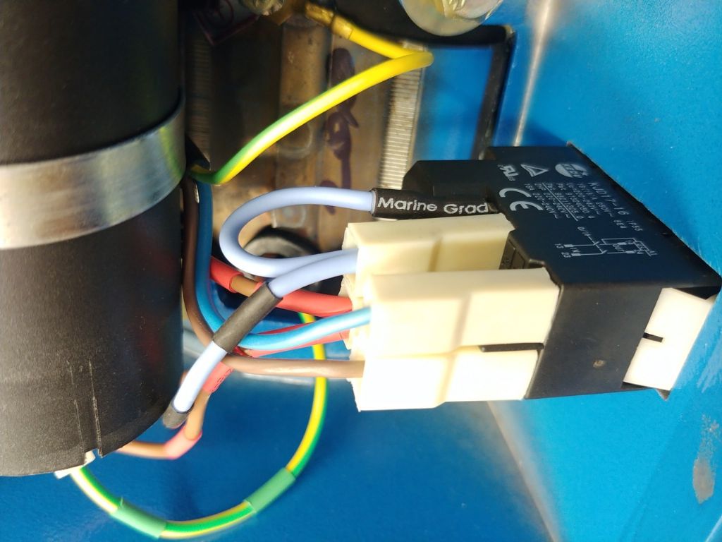

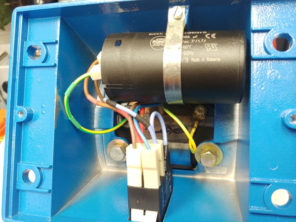

                        While I was at it, I replaced the power switch with an electromagnetic switch (KJD17).
                        I didn't have the time to put the grinding wheels back on, but it starts and runs (and stops) fine now! I can hear the centrifugal switch during start and stop, it sounds different from what I imagined (from reading it described as clicking), but now I know how it should sound like
