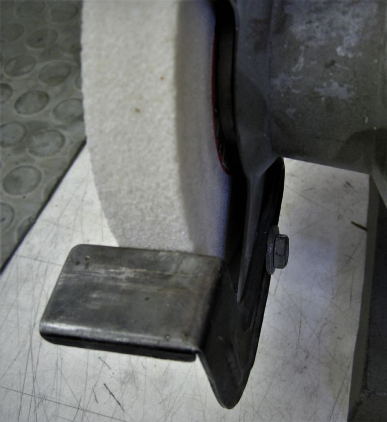

      Of course we all know the crappy pressed sheet metal rests these grinder come with – well, I lived with those for the grinders 30 year life..I took one wheel off – impossible to try true the wheel with both vibrating the grinder apart!
      The vibration was still so bad, that when I tried to hold the diamond dresser still against the 'rest' trying to just touch the wheel and keep it steady, it was impossible. The rest was vibrating to its own tune, and the wheel was being dressed to some strange standing wave shape!

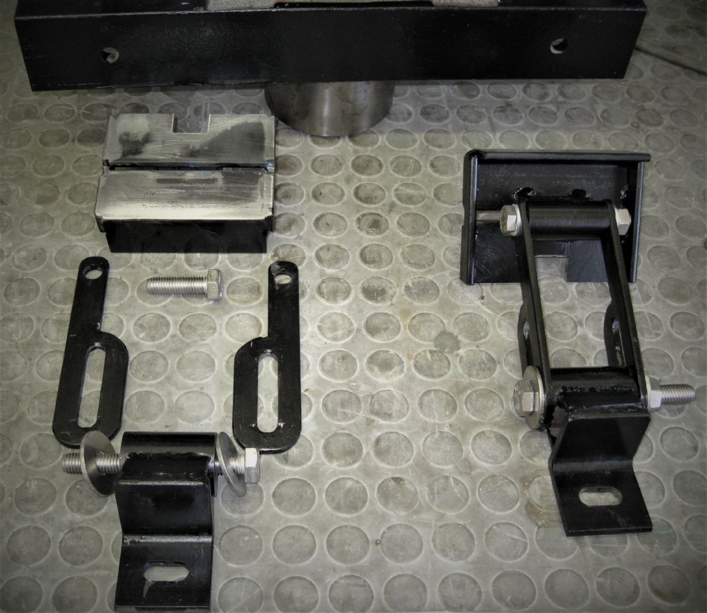

      Which I did, new swivel stand, new rests made from 5mm flat plate, angle, some 30mm and 25mm shafting, bolted the whole thing to the wall, and finally manage to dress the wheels to flat and true!

      The lousy pressed 1.2mm factory rests…
      New parts for the left and rights rests

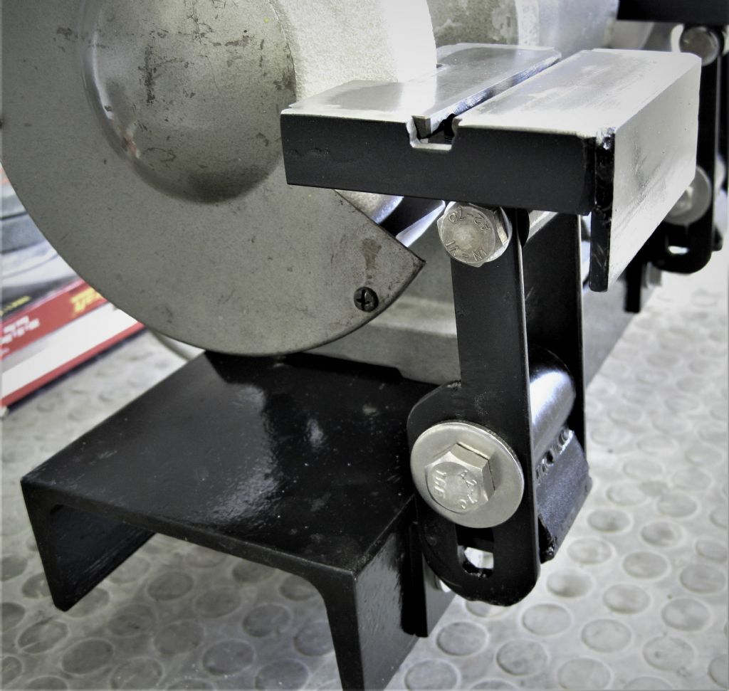

      Base is a 140mmx50mmx10mm channel iron.Picture show adjustable left rest in place. Rest base plate has a 6mm slot in it – Will make some guide for simply face grinding of lathe tools maybe..
      And there it is , bolted to the wall!
      The rests can tilt to any angle, and be raised or lowered.

                              I bought a cheap bench grinder a few years ago. First thing I did was bolt it down otherwise I would be chasing it around the workshop! That done it would then shake whatever was on the bench onto the floor! The principle cause of vibration was the wheels, out of true both radially and axially. I had two old lathe top slides of fixed together and clamped to the bench, with a diamond I was then able to true the wheels. Not perfect but usable. I used this awful quality grinder with an equally awful drill grinding attachment as my main means of drill sharpening for many years with much better results than the awfulness of the equipment might suggest.
                              One suggestion I would make regarding the nice looking work rests, make something that will stop the rests digging/tipping into the wheels should the fastenings loosen, (assuming it has not been done). I have witnessed two bad workshop accidents in my employment, one was as described on a large offhand grinder.
