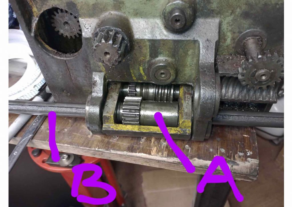

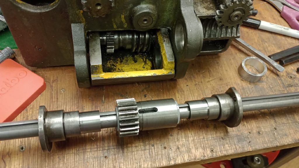

      Hi I have just aquired a Bantam 1600 (AA 3061) and am trying to fix the lack of carrige drive and cross feed .
      I have removed the apron and the gearbox ,although showing its age, does work.

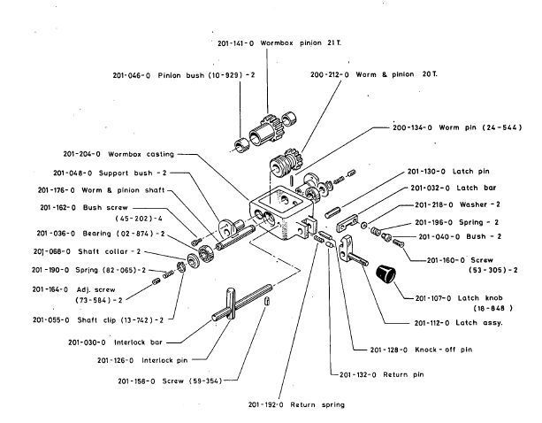

      Everything engages as it should except for the wormdrive pinion (labeled A in photo, and part 201-141 in diagram ). I cannot see how it was supposed to engage with the drive shaft (labeled B) inside it is smooth with no sign of a missing key , and the diagram does not show a key so if anyone knows how this was supposed to work I would be really grateful for some help . thanks , mike

        power shaft not driving wormdrive pinion

          I don't know the Bantam well enough to be definitive but I cannot think of any other feed shaft drive, with a keyway slot machined down it, that doesn't engage with a key within the pinion to provide carriage and cross feed drives.
          Regards Brian
          #625663
          Howard Lewis
            @howardlewis46836
            Can only echo what Brian says.
            The power shaft, runnjing through the pinion has a keyway, implying that there will be a key to carry the drive from the shaft onto the pinion..
            My inclination would be to strip the pinion off the shaft and out of the Apron, again, and examine very carefully for the remains of a key that has been sheared off, and to extricate the remains. If this is the case, there should be the other remains of the key still in the keyway of the shaft
            If the bore of the pinion IS actually devoid of a key way, to ensure a drive, you have the task of making a keyway, either by cutting bone (With a slotting tool, racking the Saddle to and from with a suitable tool in the toolpost,, broaching, or filing ) and then making a key that is good, snug,fit in the pinion, and a sliding fit in the shaft keyway..
            It will need to be prevented from coming out of the pinion, possibly by a washer at each end, or secures by drilling a tapping the key in the pinion to lock it in place..
            (Can't see how it would be possible to cut a slot in the pinion bore for a Woodruff key )
            Am alternative, but less satisfactory method would be to drill and tap the pinion for a number of grubscrewws which would substitute for a key.
            Non preferred since the drive would be taken on several cylindrical faces rather that the one continuous linear one.of a proper key.
            HTH
            Howard

              What is shown in the parts drawing for the feed shaft? that may show the key.

              Baz
                @baz89810
                No point in making a shaft with a keyway all the way along it unless it drives something so the bit it drives must have a key somewhere. Long time since I took the apron off mine so I cannot be sure but would the key be cut integral with the pinion bush, pretty sure if it was a separate key it would be shown, one thing about Colchester’s is that their manuals and exploded diagrams were good. Not the end of the world though, it should be easy enough to cut or broach a keyway through if you have to, I would imagine the bits are soft.

                  Mike
                  Colchester call the drive shaft a spline shaft so its possible that the pinion was driven via a "single tooth spline" broached into the bore to stand proud of the support bushes. Easier to assemble than a loose key but vulnerable to shearing off causing loss of drive.

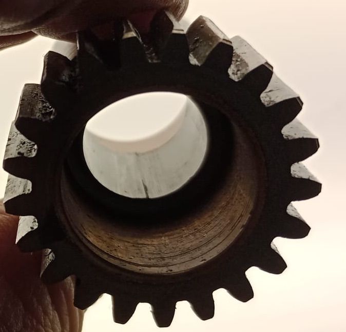

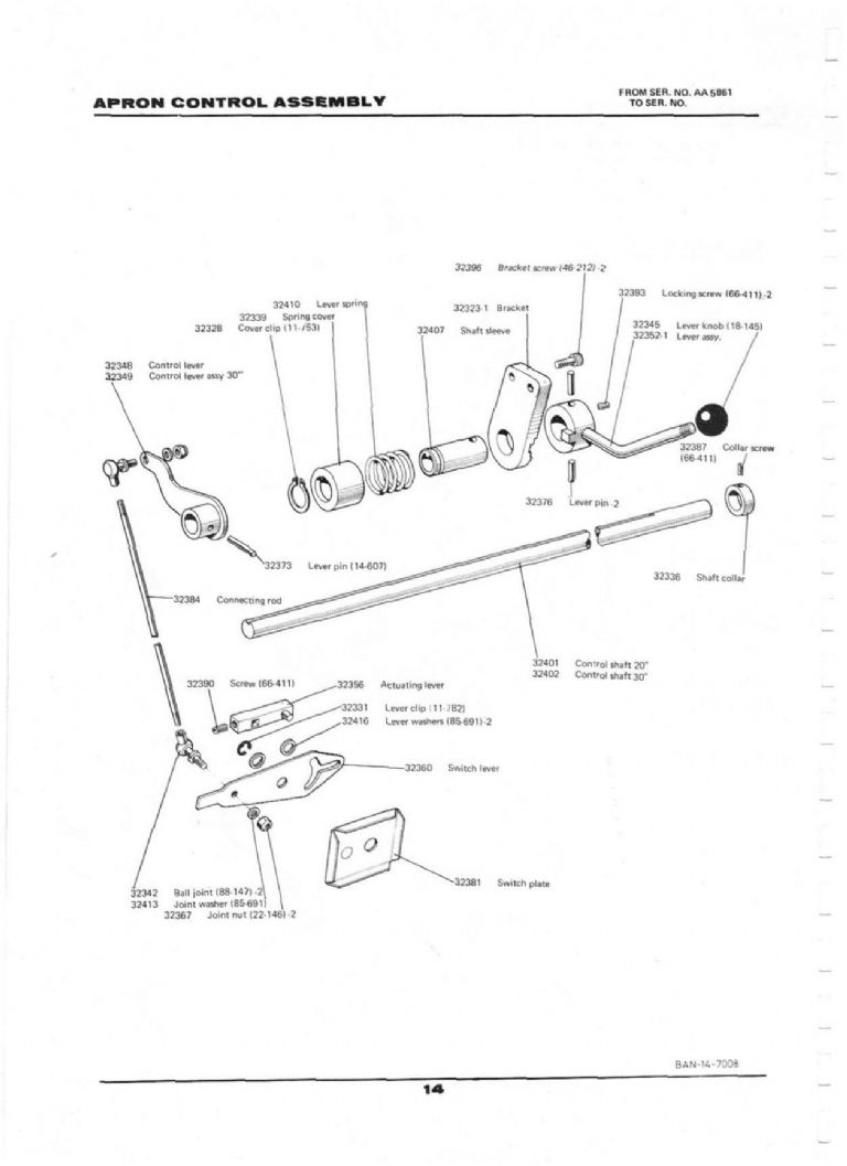

                    Yep , I think mystery solved , I think you guys are right .
                    the key has worn away completly , and not shown in the drawing because of the angle , but can see in the forward /reverse handle diagram a key in the sleeve

                          The Colchester lathe drive pinion and the on off lever dont have a separate key the bore of the pinion and the on off lever are broached to form the bore and key all in one piece if that makes sense so no separate key and they will wear away completely in time but they can be fixed by milling a slot through and fitting a key from the rear if that makes sense and tig weld in place, this is the same with all Colchester lathes, if you can pick up a spare worn item and fix it prior to yours wearing out, great as a spare because they always give up when you need them most. Good luck!

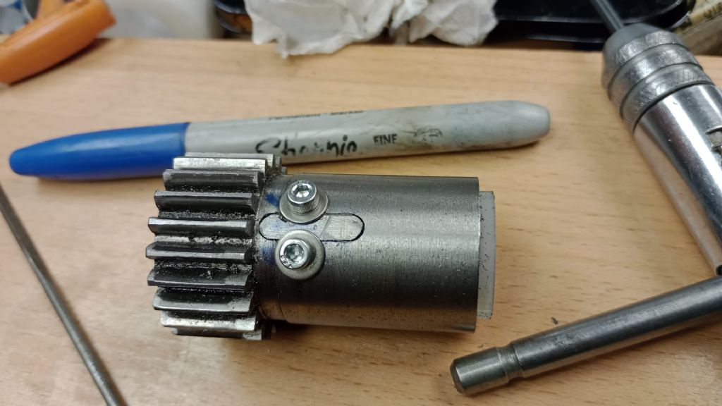

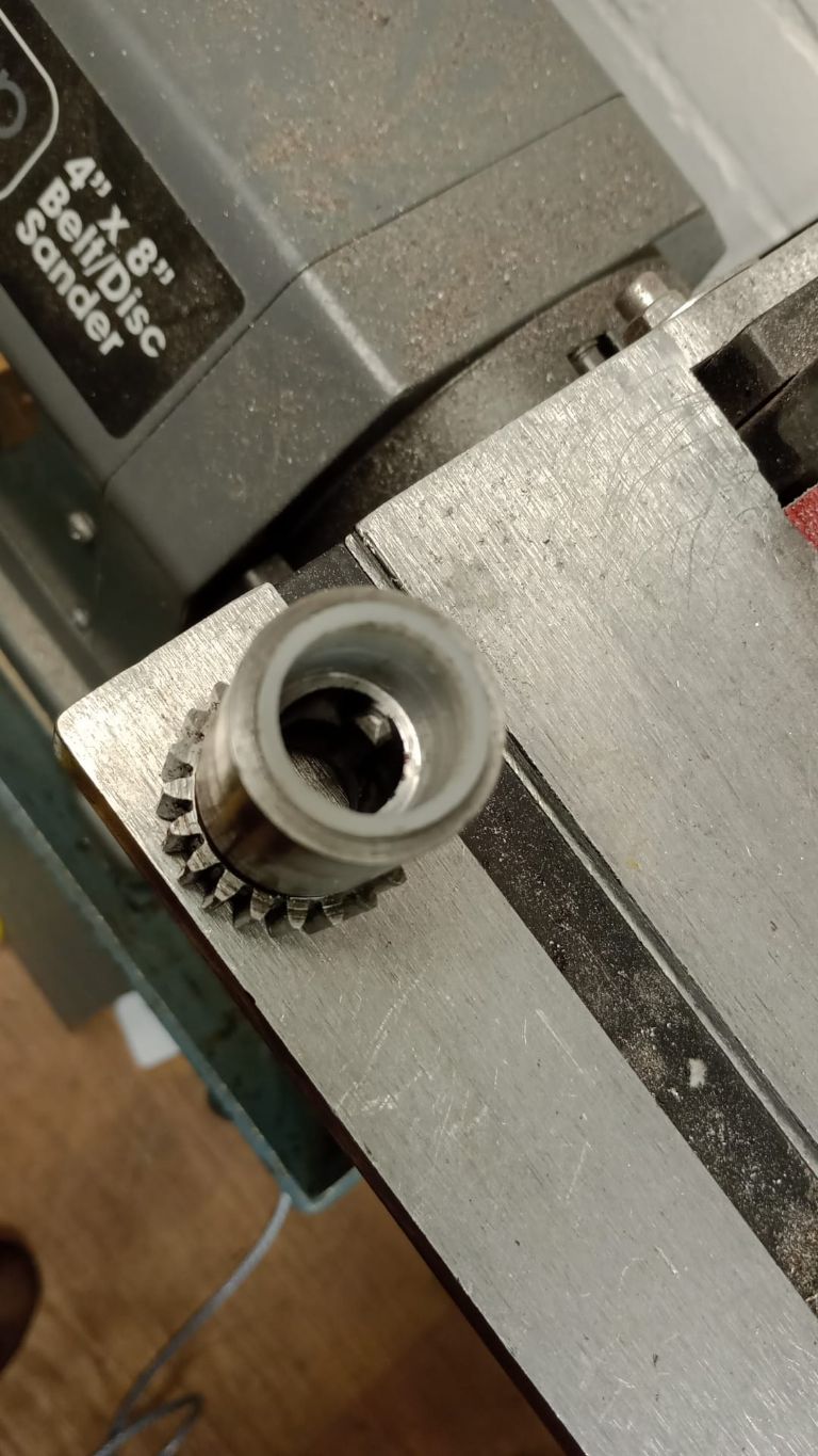

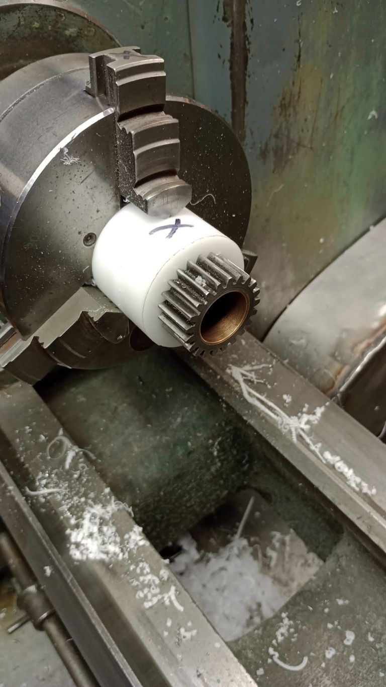

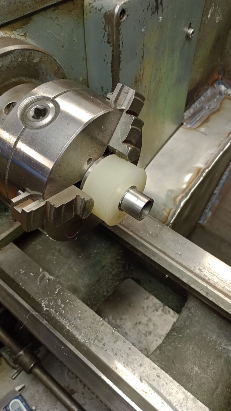

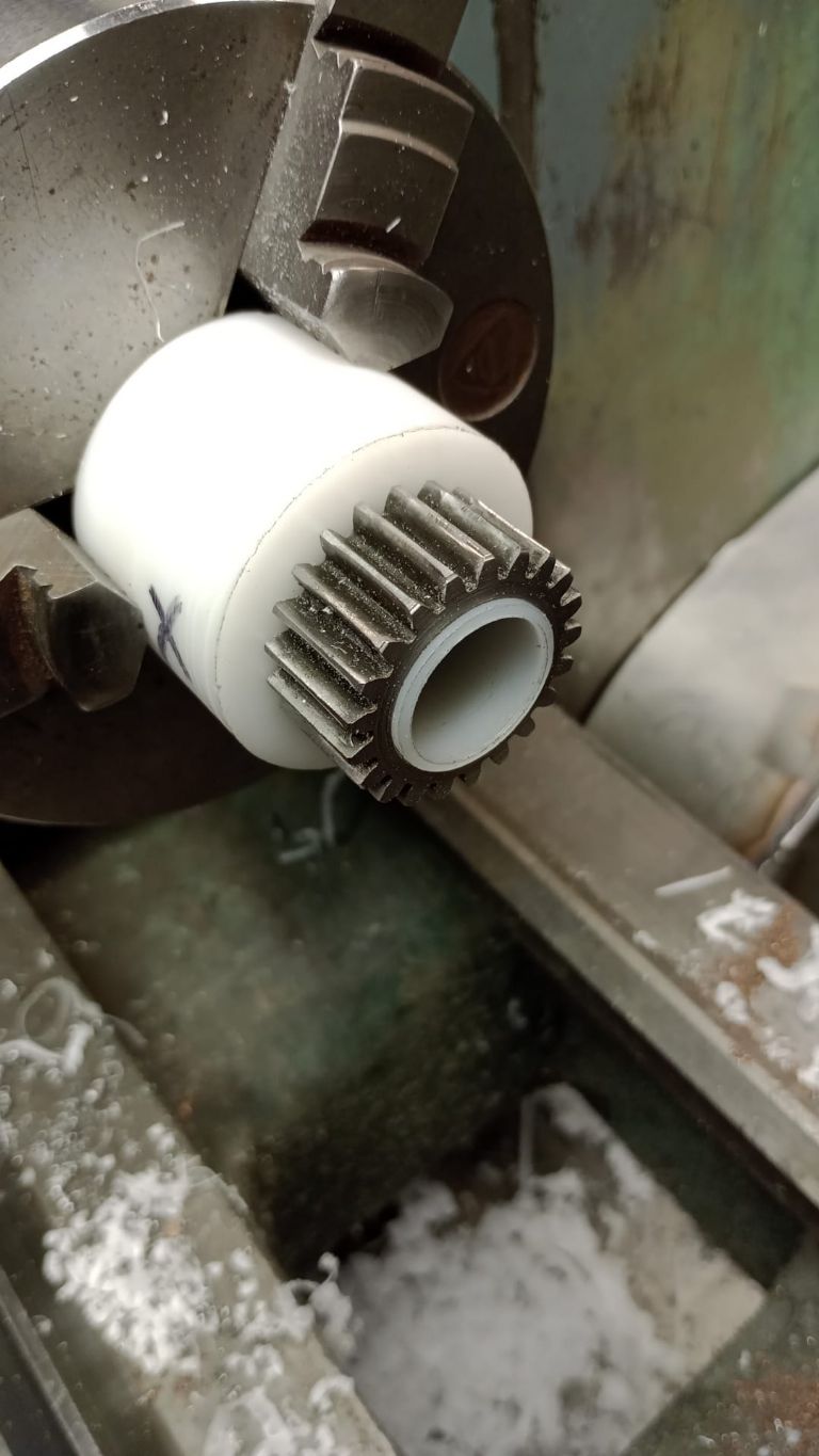

                                      Here's an update on repair progress
                                      I bored out some nylon to hold the pinion while i carefully bored out original brass bushes , stopping when wafer thin and peeling out last bit , then hammered in some 24mm nylon66 and bored that to match the cleaned up support bushes.
                                      Then slotted pinion 3/16 to match spline in drive shaft , shaped and hammered in new key .
                                      I have ordered oilite bushes to replace nylon and will put tiny TIG welds to replace retaining bolts at that point
                                      the drive shaft needed minimal filing in a few spots to clean up , and its all running really well now
                                      when that key wears out I can extract and replace
                                      thanks again for all advice
                                      removing old brass pinion bush
                                      temporary nylon66 bush
                                      Making support bush true
                                      slotted pinion
                                      new key view
                                      new key temporary bolts

                                        Nicely done Mike. It'll be a while before you wear out that steel key

                                          A most ingenious solution and one to remember for other similar drive key problems if we are allowed to use the idea. Thank you for telling us how you went about it—I especially like your planning ahead for the next time it needs doing!
