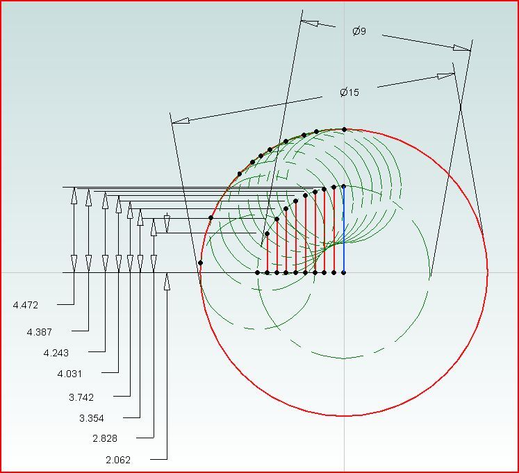

      Trying to purchase 15mm (£40) ball nose milling cutters and 22mm (£70) or 78 can only find one site with these but they are very expensive and wouldn't justify the outlay for something you are only going to use occasionally. My biggest collet is 20mm, I was using these for making farming wheels for pipe benders. I am using them for cutting aluminium.
      Thanks in advance for any information you may be able to provide me with.

                      How about turning the recess in the quadrant by making a template with a 15mm recess in it and fixing it at centre height in place of your fixed steady. Now make a follower the same shape as your lathe tool fixed in the right hand position of your toolpost. This now limit your lathe tool position to that require. Mount the quadrant on your face plate. Should work but will be a be clunky.

                        Set the wheel on the Rotary table mounted vertically, use the boring head set to size to first drop down to ctr height and then rotate the work. If you advance the work in in several stages you won't be taking a lot off per cut and no need to buy 15 & 22mm cutters.
                        For teh 15mm you could probably do that on teh lathe with a form tool that is slightly smaller so you are not cutting over the whole width of teh tool, just offer up a bit of pipe to test the fit. I did this one a month or so ago from some scrap brass to bend 1/2" stainless
