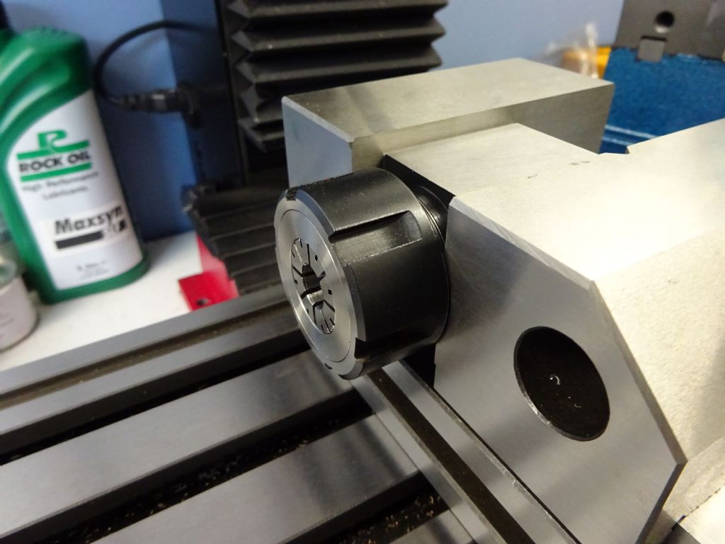

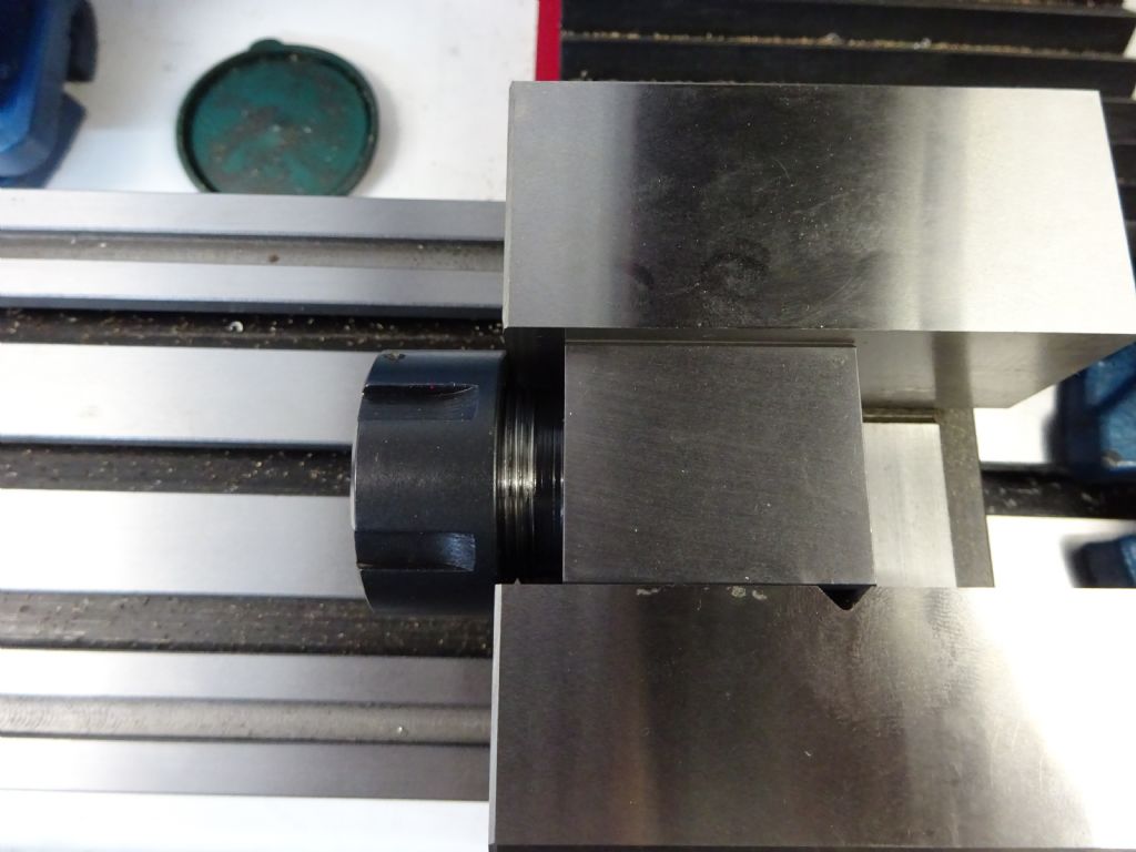

                      #323480
                        Posted by Andrew Johnston on 25/10/2017 10:53:50:
                        I have square and hexagonal blocks for 5C collets. I don't use them much as they have two issues. One I find it difficult to get the work tight enough so it doesn't move under cutting forces. Second, when you rotate the block you lose X-axis reference, which is a right PITA if you're trying to mill a sqaure or hexagon. It may well be that the ER versions would solve the first problem, but not the second.
                        Vice depth stop OR push the ER block back until the closing nut contacts the vice jaws for consistent location.
