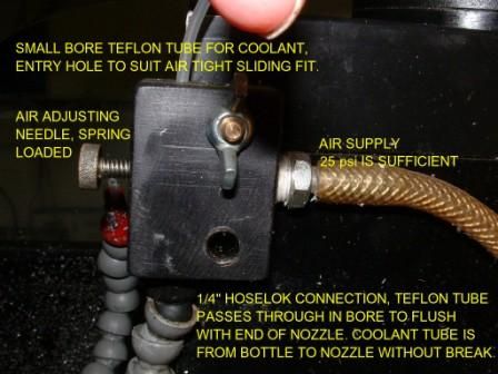

                                I use a home made mist block, more small droplets than mist but can be directed exactly where needed, it does need a low pressure/quantity air supply to function. Full details in my Picture album, the following link shows the block with a description.
                                http://www.model-engineer.co.uk/wp-content/uploads/sites/4/images/member_albums/87760/581408.jpg
                                Similar type units are now very low cost (£5-£8) inc postage from ebay sellers.

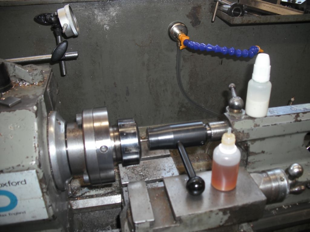

                                        I use the little bottles vaping fluid comes in as shown here one with neat cutting fluid other with "suds"image00001.jpg
