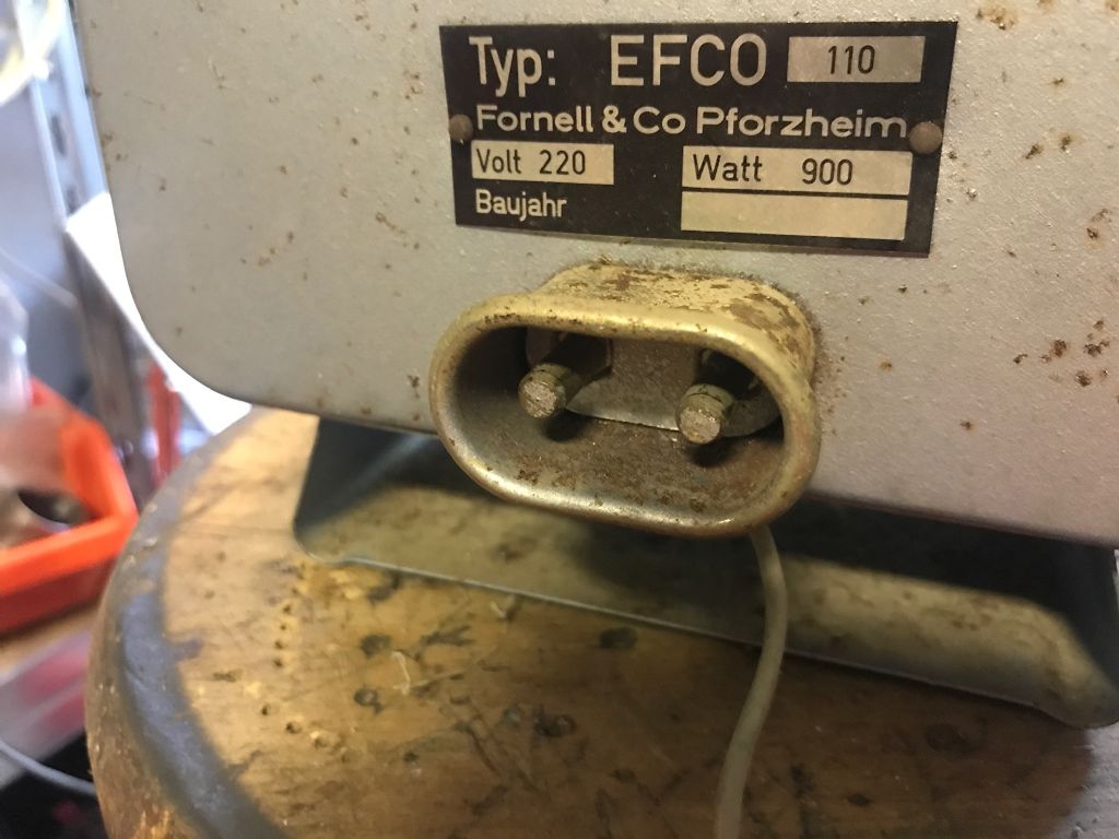

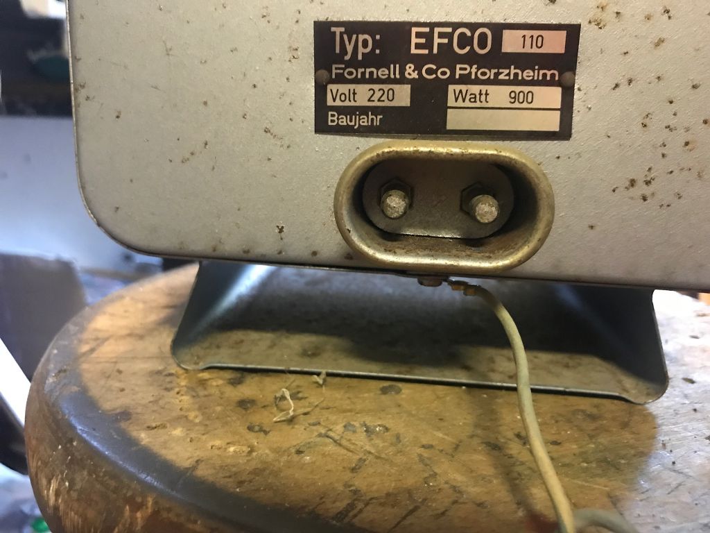

      hi all,
      i bought this little furnace for what I consider to be a bargain 15€ but I don’t know what the connector is…
      the furnace was bought in France, apparently of German manufacture and helpfully, the date stamp is missing but I guess its 70s unless anyone knows better.

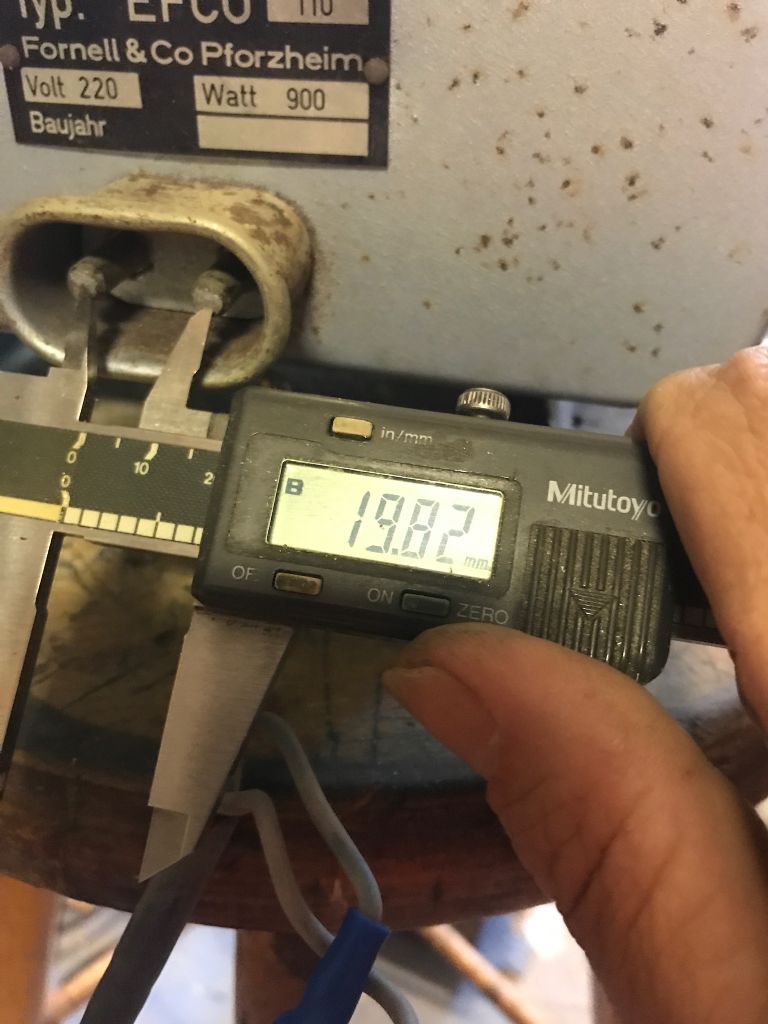

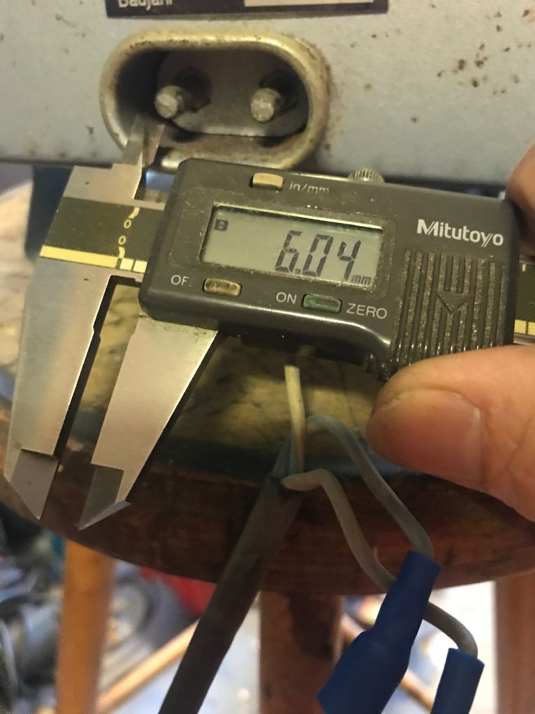

      Pins are 6mm diameter and roughly 20mm apart
      Connected it up with a botch job to confit works, need to do so more safely now.
      As ever, the aid from fellow model engineers is very welcome. Simon

        And where can I get the mating connector

          Looks similar size to the very old type kettle connectors that were 2 pole with scraper earth, probably not any around these days.
          It may be better to fit a permanent cable to the furnace via a gland and fitted 13A plug with fusing to suit.

            +1 for old style kettle and coffee maker type equipment. Unless you really want to keep it original I would go with Emgee and hard wire it or fit a modern euro style connector, be aware there is a hot condition version with an extra notch for kettles but the regular version is rated at 6A which would be ok for the 900W load you have.

                    Not much help to you I'm afraid but I have an Efco oven like that. The connector is made of porcelain to withstand the heat. it has a simmerstat in the lead as a temperature control.
                    There is no access to the other side of oven connector so
                    replacing it as some suggest s not an option.

                      looks like the Efco 110 is still a current model.
                      **LINK**
                      The design may have changed, but you may be able to get some assistance from the manufacturer

                        Further info, there is an image here, confirming it is a ceramic connector.
                        **LINK**
                        You also need an external temperature controller

                                  this German supplier still makes these plugs, there is a silicon version to stand 200°C. They are linked to at the bottom of Michaels link.

                                    The plugs are still available and used widely in industrial heating applications. Typically on injection moulding machines and plastic blown film lines, but also on any item where things get hot. Try R.S. or google industrial heating element suppliers. They are normally two piece ceramic with the brass or plated socket pins sandwiched between the two halves and with a stainless or aluminium shell. Though some can be found made of a temperature resistant plastic/ fibrous material instead of the ceramic. They are available in male and female forms though the female is most common. I have found old versions of these made with imperial pins 1/4" but your furnace obviously has the metric pins. Normally silicone sheathed heat resistant cable is used with these plugs and in some cases glass coated high temperature wire. The silicone stuff is good for maybe 250 degrees C and the glass covered wire can easily stand 800 / 900 degrees C. Important if you accidentally drop some hot metal on it.
                                    All the plugs I have seen are rated at 250 volts,

                                      While it may physically fit the two pins it will not have the earth connection to the body of the oven connector, so not recommended.

                                        Thank you everybody for your input and comments:
                                        @engine builder, @stuart bridger, thanks for confirming its a ceramic connector
                                        @Michael, I cannot believe that you managed to find such a site – geeks of the world unite! (on a side note, we have visited a museum of combs and a museum of the corkscrew down here – the comb one was good, the corkscrew one not really)
                                        @Robert Dobbs, great, thats the one!
                                        @Mike Poole, @Max tolerence, also great, I will follow up

                                            Google DIN 49 491 and see if a local supplier comes up.
                                            EDIT Don't forget to give those pins a good clean before you plug you new connector in even for a trial.
