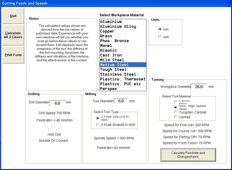

                                        #440105
                                        Versaboss
                                          @versaboss
                                          Just to show what's going wrong: here a picture of the limits and fits button.
                                          Oh the troubles, when the .jpg is too big, nothing happens.
                                          Kind regards,
                                          Hans
                                          Edited By Versaboss on 03/12/2019 22:18:55
                                          Edited By Versaboss on 03/12/2019 22:20:30
                                          #440130
                                          Thor 🇳🇴
                                            @thor
                                            Hi Hans,
                                            Your screenshot is exactly what I experience on my W.10 laptop. Here's a screenshot when running Win.XP:
                                            The program works well under Win.XP, and I have tried to tell W.10 to emulate Win.XP when running it, but it still looks like your screenshot. So I have not been able to find a way around the problem, may be others with more computer knowledge can help.
