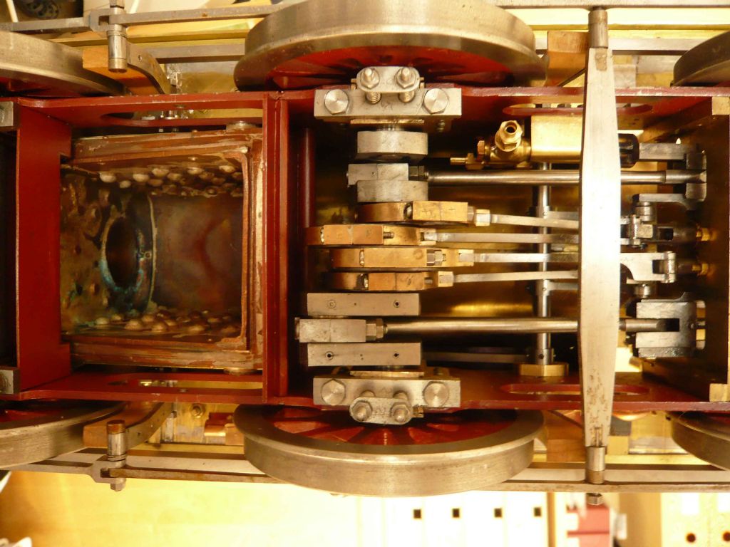

                            #85631
                            Peter Hothersall
                              @peterhothersall43460
                              Hi Julian
                              Good question !
                              On checking my Terrier, there is no clearence on full axle travel. In fact, because the original builder has pinned the Piston rod to the Crosshead the pin is also fouling the axle. I will have to restrict the axle travel as I think it does not need to so great and do something with the pin. Thanks for the heads up on that one.
                              This is a photo of the Cylinders and inside motion
                              Cylinder and valvegear
                              Regards
                              Peter
                              #85644
                              julian atkins
                                @julianatkins58923
                                Peter,
                                that's a great pic of what appears to be a very well made loco. you could always put the front axle between centres when dismantled for painting and turn the section between the axle boxes down to 1/2" dia.
                                cheers,
                                julian

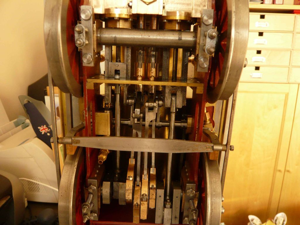

                                        #88728
                                        Peter Hothersall
                                          Hi Bob
                                          Just in case it helps, I have included another one of the photos I took whilst my Terrier's unside was visible. This shows the crank in greater detail.
                                          Crankshaft
                                          If you click on the picture (or the one above) then it will enlarge full size. You can then right click on the enlarged picture to save it on your pc if you felt it useful.
                                          I always find a picture worth a thousand words. I have more pictures if you want to send me an email.
                                          Regards
                                          Peter
                                          #88730
                                          Robert Thompson 3
                                            @robertthompson3
                                            Thanks Peter thats very helpful indeed. As you say pictures always explain so much better than words. I will drop you a line.
                                            Cheers

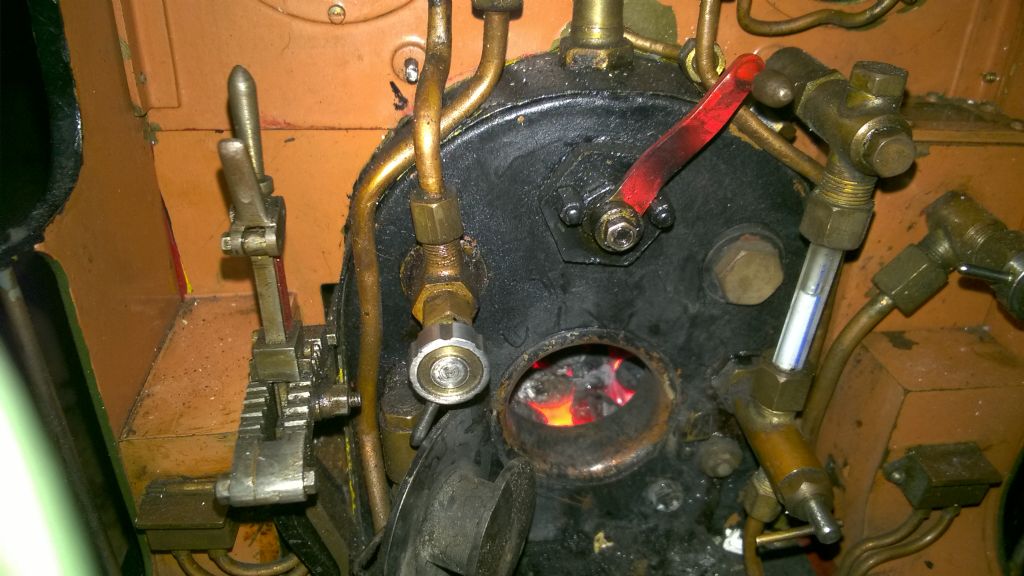

                                            #279281
                                            Lee Griffiths
                                              @leegriffiths86022
                                              Thought I'd add mine to the thread.
                                              Bought unseen from an auction last year with no history. Well made originally, but very poorly repainted at some point. Boiler needs work so I'm thinking of just getting a new one made up.
