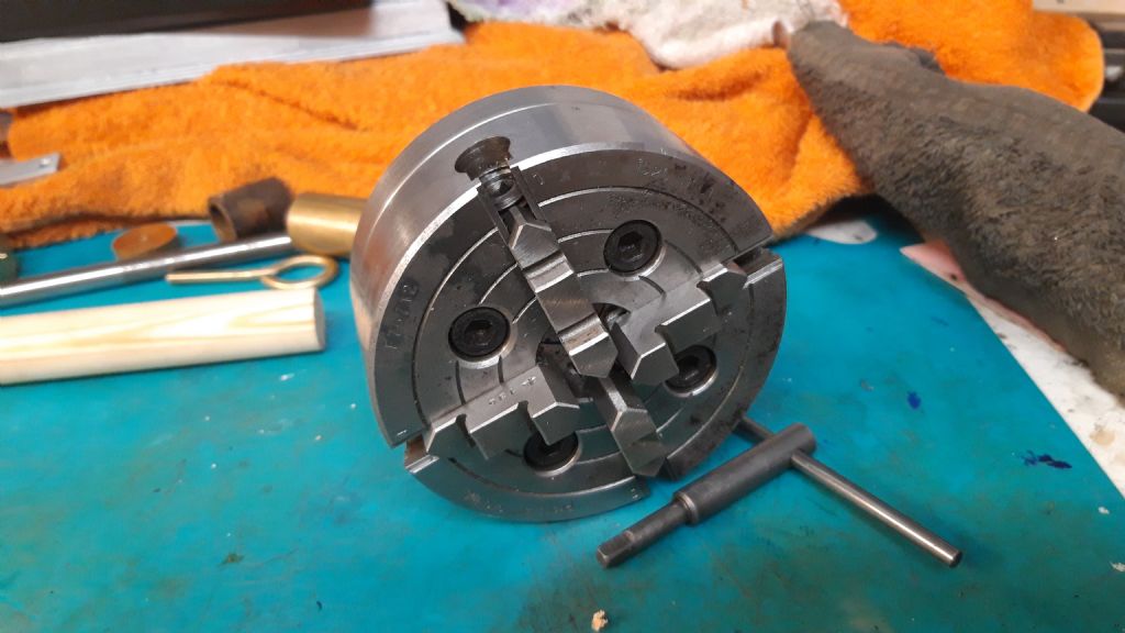

      HI all.
      I got a 100mm 4 jaw independant chuck from Arc, and it comes with 4 allen head mounting bolts, which are useless for mounting the chuck. You can't get them into the spindle flange past the headstock casting. My 3 jaw has 3 studs that wind into the chuck and then easily pass though the spindle flange and then 3 nuts go onto them to fasten it all up. I would swap them into the 4 jaw but there are only 3 of them. What does everyone else do? Cut the heads off the supplied bolts and use them as studs?
      P.S
      Please excuse my terminology, I'm still learning.

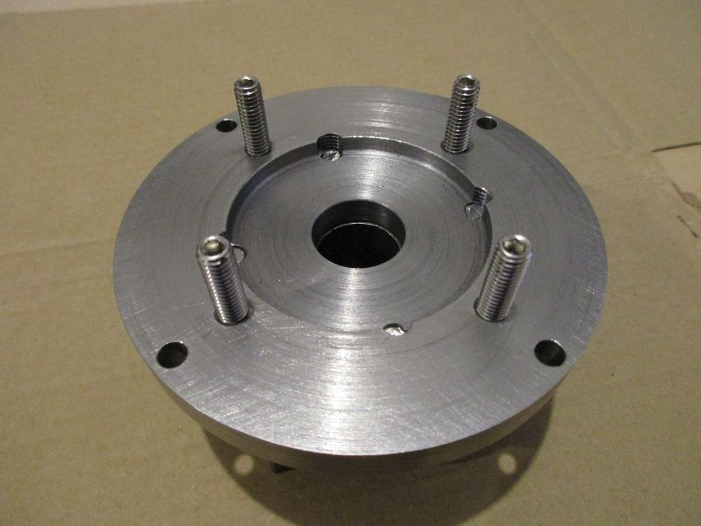

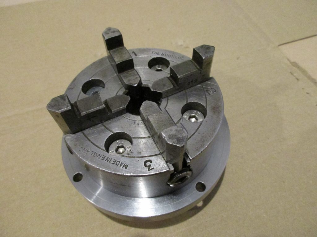

                  Here you go! here are a couple of photos of my 4 jaw mounted onto a backing flange to suit the Mini Lathe..
                  4 jaw back plate
                  4 jaw mounting onto backplate
                  It's a Pratt Burnerd 4 jaw with front mounting holes, but the method will be the same for rear mounting holes, although it might be a bit trickier marking out the hole positions, and you might need to counterbore the holes to suit the bolt heads.
                  Hope this helps
                  Ian

                      Hi SP, yes you need to get a backplate, attach the backplate to your new chuck and then fit three or four studs in the back that will fit onto your lathe.
                      This one I made myself for also fitting to a rotary table, hence the bigger diameter with the four outside holes.
                      Regards Nick.

                        My spindle (with the 72mm flange register) has enough holes to enable both the 3 jaw or 4 jaw to be fitted. The three jaw has 3 mounting holes, and the 4 jaw has 4.
                        It doesn't matter if I offer up the 3 jaw or the 4 jaw, there are holes in the flange to match the ones in the chucks I have. It looks like I'll just have to find some studs the same size as the ones that came with my 3 jaw.
                        Seems there are quite a lot of variations in spec on the mini lathes. Perhaps even variations in a given quantity of the same machine from the same supplier!
                        'Caveat Emptor' when it comes to buying accessories. Nothing that can't solved though.

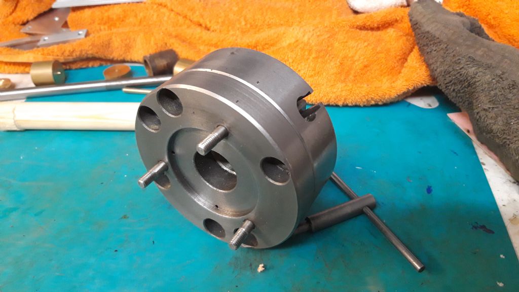

                          So sounds like 6 holes in the flange, in that case do as I suggested and make or buy studs, I think they are M8 so something like this but check the length by measuring one from the 3-jaw, you will also need an extra washer and nut. ideally get a set of 4 nuts and washers then they can be kept loose on the ends of the studs when the chuck is not in use to protect the threads from damage.

                            SP, you dont need a backing plate, you have the spindle flange with the register and the holes for mounting both the 100mm 3 or 100mm 4 jaw and like Jason suggests you just need 4 studs with nuts and washers.
                            It was the same on my mini lathe, I fitted the 4 jaw with four studs so they protruded through the spindle flange to the same length as the 3 jaw and then fixed with the 4 nuts and washers, simple.

                              As Ron says, you just need 4 studs, washers and nuts.
                              It's a pity that your chuck didn't come with these – the one I bought with my lathe from Amadeal came with studs.

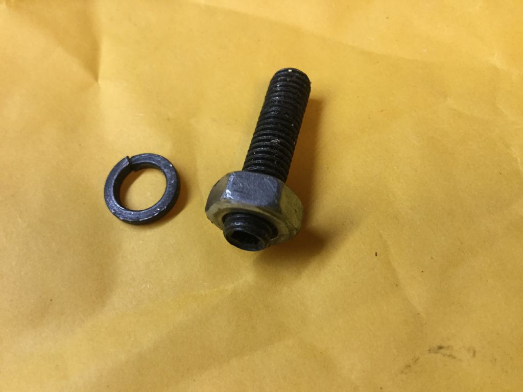

                                  I don't know if this is the norm, but mine came with spring washers.
                                  Photo of the ones that came with the 4 jaw:
                                  3 jaw chuck fixing:

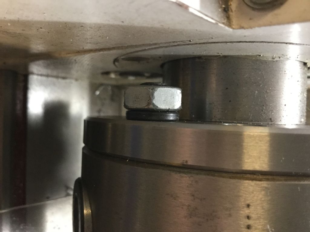

                                    I use M6 washer faced nuts, they have never come loose, and is one less fiddly thing to drop into the swarf. Easier to be found too!

                                        SP, yes your method of producing the studs will be fine, I actually used 4 x M8 grub screws which I got in the correct length from a local supplier which just made it easy. One thing I found worth doing was to threadlock the studs into the chuck to stop the studs moving in or out when fitting or removing the nuts, that can become a pain. If you used studs as Jason linked then you could tighten the stud against the plain shoulder which would secure the studs in the chuck.

                                              I used short pieces of M6 studding in my 4 Jaw chuck, and plain nuts.
                                              Because of the space, or lack of it, between the back of the flange and the Headstock, I made up Danny M2Z's "widget" to hold the nuts as they are fitted or removed. A few minutes with some thin sheet steel (18 SWG? ) or steel strapping in my case, makes a gadget that saves time, temper and frustration.
                                              Could have used washer faced nut, but then Danny M2Zs widget would probably not fitted.
                                              It featured in M E W some time ago.

                                                Thank you so much guys for the advice and photos. It is much appreciated.
                                                Today I got hold of 4 X M6 bolts and hacksawed their heads off. Then using a thead file and a file I cleaned up the ends. I wound them into the chuck and after protecting the lathe bed with a wood platform (in case I dropped the chuck) it all went perfectly through the spindle flange. I wound on some nuts and gave them a nip up. Seems to work very well. Point to note. The back of my newly purchased chuck was not ready to mount. It required cleaning up with several implements to remove (I'm sorry I haven't a word for this yet) rough areas of cut metal on the edges of 4 circular areas at the back of the chuck. If left as they were they would have made the chuck sit ever so slightly awkwardly on the flange. I have only been in this game a short time, but I now regard anything of Chinese origin as a 'kit of parts' that needs further 'fettling'. I don't have a problem with it given the relative cheapness of the items.
                                                If it wasn't for these Chinese tools on offer I would be priced out of the hobby, as I don't have the experience to purchase a used British lathe. I admire those who buy old Myfords, ML1, ML2 etc, as I find their rebuilds and 'work arounds' fascinating. I would dearly love to own such a machine once I have more skills.
                                                Edited By asimpleparson on 19/12/2019 20:47:46

                                                    My mistake. Apologies, it's nearing the end of a long week, and rather busy this time of year!
                                                    M8 bolts.
                                                    I went to fit the chuck and thought to check the rear, and running my finger over it I could feel the ridges of rough sharp metal around the holes.
                                                    'Deburring' that's the word I'm looking for.
                                                    No problem with Arc by the way, very happy with prices, customer service, website, catalogue, and the whole shebang. Happy customer. Will be using them again very soon.
