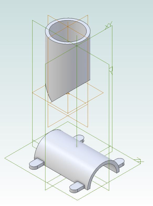

      I was drawing two parts, as follows:
      (tried to do my best to hide all traces about the program I used, as it is not favourably regarded here…)
      Part 1:

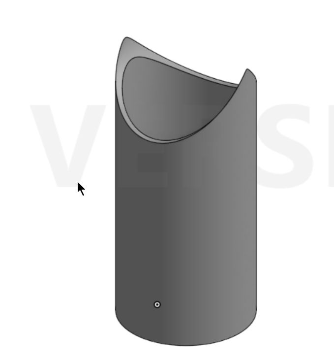

      Part 2:
      The problem is the following: assemble part 2 on the surface of part 1, centrally, forming a Tee (hope I explain that good enough). Like a steam dome on a locomotive should make it clear.
      With my program I found not out how to do that, so I printed both parts separately and used epoxy glue to join them.
      The diameters of the two parts are the same.
      How can it be done in Freecad, Solid Edge or Fusion?

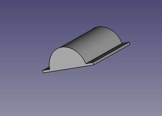

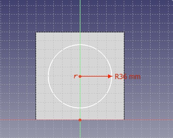

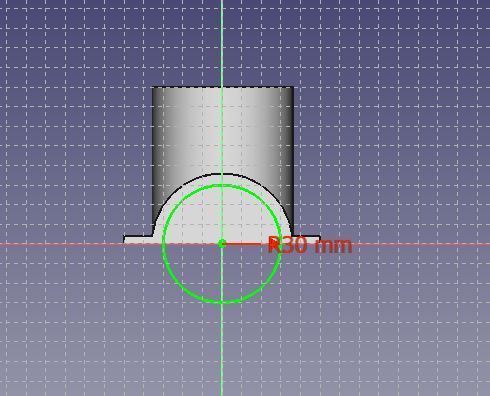

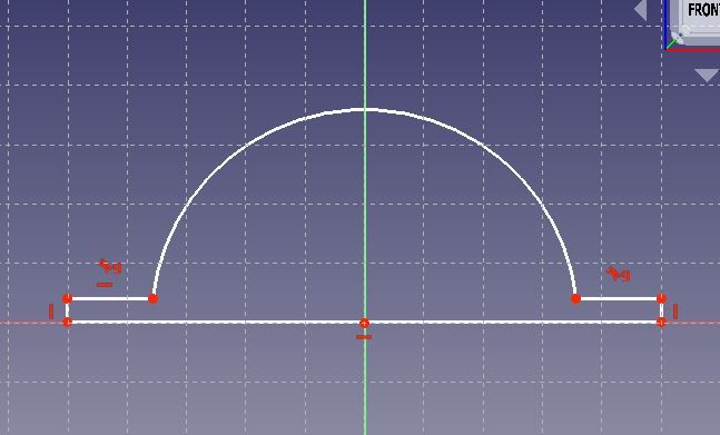

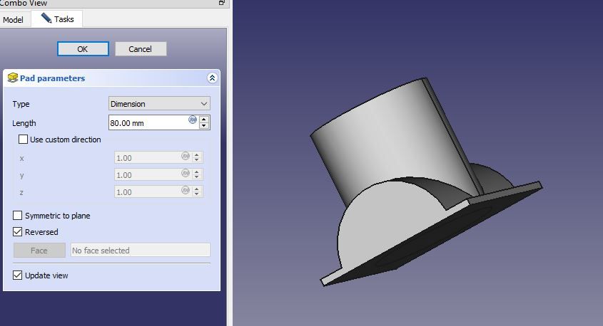

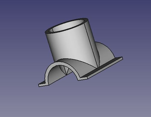

            Apologies for not following the instructions exactly, but this is FreeCAD:
            Done this way. First sketch the base section.
            And pad (extrude) it:
            Then flip the object over, and sketch a circle representing the riser pipe one the base.
            Pad this circle in Reverse so it comes out the top giving:
            Lastly, draw circles on the top face, and the lower semi-circle and pocket both to create the hollow pipes:
            There's also a thickness tool which can do the last two steps without sketching.
            Solid Edge and Fusion can make the part in much the same way: sketch on plane or face, then pad (extrude) or pocket( cut).

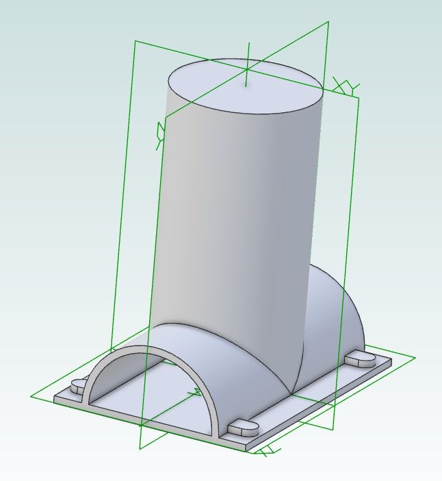

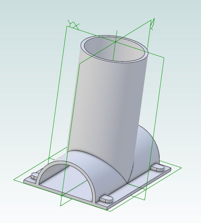

                #597205

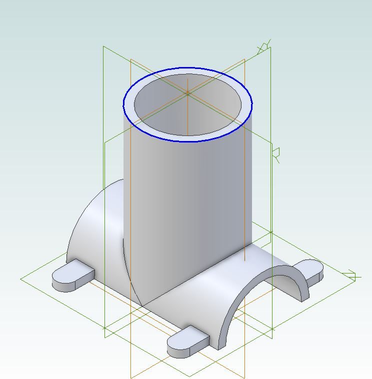

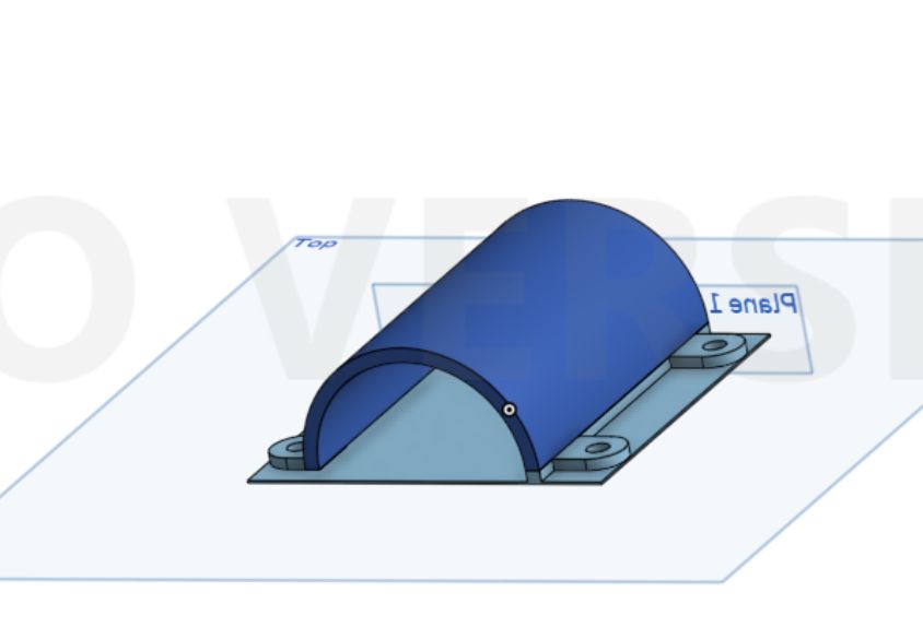

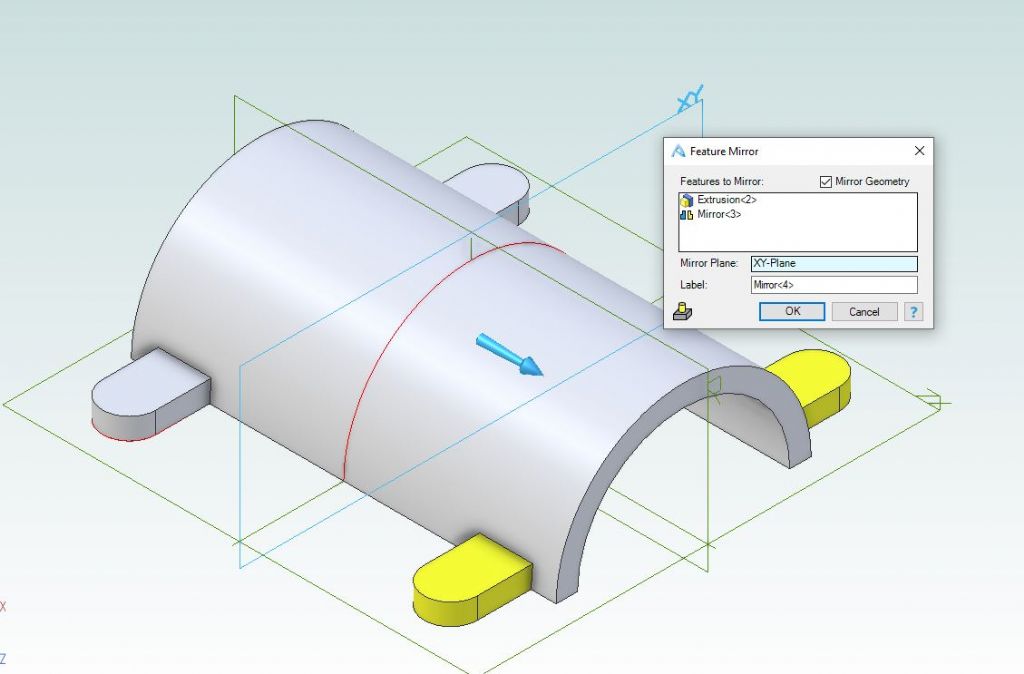

                  Looking again at your firs part, the half round. If that had been extruded equally about plane 1 rather than all to one side you should then have been able to use that plane to line up the two parts provided the circular part was central to two axis.
                  The added bonus would be that you could also have mirrored the tabs about the central axis too.
                  Extruded centrally and tabs mirrored
                  Then align the two vertical axis and then the horizontal planes and they all sit in the correct position but it does need some thought at the sketching stage to make assembly this easy.
                  Assembly screen showing half round lined up in XY&Z (green) and the geometry of the tube in brown

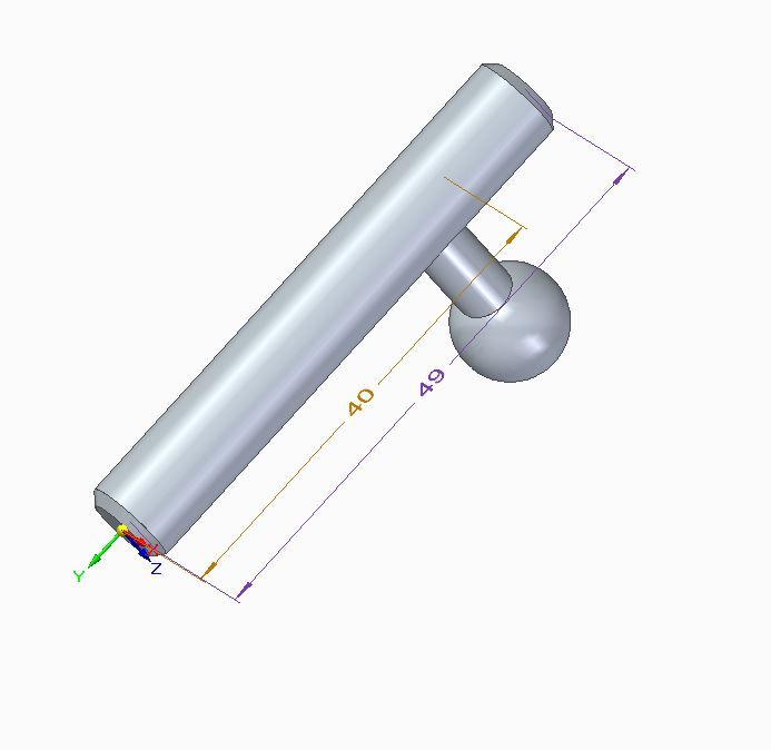

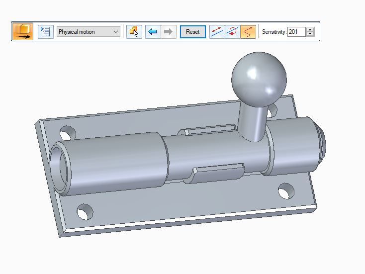

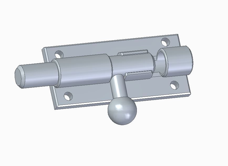

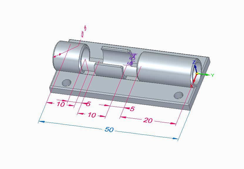

                      This example is Solid Edge. I designed a door bolt, which although based on the domestic item, is original : my dimensions, not a copy.
                      First part is the bolt body:
                      Created separately is the bolt. It has to fit into the body, correct diameter, length, handle to fit the slots etc.
                      SE (and similar CAD packages) allow two or more parts to be combined as an Assembly, which achieved by drag and drop plus intents – axial, rotation allowed or not etc. The result is two parts working together.
                      The software understands the bolt slides in the body, and detects collisions and interferences. When the design is correct, the bolt can be moved realistically on screen to prove all is well:
                      Mildly useful for designing a simple door bolt, but highly valuable when developing a multi-part object like an engine, where pistons must fit into cylinders without smacking into the head or valves, whilst the conrods turn the crankshaft without jambing. At the same time, the valve gear is driven from the crankshaft by a chain, and valve events delivered with cams. Saves an enormous amount of time when fits of all these different parts can be confirmed in a model, rather than painfully made for real, only to find they crunch expensively together inside the prototype!
                      Challenging enough to build an engine from someone else's plan, but much harder to reverse engineer an old engine from pictures or to develop a working engine from scratch. These tools are primarily for creating original work, not copying what went before.

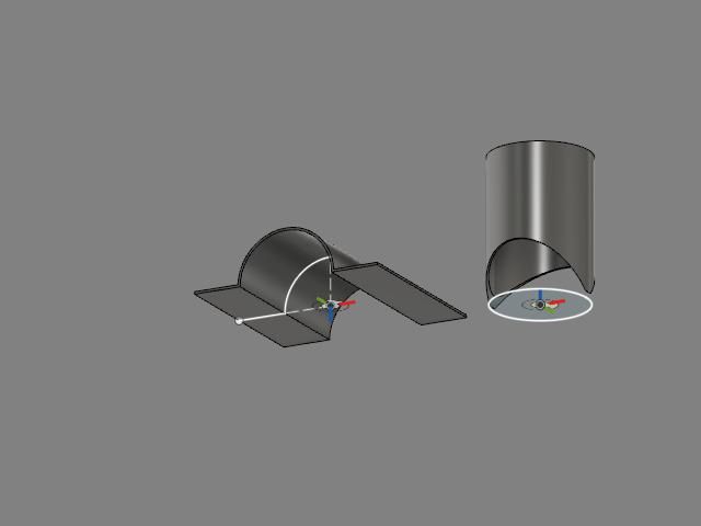

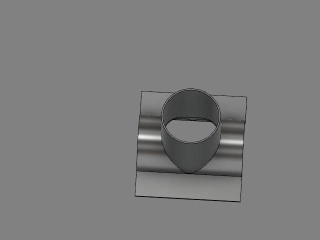

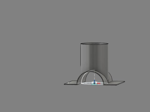

                        Fusion allows you to pick where you join parts, or to place Joint Origins at known places. It then gives you the option to offset and/or rotate the parts when you actually join them:
                        Parts, the multi coloured features are the Joint Origins:
                        Rigidly joined together using those origins:
                        And you didn't ask for this, but cut the centre of the joint using the tube's inner profile:
                        The original sketches show in some of those pics, and you'll see they aren't closed profiles. Instead I used the Thin Extrude command which saves a lot of time. Also, only half the clamp body was drawn and extruded, then it was mirrored about its central face which also saves time and simplifies the sketch

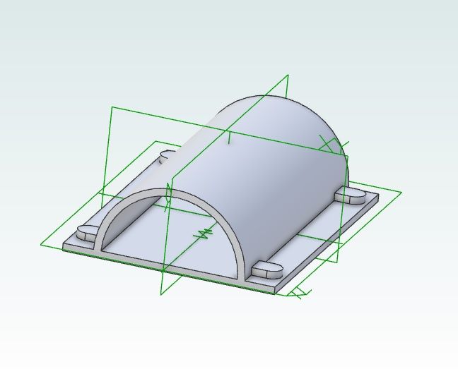

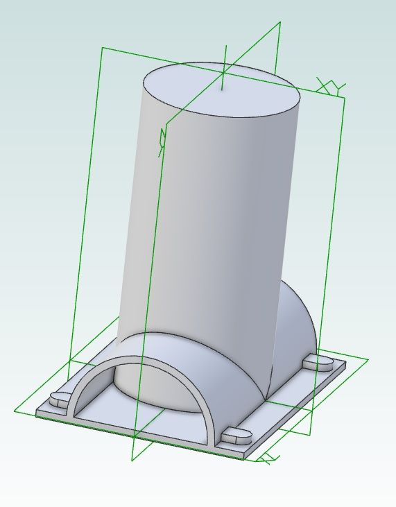

                              Did I mention that I don't watch "Coronation Street" No? Well it's on TV now, so while my wife gets her Friday fix, I thought I'd do it my way.
                              I sort of combined some of the previous ideas but latched onto Jason's idea to do it all in one drawing. So, I thought, how about treating it as if it were a solid casting and "machining away the unwanted bits?
                              First, sketch the basic profile and extrude from a mid-plane, With lugs drawn once in a separate sketch and mirrored around two planes:
                              Then add the side extension as a solid :
                              Followed by removing the semi-circular section :
                              Then "hollow out" the side pipe section:
                              Just one 3D drawing in Alibre and for export to a STEP or STL file for printing.

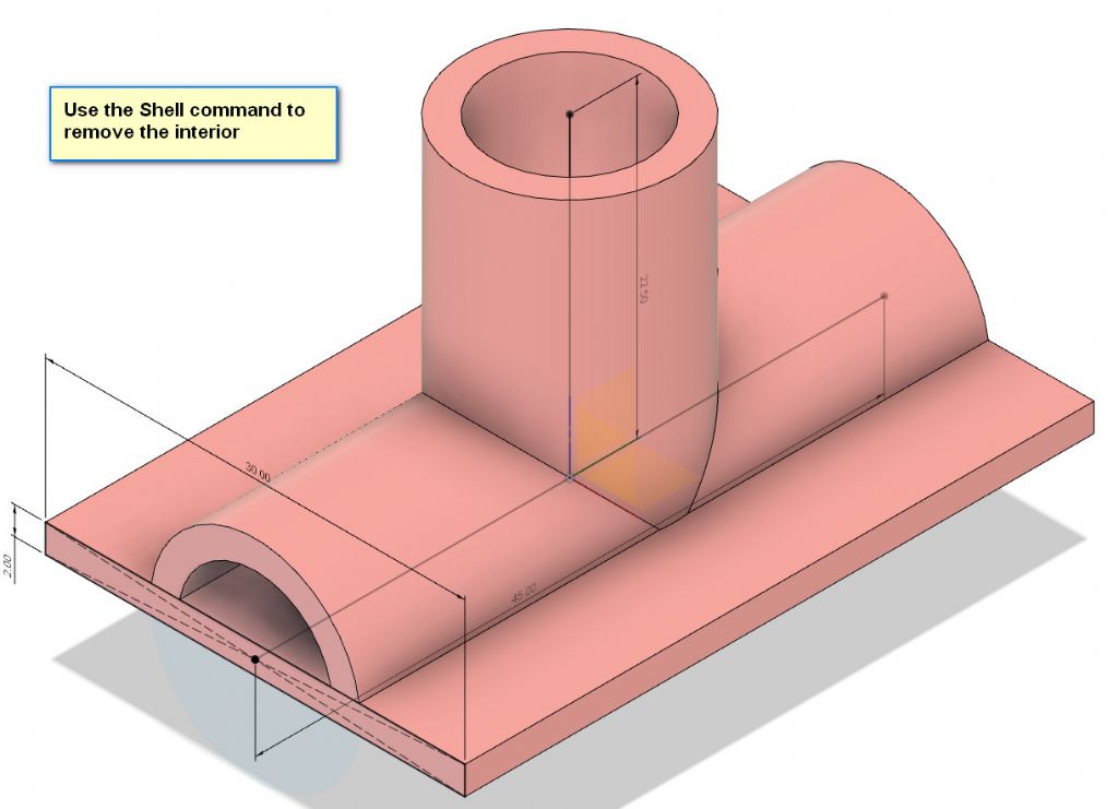

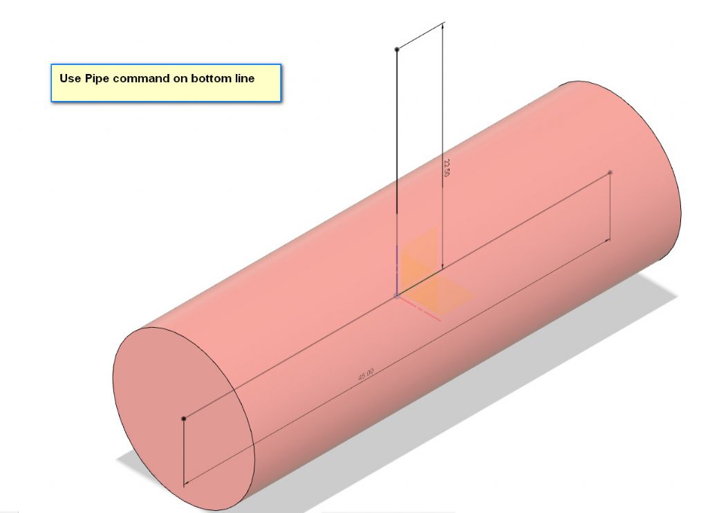

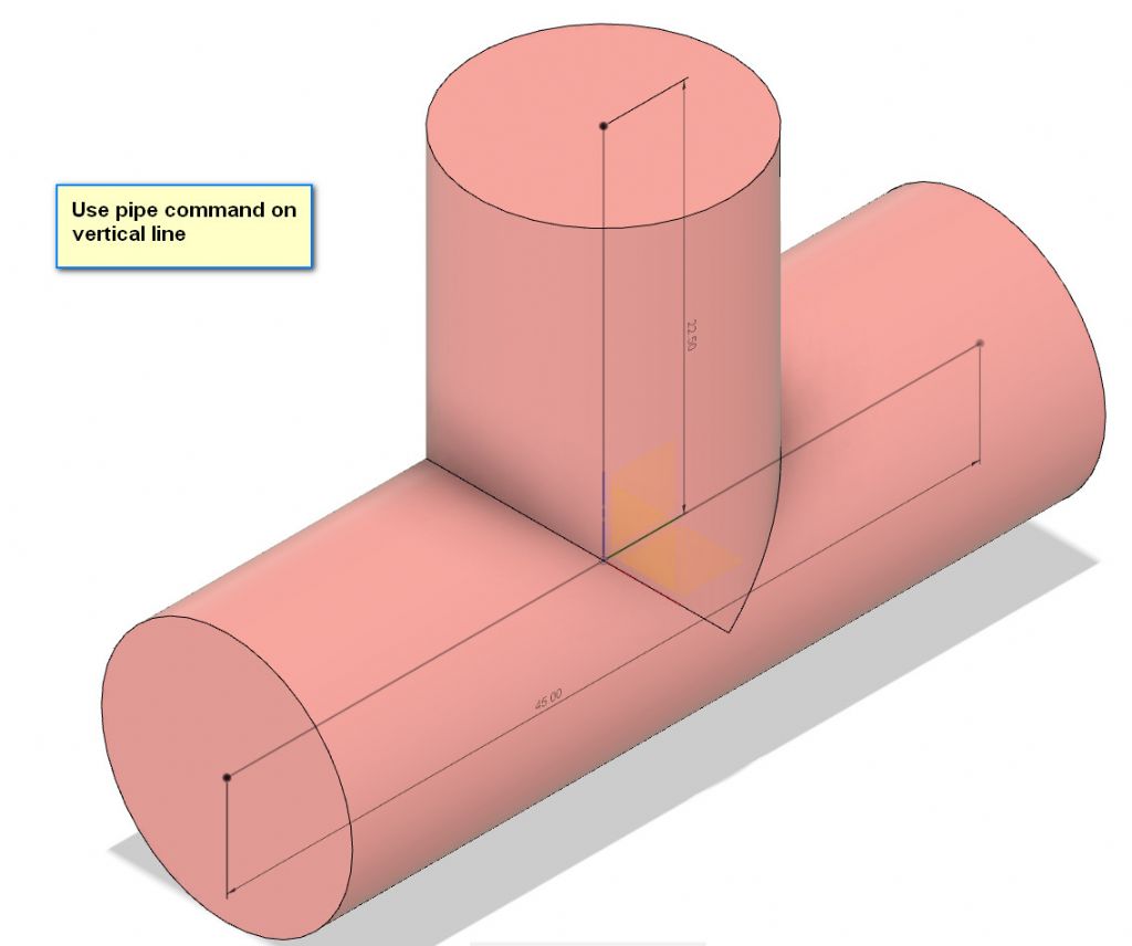

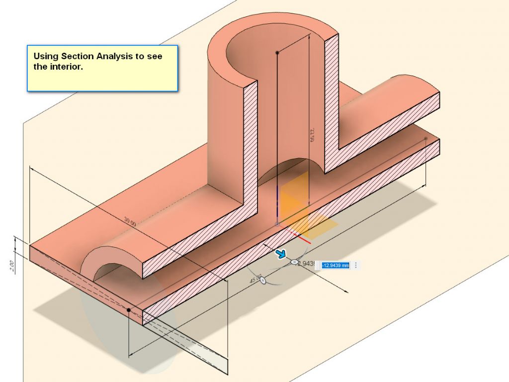

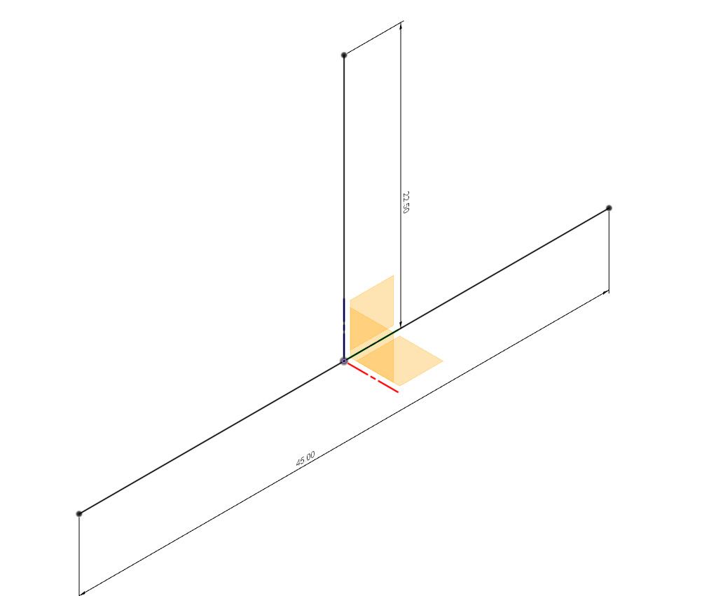

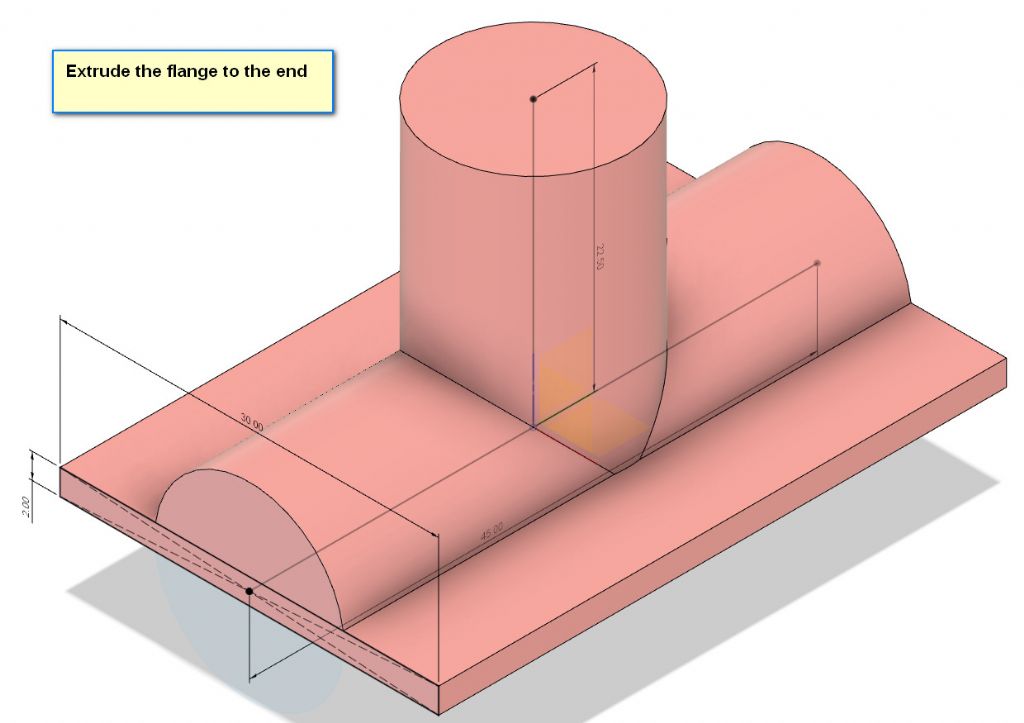

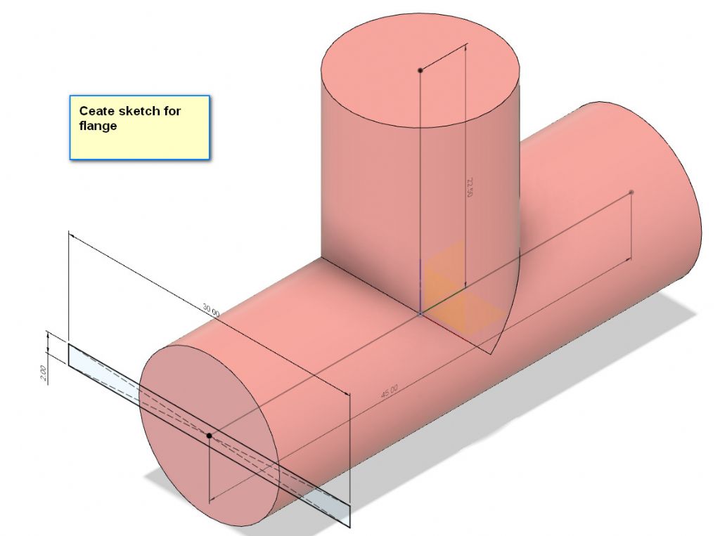

                                In case anyone is interested in using Fusion for it…
                                First draw a sketch of the centrelines of the intersecting pipes.
                                Next, use the Pipe command to create a solid cylinder along the horizontal line.
                                Then use the same command to create the vertical cylinder joined to the first one.

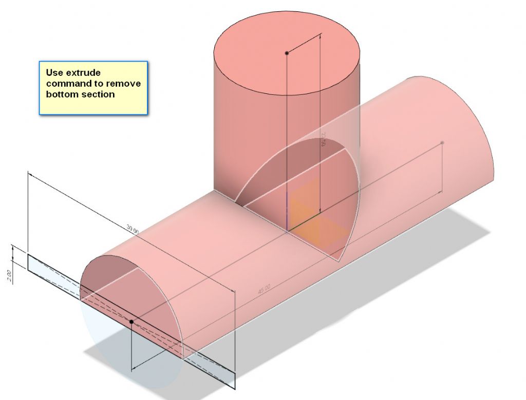

                                Now draw a sketch of the flange X-section on the end of the horizontal cylinder.
                                Now extrude lower section be low the flange profile to remove the bottom part of the horizontal cylinder.
                                Then extrude the flange profile.
                                The last step is to use the Shell command to remove the unwanted interior to leave a wall thickness equal to the thickness of the flange.
                                #597319
                                Gary Wooding
                                  @garywooding25363
                                  You can then use the Section Analysis tool to show the interior.
