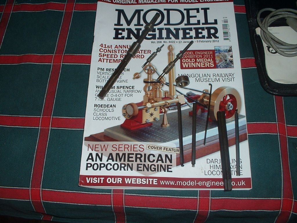

                                          John There many ways of digging out broken taps. But before I begin are your holes ‘through’ or ‘blind holes’?
                                          Method 1 The chemical method. This depends on the fact that hardened steels are more readily attacked by chemicals than mild steel. I generally use this method for taps smaller than 3.2 mm. Get hold of a solution of Ferric Chloride (the stuff used to etch Printed circuit boards). Clean out the cutting oil with isopropanol then drip in the Ferric Chloride. If it is a open ended hole stop up the bottom with something. This method is slow.
                                          Method 2 Make a hollow cutter. As you are using 6mm I would make the hole down the centre 6.32 mm (1/4&#8221 with an outside diameter 7.5mm. Now cut out a larger hole. Plug the hole In 15mm I would silver solder in the plug – drill and re-tap-
                                          Method 3 This is similar to method 4 Make a short-ish stub of some tough old steel. Drill a shallow-ish hole in one end say 3/8” deep. This will have the same diameter as the core of the tap. Now file 2, 3 or 4 short prongs (The number you cut will depend on the number of lands in the tap). It is a good idea to make them fit closely into the lands of the tap. They do not want to be more than ¼” long. Try to unscrew the tap.
                                          Method 4 This work on larger sizes of taps 6mm up. Buy or make a tap extractor. You could look on ‘Flea bay’ for them you want a 6mm. I bought a few at a car boot sale – the geezer flogging them did not know what they were and I did not tell him.
                                          Method 5 get yourself a thin rat tailed diamond file (I think AC Euro do them as I bought a set from them) use one to file away part of the core of the tap.
                                          Method 6 The ultimate make a new pad.
                                          The picture shows a selection of tap extractors in the top left is a 3/8” tap in the 3/8”extractor. In the bottom left is one in pieces –it also has a bit missing –the sleeve- I will make one after I have made a round tuit (or bought one)
                                          Oh the smallest is for 1/8″ (3,2mm – 5BA)
                                          David just looking at them I have figured out how to make them (Not the tuits). Do you want a short article?
