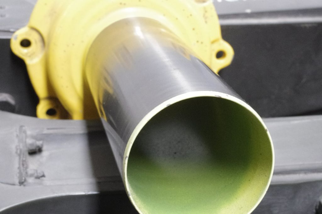

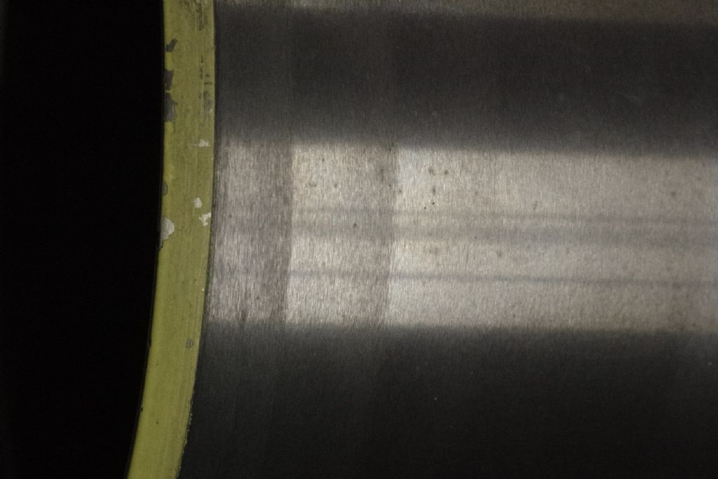

                                                      1. My experiance of hard anodising is only with aircraft components which are produced to higher specifications than usual. My firm used to make uplocks for Airbus landing gear which had hydraulic actuator cylinders with a bore of about 3/8". The anodising was about 0.002" thick and was ground in house to a mirror finish, the unground ends of the cylinder were smooth, but not as good a finish as the bores. These pictures are of a hard anodised and ground tube which the swashplate spherical bearing slides up and down on for a helicopter. Possibly, a Bell Jet Ranger. The grinding may be visible in the photos. The diameter is about 4"._igp2394.jpg_igp2395.jpg
