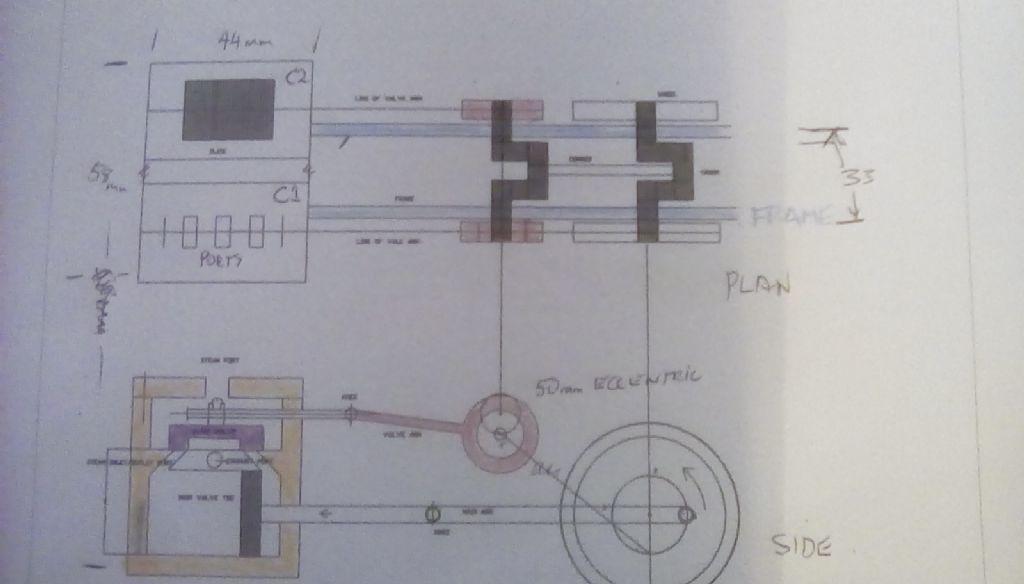

                      img_20210222_170644.jpgI have added colour for some clarity. There is also a layout. The two blocks are close together so should i combine them?

                      Redsetter
                        @redsetter
                        John,
                        I think you should study some existing simple 0 gauge designs.
                        For example – LBSC's "Bat" and "Mollyette," and Dave Watkins's "Wild Rose," and "Brick." – four different types of loco, all with different mechanical layouts.

                        Nigel Graham 2
                          @nigelgraham2
                          John,
                          I agree with Redsetter – examine other designs for ideas and general design practices.
                          Yes- that slide valve is drawn as it should be, with the "lap" at each end, but needs moving to the left a touch with the piston in that position. Referring to your drawing, that is so it is starting to open the right-hand port to steam just as the crank is passing dead-centre, while its inside edge is opening the left-hand port to exhaust.
                          The gear driving it is arranged to do that, at both dead-centres, by its action being about 120º ahead of the crank. The actual angle depends on the proportions of the particular engine's valve and ports.
                          Note that the slide-valve needs to be able to "float" vertically but without end-play, so the steam will hold it down onto the port-face. I'm not sure what the usual practice in this scale is, but I can see how to do it on your arrangement if you've not already done so
                          Slot the lug through which the valve-rod passes, vertically, so the valve can move up and down on the rod a touch. Then either thread the rod back to near the end of the valve, and place a pair of lock-nuts with turned washers each side of the lug. Or – and perhaps better as well as simpler – you can arrange the lug to be between a pair of simple collars held with grub-screws to the rod.
                          In either case these fittings are adjusted so the valve can find its own level, but without end-float.
                          This allows the valve to seal down on the port-face, and for you to adjust the valve's position along its rod to put the timing spot-on.
                          I know you've not shown the details, but the joint between the valve-rod and its link needs a guide like a small crosshead of its own, to keep the valve-rod running straight and true. Just a simple collar with a lug that holds the joint itself, running on a rod projecting from the valve-chest.
                          Combining the two in one lump of metal… Many locos are built that way, and it gives the cylinder a dual role as a frame-stretcher. Do though ensure it will be reasonably easy to remove and replace the valve-chest covers, for setting and servicing the valves.
                          Some full-size locos, usually small tank locomotives but also the GWR main-line classes, were built with their cylinders outside the frames but the valve-chests and valve-gear inside, for looks. They can't have been easy to service in full-size, and miniature versions are in some ways worse because our full-size hands don't fit the scale-size spaces available! (I'm told there is no truth in the tale that their former designers went on to teach car-designers…)

                          duncan webster 1
                            @duncanwebster1
                            You've got the dimension across the frames at 33mm. The distance twixt the rails in gauge ) is 31.75mm, something amiss?
                            I can't read the drawing very well, but if there is meant to be one coupling rod connecting the axle to the shaft carrying the eccentrics (layshaft) it ain't going to work, you'd need 2. It's all getting a bit complicated, and you won't be able to have suspension on that axle (do O gauge locos have suspension?). I have a loco not too dissimilar, but the layshaft is driven by a chain and gears from the axle. Why? just to annoy a fellow club member who was too far up himself! The layshaft goes the opposite rotation to the axle, but it works a treat
                            A nice simple way of driving outside valves is to have slip eccentrics on the axe with a rocking shaft, see drawings of Tich amongst many others

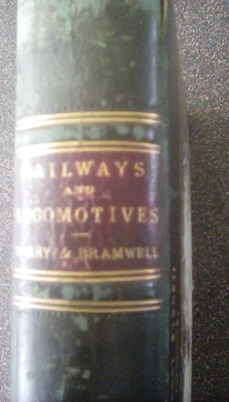

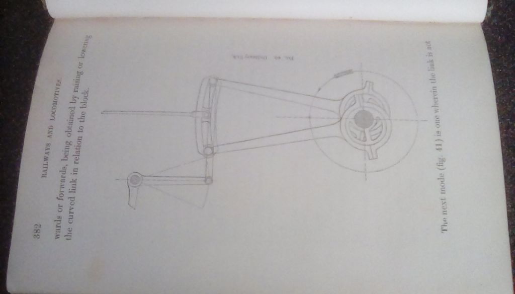

                                      img_20210224_103446.jpgNigel has dubbed my timing wheel "the Bramwell gear" which is quite a coincidence because i have a book entitled Railways and Locomotives, lectures selivered at the school of military engineering at chatham in 1877 by John Wolf Barry and Frederick J Bramwell.! In it there are many beatifully drawings including three types of valve linkage; ordinary, reverse radial and straight. Here is a photo of the ordinary linkageimg_20210224_103302.jpg

                                        Relation of yours?
                                        Those old text-books are a great source of information for model-engineering, by showing typical design practices contemporary with the types of machine we are replicating. I have a few, one of which concludes a chapter on water-turbines with the assertion that the world's rivers should supply enough power for mankind's needs… in 1911!
                                        Mill-engines fitted with plain valve-gears driven by just an eccentric to run in only one direction to drive factory machinery, were sometimes fitted with a slotted eccentric bolted to a disc keyed to the crankshaft, to be set clockwise or anticlockwise to suit the particular installation.
                                        One small stationary-engine preserved at Weston Zoyland Pumping-Station Museum (fen-draining) has cam-drive poppet-valves, somewhat as in a car engine. The cam is elongated with a tapering profile giving a varying throw by its position along a keyed shaft, controlled by the governor, so maintaining constant speed by varying the cut-off rather than a throttle-valve.
