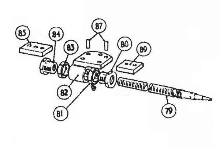

        Hi it Harold . Asking about nut for the mill . I live in the united states . what is the out side diameter of the nut ? And the length.
        #584729
        Peter_H
          @peter_h
          What may be more practical, and benefit everybody, is if Mark could post the drawing or whatever sketches he used for making it.
          It doesn't look much more than a cylinder with two different diameter bores, one fine threaded ( to mount it?) and the other threaded ACME for the lead-screw. Any external keys or flanges or anything Mark?

              it should be 1 5/8 outside diameter by 2 1/8" long. with 1 1/8" of 1" x5tpi ACME thread at one end and and 1" of 1.4"x 20tpi (or thereabouts) thread at the other end.
              There is a seat for a locating screw, but that it best drilled using the hole in the mounting bracket as a guide to get it in the right place.
              The matching half of the adjustable feed nut has just got a flange for holes a hook/C spanner can turn it with, a 20tpi thread matching the first part (exact diameters are irrelevant just make them to fit each other), and a 1" x 5tpi ACME thread.
              There is another collar that fits the external 20tpi thread of the second hald of the pair, that's for locking it in place after adjusting the backlash.
              Basically, this is what Harold's photos show. the best method is to make a set that matches the originals, using their dimensions as a template.
              The only part of the operation that isn't trivial is getting a 1" x 5tpi internal threading tool. I used a bit of 1/4" square HSS ground to the right form and held in an old boring bar.
              If one isn't comfortable with that, Carmex make a good tool that will do the job. Unfortunately the normal laydown threading inserts are a waste of space, since 5tpi ACME is a 22mm insert, which is too large to fit in the bore that's being threaded (like most bl**dy internal laydown inserts).

                Good description Mark, thanks.
                It looks like the VBRP mk II was different. Both parts of the adjustable nut are the same or very similar, and consist of a normal 20tpi thread on the outside, a flange with C-spanner holes on one end, and 5 tpi ACME right through the middle. There a locknut each end similar to the flanges above, but with an internal 20tpi thread to screw on the outside of each nut half. So the nut halfs 80 and 84 screw into the fixed casting 82, adjusted by screwing each nut half lightly together, then locking with locknuts 83 and 81. The inside of the leadscrew hole in casting 84 leaves a volume that acts as an oil reservoir. You can just see the oil nipple near the right lock nut and adjacent to the item 84 leader line.
                #585497
                Mark Rand
                  @markrand96270
                  That's a drawing of the Y feed, which has, as you say, got two identical movable bits. The X feed has only got the one movable bit, on account of not being able to reach inside the saddle to get at the other side of the assembly. laugh

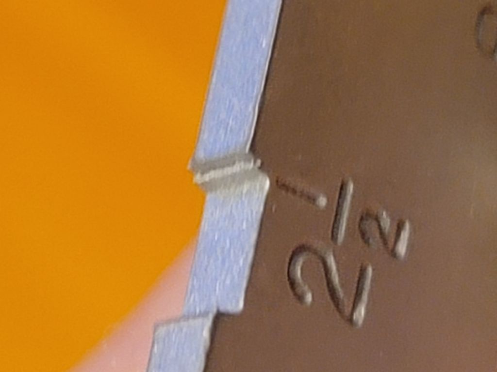

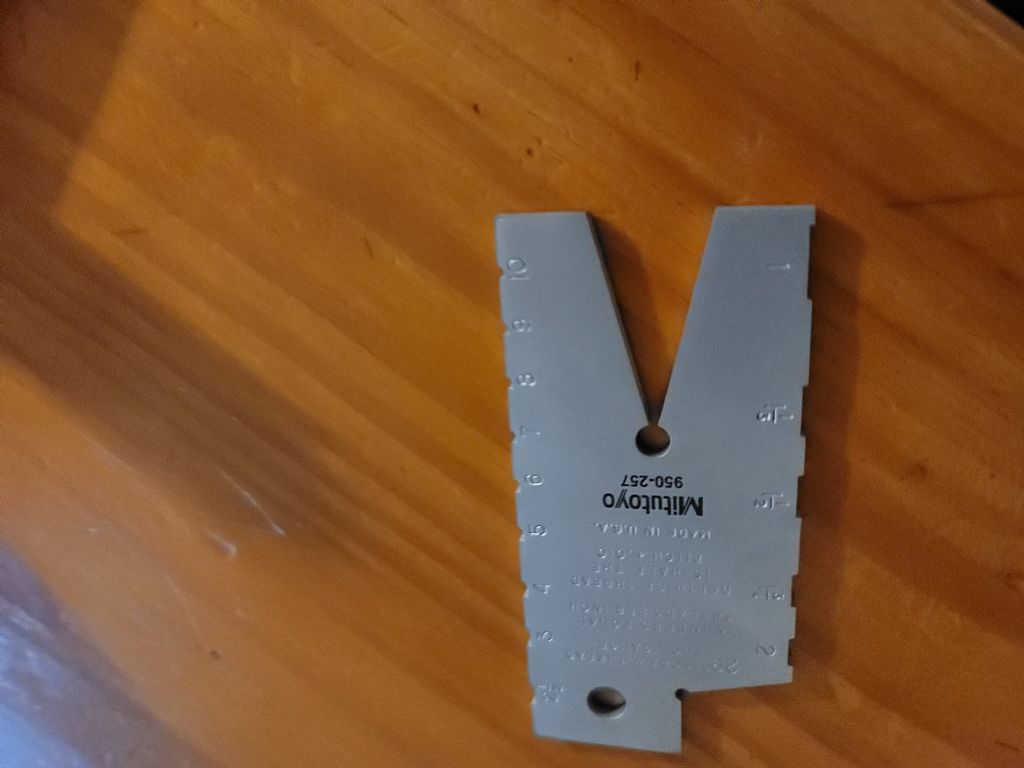

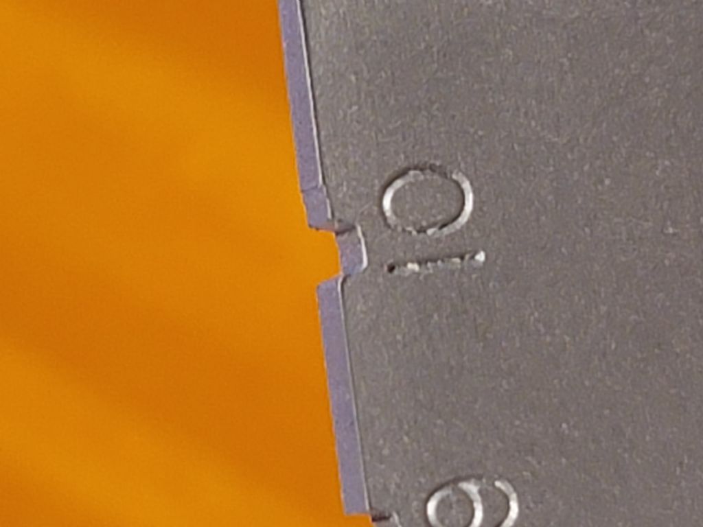

                  #585522
                  Harold Jolly
                    @haroldjolly73409

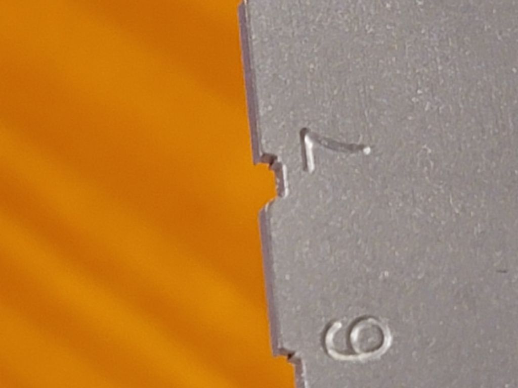

                    20220213_155215.jpg20220213_155244.jpgi
                    i bought this Mitutoyo tool gauge . Some of the notch are not at 29 % . should I send it back ?20220213_155256.jpg

                      Mark – yes, the crossfeed nut. That's what I thought we were talking about? Having looked back at the original post I can see I grabbed the wrong end of the stick!

                      #598407

                          #598440
                          bernard towers
                            @bernardtowers37738
                            That gauge looks unfinished, I have the brown & Sharpe version that must be about 60 years old and it is a joy to use all the sizes are beautifully ground. Is it possible its hooky?

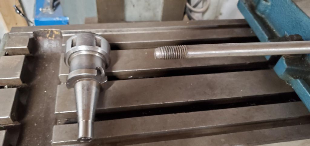

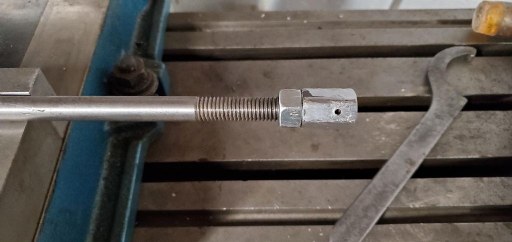

                                    #638411
                                    Daniel Roberge 1
                                      @danielroberge1
                                      Hello

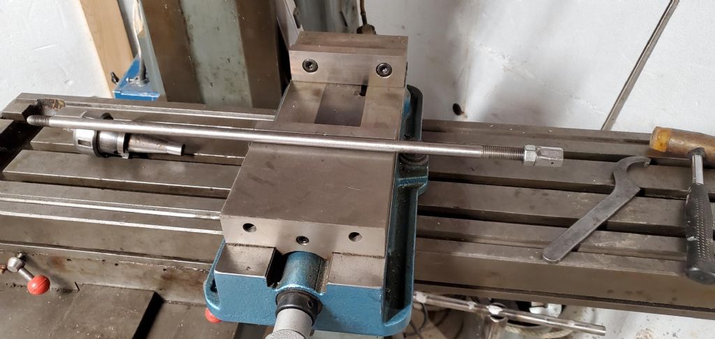

                                      New to the site as I've recently purchased a Beaver Mill. I would like to replace the draw bar on it as I suspect it is not original and also find it difficult to use when doing tool changes (haven't figured out if the spindle even locks and need to use a spanner wrench).
                                      Would anyone be willing to share some pictures of their draw bar / setup? Anyone install a pneumatic draw bar on their mill? Does that even work if I can't lock the spindle?
                                      Thanks.
                                      #638655
                                      Ian Bowers
                                        @ianbowers85137
                                        Hi,
                                        I can have a look at my draw bar in the next day or so, I’m not sure if it’s original as I have spacers on it.
                                        There is no spindle lock I just use a low gear!
                                        Ian
                                        #638703
                                        Peter_H
                                          @peter_h
                                          I'd be interested in any ideas for a pneumatic draw bar. Advancing years makes it more difficult to get up there with a spanner everytime.
                                          Sorryu, due to ceiling height I can't remove the drawbar without tilting the head 90 degrees and it took an age to get in clocked in again last time. I made my drawbar from a simple length of steel M12 studding. I turned an over length brass nut with a taper on the bottom to keep it central when taking force, and a pair of locked together nuts for operating it. Surprising easy to get the length right. I don't have any INT30 holders with the old imperial drawbar thread, They're all M12.
                                          DItto as Ian, no spindle lock, just drop it into the low backgear. Fine for tightening chucks etc.

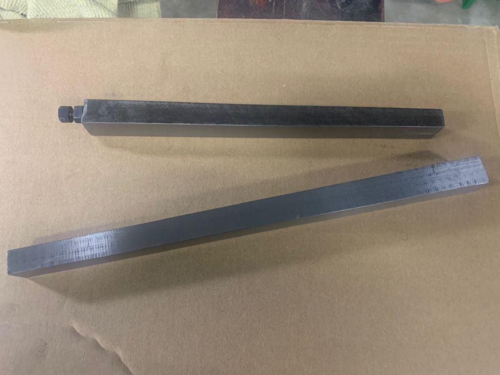

                                            Nearly four years ago I made some enquiries in this thread regarding the dimensions of the Y axis gib strip to allow me to make a new one and I finally got around to making it yesterday, I used a piece of flat cast iron bar and milled it to approximate size then ground it to fit. I will now finish the contact faces by scapping for a perfect fit and a bit of oil retention.
                                            The top one is the gib that was in the machine when I got it.

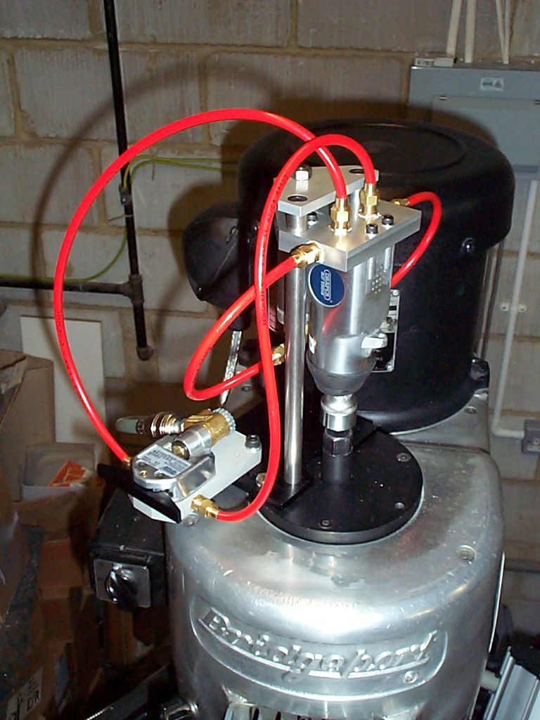

                                              I made and fitted a pneumatic drawbar for my Bridgeport, what with its riser and off floor pads, the top is quite high.
                                              Works every time without locking the spindle although I can if I wanted to.
                                              #647738
                                              KWIL
                                                @kwil
                                                Air Power Drawbar
                                                Air Drawbar pic for Bridgeport

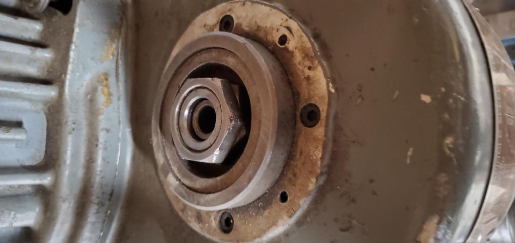

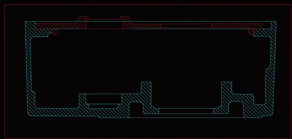

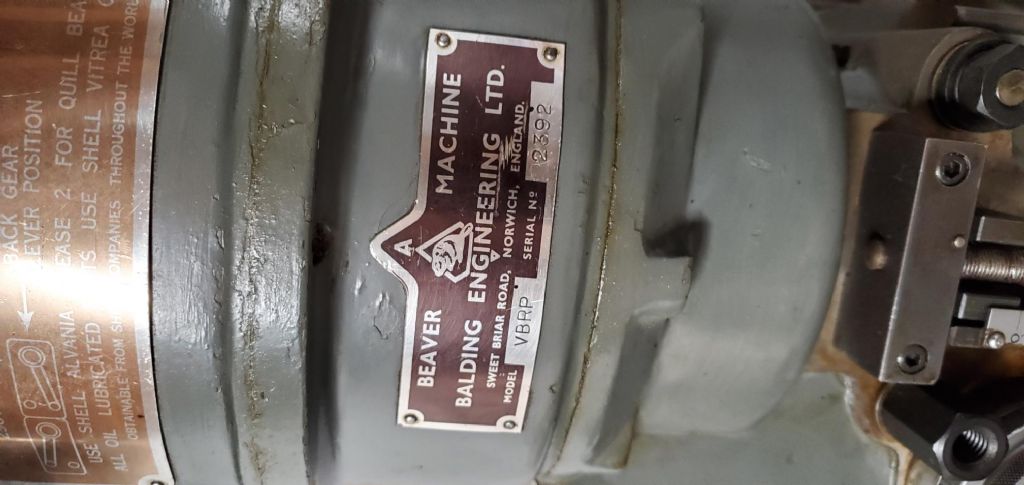

                                                  My VBRP – 2 seems to have a lot of oil passing down through the spindle from the back gear housing, the diagrams in the parts manual are not very clear as to the sealing arrangement in there, has any one resealed one of these machines?
                                                  #658369
                                                  Nigel McBurney 1
                                                    @nigelmcburney1
                                                    I solved the drawbar removal problem on an Elliot turret mill when low ceiling height was a problem,I had a variety of 30 int tooling with different threads , so I made a new drawbar (en8)with a smaller diameter thread, and then plugged the threaded hole in the 30 int tooling and tapped them all to suit the new drawbar, some of the threaded inserts were more like helicoils but they worked with no problems and no need to remove drawbars,and were in use daily for around 25 years. This scheme was ok for 30 int but there could be potential problems if the spindle had been 40int.
                                                    #658381

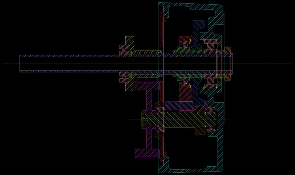

                                                    Peter_H
                                                      @peter_h
                                                      Posted by Lex Davis on 29/08/2023 08:17:19:
                                                      Lex, I did a clearer traced diagram of their exploded diagram of that area :
                                                      https://www.model-engineer.co.uk/wp-content/uploads/sites/4/images/member_albums/143475/808162.jpg
                                                      And of the casting alone :
                                                      https://www.model-engineer.co.uk/wp-content/uploads/sites/4/images/member_albums/143475/807977.jpg
                                                      In neither of them can I see any sign of an o-ring or flange seal, or any outlet other than the spindle/quill, but I'm unsure on orthogonal veiws. It looks like the only thing that stops spillage is the casting (green in dwg I think) being deeper than the back gear (dark blue in dwg), and the lower spindle seal (felt, hardens over the years, cracks apart when removed) leaks that spillage.
                                                      Obvious questions, but have you checked the oil sight guage on the front?. They are notorious for getting blocked with gunge and showing a fix incorrect reading. Over the years, the oil gets topped up and up and eventually over fill. Also, checked for casting cracks?
                                                      Maybe put a tin under the spindle, engage back gear and highest speed. Don something oil proof, stand well back, Quill up, push the startbutton, stop after 5 minutes, quill up, on for 5 minutes. Repeat. Or just pull the drain plug, change the sight guage, and refill.
