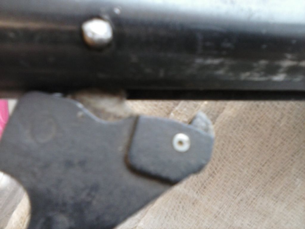

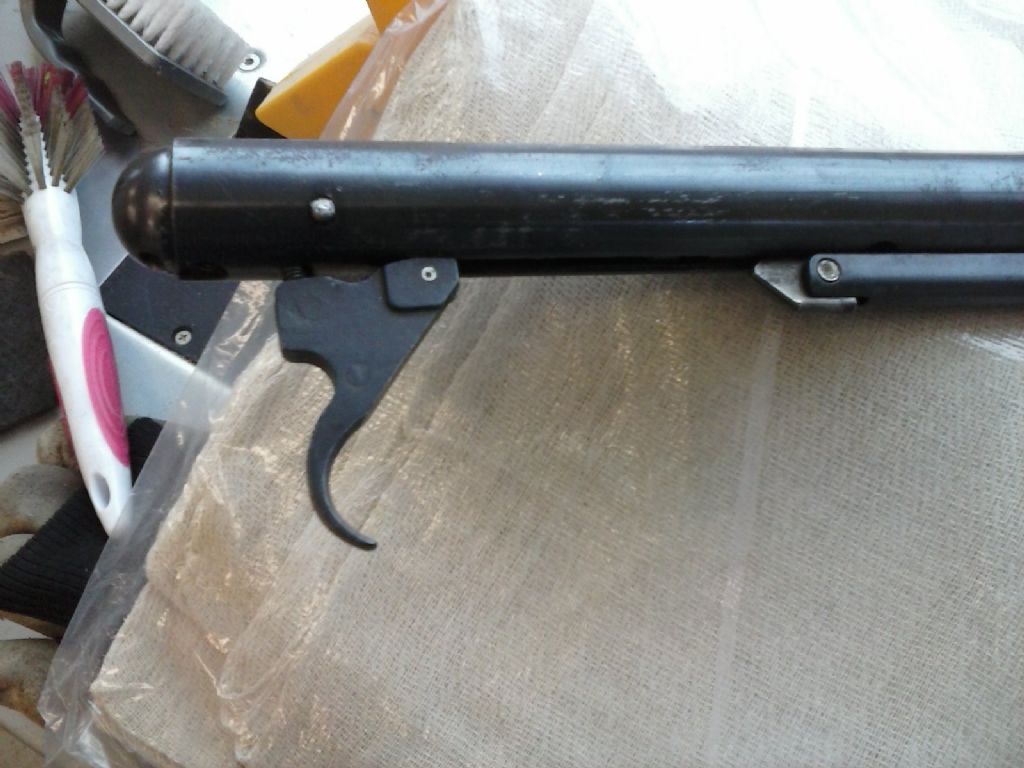

      This is my deceased father's air rifle.. donkeys years old and originally from former Czechoslovakia.
      The problem is that the trigger will slip unpredictably from the cocked position and obviously that's unsafe and unusable.

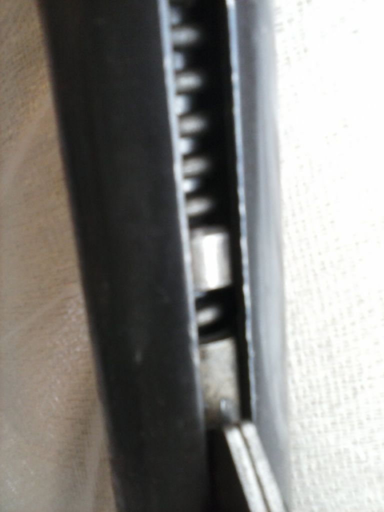

      I'm guessing that it's worn and needs a bit of a notch or greater angle filing/grinding behind the point that holds against the round block on the spring (whatever that's called). And it's pretty hard material making little impression with a small round needle file in situ. So again I'm guessing it's goimg to need the rivet drilling out to take the trigger unit off for access.
      But I'd appreciate the opinion of folk into such things before 'winging' it..

            The rounded off bit on the trigger that holds the piston cocked is the sear. It can be worked on to give a more positive safe lock when cocked but usually needs a bit of experience to make it a safe useable progressive firer, What make is it ? because there's a surprising amount of spares for loads of older rifles about and you might find a replacement trigger unit is readily available which would save a lot of hassle.

                  2nd piccy down take a file to the sear that's holding the piston back on that edge and polish up. Can see a slight radius.
                  When its cocked you want the angle a tad over 90 degrees so will be undercutting. Check the return spring as well. If too hard reduce the angle.
                  Fairly sure its Hungarian though CZ/Brno use similar primitive triggers on centrefires.

                    If you mean the beak tip of the trigger then filing that was my first thought. But the metal is pretty tough and i don't think I can do a neat job in situ; there's no way to mount it all and be able to lean on it nicely. I had thought of filing out the rivet it pivots on and removig the trigger to reface it on the side of my wet grinder, pop in a temporary bolt where the rivet was for testing etc and the replace rivet when correct?
                    If I push the trigger against the cockign mechanism then it holds.. so the other thought was that the tiny return spring at the back of the trigger might be a bit weak but I do realsie that a tough or sticky release will affect usage.

                      Posted by pgk pgk on 17/01/2015 07:59:32:
                      • Diamond coated needle files are very effective, and [these days] readily available cheaply.
                      • A final polish with a 'Diamond Hone' should remove any filing marks.
                      • Obviously better avoid trying to do the job in situ.

                          I'm reluctant to offer advice on guns , even just an air-rifle, but- it looks as if the sear bit, on the trigger is detachable. Why not take it of and clean up, or make a new one from gauge plate ? If it was mine I would try file, as said a diamond file is good for this.

                            If the sear is worn, the piston engagement is probably worn too.

                                      The sears are not that hard on these and CZ's, easy to file in relation to pivot point arc. No need for a diamond which wont leave file marks that's for hard stuff also no need to take top sear out, l leave it in 2 min job.
                                      Plenty to hold on to in a decent vice just look what your doing, work clean and try often.

                                        It's done.
                                        The 'rivet' turned out not to be.. I gave it a modest tap with a drift and it's just a press fit from one side to the tight side. Some careful filing and it's staying cocked albeit the pull to discharge if anythign is a bit heavy..but that's the safe side and its hard to make a real judgement for this amateur without replacing the stock.. and some screws have gone missing so I need to dig about in my assortments to find some. At least they're standard metric threads so easy to source if I'm out of stock for that size (i had some that were too short)
