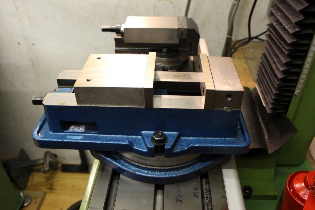

      My current vice, I think its a Warco one, but looks like this
      Its about 80mm wide jaw but only opens to 63mm which I am finding is not enough.
      I think a 6" vice may be too big?? so am looking for a 5" one, however there don't seem to be many around. For info the table size of my mill is 630 x 150mm, here is a photo with my existing vice on it
      Apart from the lack of jaw opening I am happy with the vice and like the fact it can be swivelled and has a proper handle. Soba do a 5" version but no one seems to sell one
      Budget is around £150
      So, would 6" be too big and what about 5" ones, any advice

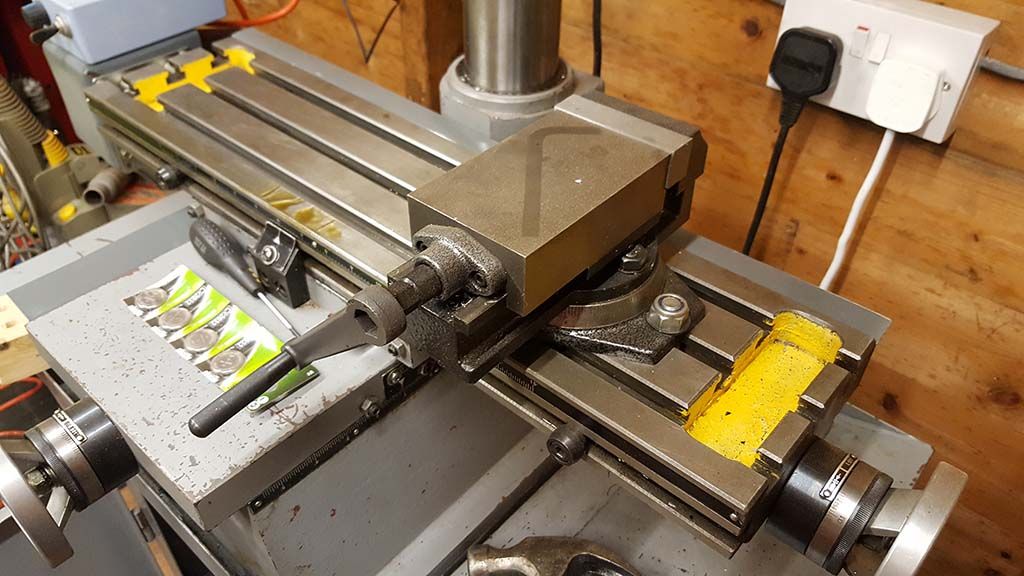

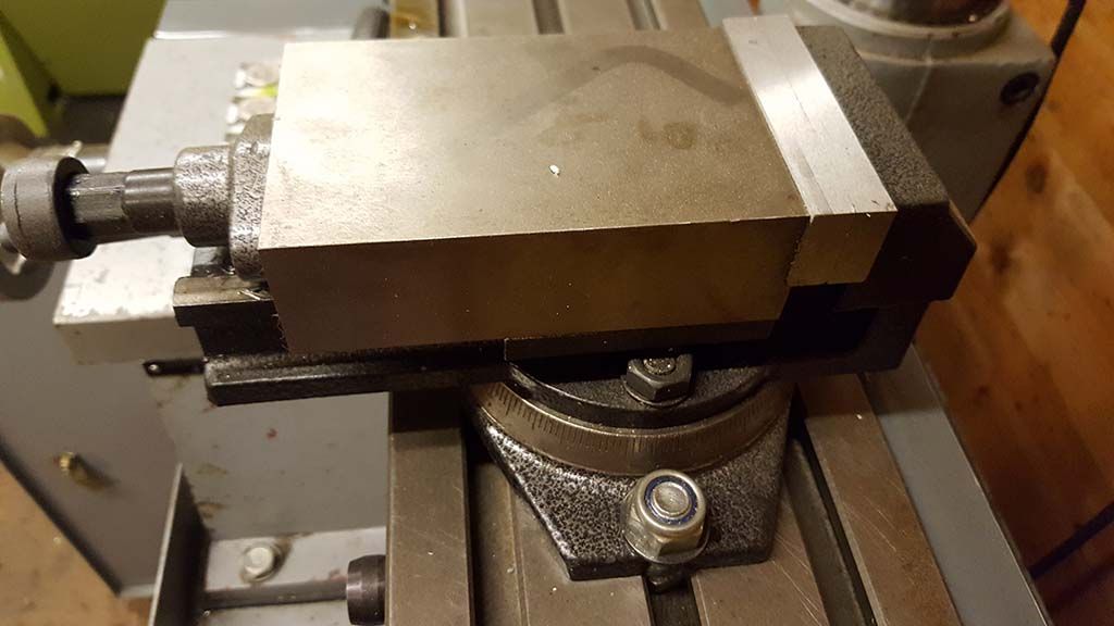

                  Nicholas Farr
                    @nicholasfarr14254
                    Hi, this is the biggest one I can get on my Chester mill, it takes up virtually all of my 630 x150mm table, but it was a freebie.
                    It held this 75mm cube OK with a bit more jaw opening to spare.
                    It may be a bit OTT, but when I use it, I don't need the rest of the table, so I don't find mounting the vice this way round a problem.
                    Regards Nick.

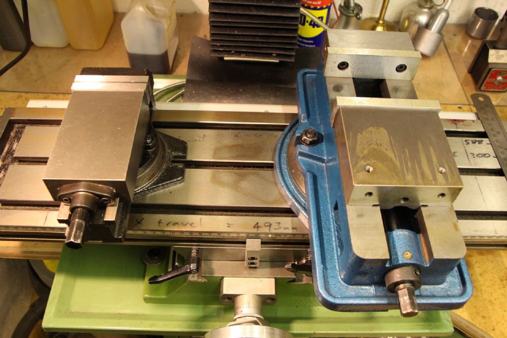

                          Tony Marshall
                            @tonymarshall12301
                            Just took delivery of a 4" vice from Arc Euro Trade to replace the one I bought with my Warco WM16 a few years ago. Here are the two side by side.
                            In this orientation, there is considerable overhang at the rear limiting the Y travel. This is compensated for, to some extent, by the fixed jaw being further back than my old one.
                            Without the swivel base the jaws are about 122mm above the table; removing the base bring the new one down 30mm to about the same height as the old one.
                            Seems ok so far.
                            Cheers, Tony

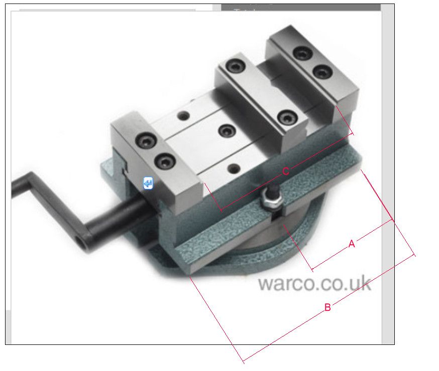

                                Posted by Graeme W on 20/01/2017 20:46:09:
                                +1 for the DH1 from Warco, I've had one for several years now and it is the one I use more than any other (and I have several!) The capacity of this vice is far greater than it's physical footprint would suggest.
                                Graeme,
                                I find Warco's dimensions of this vice somewhat confusing, could you tell me what dimensions A, B, and C are in the photo please?

                                          I've never liked the idea of using a vice that dwarfs the machine. I made this one about ten years ago. It has 75 mm jaw width and just over 80 mm opening. No swivel but the sides are easy to use with a square and protractor against the edge of the table to set any angle.
                                          I based it loosely on the design here. If I need to work on anything that won't fit I clamp it directly to the table.
                                          Russell.

                                                    petro1head
                                                      @petro1head
                                                      Posted by Gary Wooding on 21/01/2017 07:36:22:
                                                      Graeme,
                                                      Looking at the Warco site my interpretation is:
                                                      A = 87.5mm B = 175mm and C = good question
                                                      I have emailed Warco for clarification or maybe someone on here who has one could confirm the dimension please
                                                      Edited By petro1head on 21/01/2017 11:54:06
