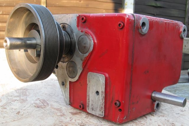

      The lower gearbox on my AEW Horizon Milling Machine is "sealed for life" with no drain or level plugs. The oil seal on the input shaft has failed allowing most of the lubricant to escape. I have replaced the oil seal.
      I have the correct semi fluid grease to refill the gearbox, but the question is how much fluid should I put in? There is nothing in the manual about this. There is no dip stick or sight window. My own idea is to fill it so that the gears on the lower shaft just dip into the fluid. It will then be distributed round the teeth of the mating gears and flung around the inside of the box by centrifiugal force. This level will be below the oil seals.
      Anyone know better or have a better idea?

          I don't know your machine, but some observations from a lubrication perspective:-
          Do you know why/how the seal failed? Pick-up on shaft; blown out perhaps by pressure build up in the box which might suggest initial overfilling leading to excessive churning & heat build-up? etc.
          Is it likely that this is the first time the box has been opened from new? In which case the quantity that ran out was – probably – meant to be there (yes, OEMs don't always get it right, but usually do).
          The semi-fluid grease (NLGI 00?) should have the consistancy of custard and should slump down to a level-ish surface.
          The "scoop & throw" action of the lower teeth will create a trough that should fill itself quite quickly, but the level will sink until the rate of dropping-back from the interior surfaces equals the rate of picking up. For this reason, I would not be happy about the new level being only at the bottom of the teeth. In operating steady-state conditions that's OK, but at a standstill, it should be higher.
          With a new seal – if it's a lip seal, lubricate it before fitting – and a good shaft surface running concentrically, there is no reason why the new level should not be at least up to the seal.
          But, no shaft should be running submerged and it's not good practice to have rolling-element bearings anything like fully packed: they will overheat and could cause a seal blow-out in an un-vented box…..

                  Shell Tivela Compound A was unique at the time of its introduction. Its synthetic nature and specific chemistry was designed to overcome leakage problems & top-up requirements common at the time, by separating into its metallic soap base & synthetic fluid components in the early stages of use. Effectively, the soap was flung around the inside of the housing where it provided an effective sealing function and the lubrication was handled by the fluid. It was so effective that at least one major industrial gearbox OEM redesigned its gearbox casings to remove the top-up & drain facility.
                  It should not be used in a box that has been run on mineral oil-based lubricants without thorough cleaning and care also when refilling. It should not be allowed to come into contact with conventional oil-based paints (epoxy is fine).
                  I do not know the Morris product, but do satisfy yourself that their proposal works in the same way
                  Your description makes me wonder whether a previous owner didn't understand what he was dealing with. A lid-off inspection might suggest that there was insufficient lubricant – as much of the initial fill would be semi-solid on the casing – and topped up with a mineral product, hence the lumps. If he also noticed a leak (due to shaft wear) and replaced the seal with one of a non-compatible material, that could explain the hardening and aggravation of the wear and the leak. Note that a certain amount of oil bleed can take place in storage or inactivity, but this will re-combine in use.
                  With what we know now, I suggest the following are advisable: 1. clean the box & its internals to the best standard that you can manage; old/new or mixed chemistry is not a good idea; 2. use 100% of whatever product you choose, but do stick to the same behavioural type as already described; 3. change ALL the seals and ensure that the supplier is aware of the product with which they will be in contact.
                  I have sent you a PM.

                      I think I've found the answer to this one. I've obtained the parts list for the machine and this shows a sight glass half way up the side of the box. My box has no sight glass and no boring in the case for it. The question is, was the sight glass ftted to early models and ommitted form later models or vice versa? I suppose it's possible early models used gear oil and were fitted with a sight glass so that the level could be checked. When a change was made to "Compound A" the boxes were considered sealed for life and a sight glass was no longer needed. Filling the box up to the half way mark will result in the lower two shafs and bearings being submerged. Sorry I can't use paragrphs in my post, but this forum doesn't recognise the CR Key. Max.

                                      The lubricant which is adhering to the inner surfaces of the gearbox appears to be of the same consistency as the lubricant in the "sump". It shows no signs of moving due to gravity and is in a layer about 3mm thick on all surfaces. I think it has found its way on to the surfaces, not because it's been flung off rotating gears, but because I stood the box on each end in turn to allow lubricant to flow into the bearings and "prime" them.
                                      Attached is an end view of the gearbox. The shaft protruding from the RHS connects to the gear selection lever. The three step pulley is on the output shaft. The lowermost blanking plug shows the position of the input shaft and the uppermost blanking plug shows the position of the intermediate shaft. Were a sight glass fitted it would show the lubricant level as being up to the lower edge of the upper blanking plug.
                                      The pinion on the input shaft is barely bigger than the input shaft itself. At present the lubricant level is such that the input shaft is not submerged, so the teeth of the pinion barely dip into the lubricant. The pinion is in permanent mesh with a large gear on the intermediate shaft. Neither the pinion or the large gear mesh with any other gears.
                                      The intermediate shaft also carries a cluster of three gears which can slide along it to mesh with three matching gears on the output shaft. None of these gears dip into the lubricant at present.
                                      I'm now convinced that the lubricant level should be as shown by the missing sight glass. This will mean that the input shaft is submerged. The intermediate and output shafts will not be submerged, but all of the gears on them will be about 1/3rd submerged. This means that much more lubricant will be thrown about inside the box due to centrifugal force.

                                        Clear. The rotation & lubricant transfer between the constant mesh pinion & the intermediate shaft gear is of little help in lubricating the change gear pairs. To achieve that the fluid level, in steady-state running conditions, should reach the lowest teeth of the highest-positioned gear pair, plus a bit to allow for the fluid that's flying about at the time. Which sounds like the level you are considering. A
