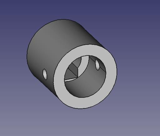

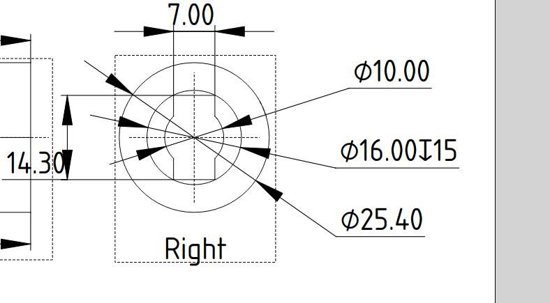

      I've modelled a coupler in FreeCAD and am experimenting with the TechDraw workbench. TechDraw renders a 3D model into 2D drawings to various standards and projections, as chosen by the user. I chose Third Angle ISO.
      TechDraw doesn't add dimensions automatically. Instead the designer clicks on what he wants dimensioned, and dimension leaders arrows and whatnot are added.
      My problem isn't specifically FreeCAD: it's what's the best way of dimensioning a 2D drawing when lots of dimensions cluster together? My example:
      The drawing is quite cluttered and there's not much room to manoeuvrer. The three diameters on the right are perilously close to edge of the paper. The Right View of the coupler is full of arrows and it's vertical dimension overlaps the clipped off drawing of the Front View on the left.
      Messier than I like, and it would be worse if I turned on the hidden lines showing the threaded holes. Is there a better way of organising dimensions? I have several Technical Drawing Books but their examples are all too simple.

          I'd create a cross-section and dimension the diameters on that. If they're external turned dimensions, then a side view would be used to put them on. The 7,00 dim you have would be best in the right view as you have it.

            Having completed all my working life draughting in one way or another I understand where you are coming from.
            One way is to create more views, adding diameter dimensions to a section view can be clearer to the reader. Looking at your view one thing I would do is reduce the arrow head size slightly, they look about 5mm, reduce down to 4 or 3, and maybe the test size. Whist standards may dictate the size in a working environment if it is just for hobby use you can reduce things so long as you can read it. Standards were mainly created so drawings could be digitised in one way or another, microfilm needed a good original drawing to be readable.

              Reduce text & arrow size. See if your CAD will dispense with the arrows on the other side of circles.

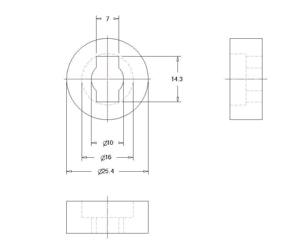

                  I'm not keen on showing diameters with the diagonal lines at all sorts of angles, I prefer to select "linear" dimensions for diameters which puts them as shown.
                  Does the program not allow you to space the elevations further apart? Alibre does and I can also alter text and arrow size and style.

                      Does your system allow viewports? If so you can have dimension parameters to suit the paper size, but scale up the item. It's easier to put dimensions on something drawn twice full size. Once you've got the dimension parameters as you want them, save it as a template, or even as a blank drawing so you don't have to do it again.

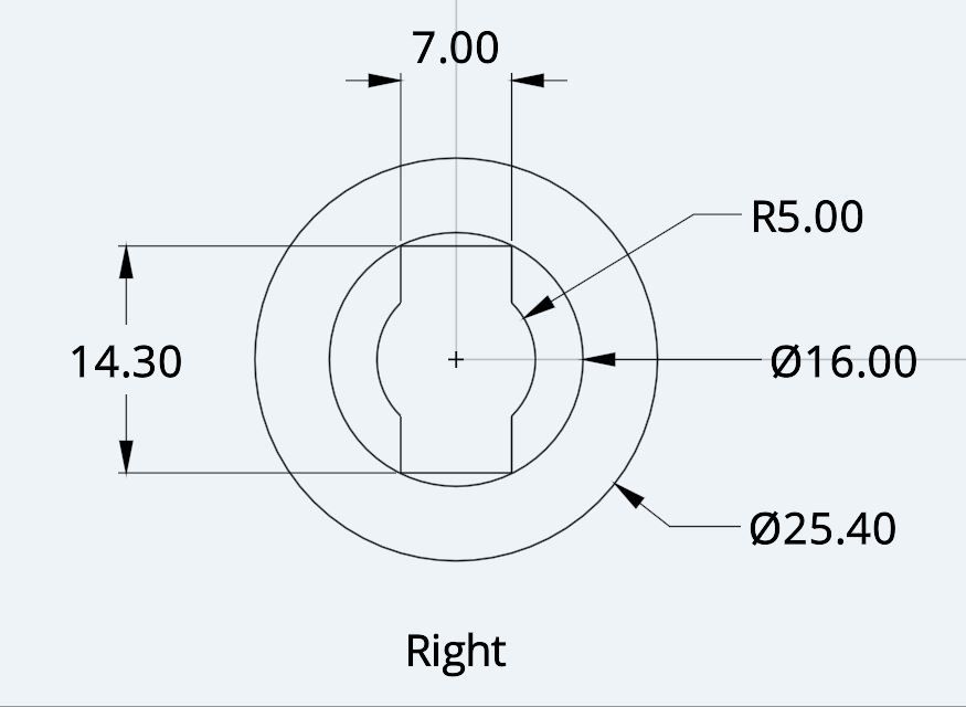

                          I think a radius is used to dimension arcs, rather than circles.
                          #590836
                            Yes I was not saying I don't likethings dimensioned by radius when it's a full circle (which I don't), its the way the diameter is dimension, I don't like that angled lines with the dimension at the end
                            #590838

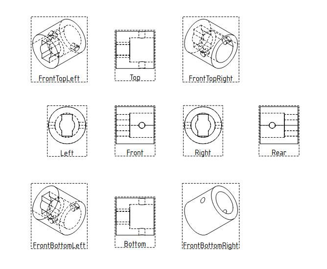

                                                    My dimension question came up during an excursion into 3D printing, and I've been distracted by a USB cabling problem, still unsolved.
                                                    Many thanks for the help and observations, all much appreciated. It's been underlined to me that producing good drawings is a mixture of art and science. Science does an excellent job of the geometry and correct drawings, but making clear to a human needs intelligence!
                                                    The Coupler is modelled in 3D with a Pad and 3 pockets, 4 simple sketches total. The sketches make perfect sense to the CAD package, but not in a workshop. Though the rendered object gives a good idea of the shape and how it might be machined, it's not dimensioned.
                                                    3D printing is easy enough because the CAD model contains all the information needed to create the shape. Ditto CNC. For strength I need to make the coupler in Aluminium or Mild-steel, and I only have manual machines. Proper 2D Technical Drawings are needed.
                                                    Here's the range of 2D plans and projections FreeCAD (and most other modellers can generate):
                                                    coupletechdraw.jpg Unwise to print all of them with internal detail, centre-lines, dimensions, tolerances, labels, sections and balloons etc. In this case, I think the coupler can be completely described by the Front, Top, and Right Views, and it's helpful to add the Front Top Left and Front Top Right isomeric projections. A simple text description bottom right is needed: Title, Date, Name, dims in mm, material=Aluminium, Third Angle etc
                                                    I'm taken by JA's "More Paper" suggestion. I can only print A4 at home, so one page for the general arrangement plus a page each for the individual views, as necessary to remove clutter.
                                                    Otherwise, I'm going to experiment with the other suggestions, like Jason getting rid of angled arrows by using linear dimensions instead. Watch this space!
