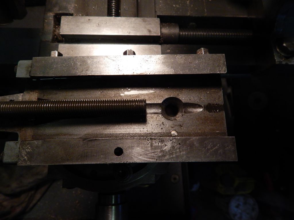

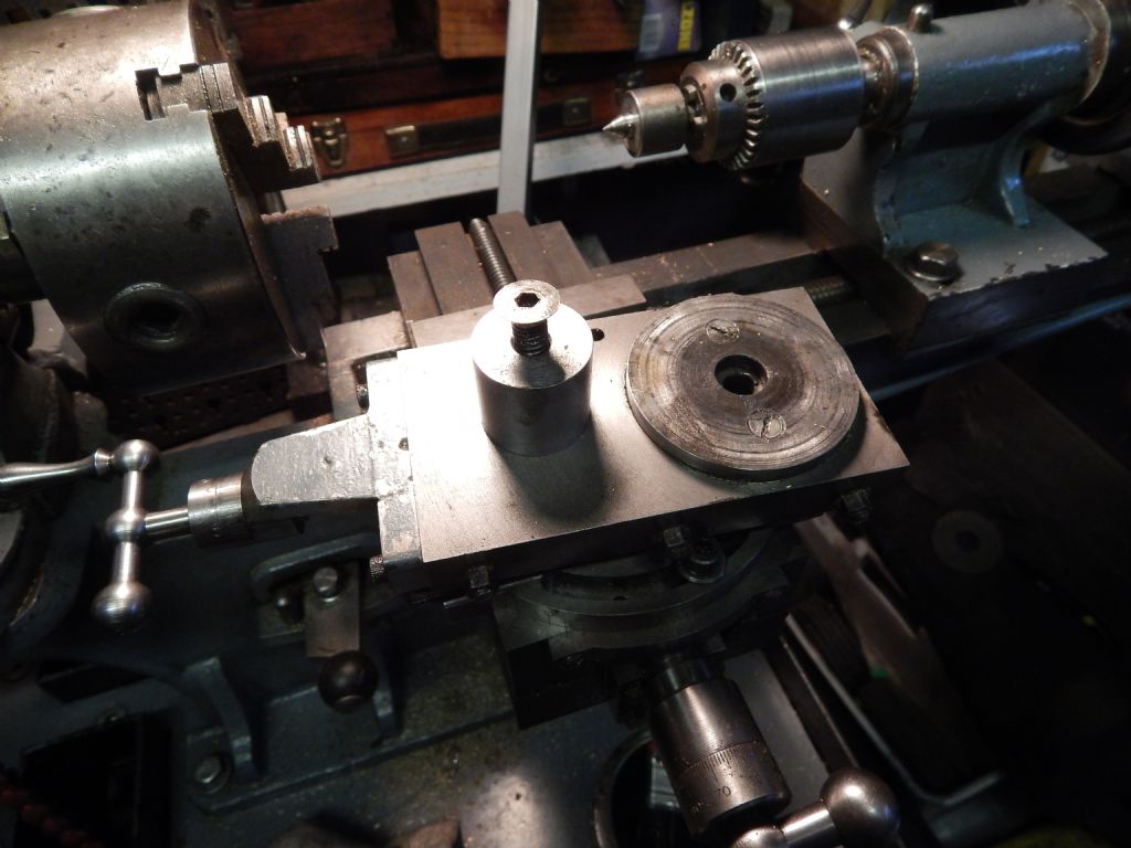

            Martin Newbold
              @martinnewbold
              My lathe has a ML7 saddle so thinking need something nce i didnt like the modern 7/8" bolt on types and have no idea if its just Dickson who made them with a larger dia hole. As its possible on this to use th countersunk allan bolt to bolt on a larger dia holder as my existing toolpost uses an inch centre which i presume is much more solid
              bolted on sextion with Allan Bolt
              Under saddle a countersunk hole
              Edited By Martin Newbold on 30/06/2016 19:24:26

                          Just to be pedantic, my Myford ML7 Cross Slide had a 7/16" BSF threaded post for either the clamp or the 4 way toolpost.
                          Being a fully paid up Luddite, on my "new" larger lathe, I still use a 4 way, (Actually 2, since I made one for the back of the Cross Slide, so have 6 tools set to my centre height gauge. Not enough, since one has to be removed for knurling, or using the 2mm parting tool instead of the 3/32 in the Back Tool post ).
                          The reason for not going to a QCTP is purely lack of space to store all the toolholders, (I work in the inspiration for Rubik's Cube!).

                            Hi Howard do you have any pictures on how the ML7 post mounts to the cross slide mount mine has a countersunk screw hole on the underside of it . It might be arlier than yours
                            Cheers

                                            The T.00M is the usual fitment on a Myford, a T.0 will be too big and the T1 bigger still.
                                            Sizes here
                                            As yours is a bit of a Heinz lathe you will need to take some measurements to work out the best height toolpost or whether to use a smaller one with packing plate.
                                            Edited By JasonB on 01/07/2016 09:33:53

                                              I agree with JasonB, your lathe is a Heinze lathe, the topslide may well be partly ML7, ie the rotating base, but the leadscrew and dials and the top casting seem rather different
                                              #244946
