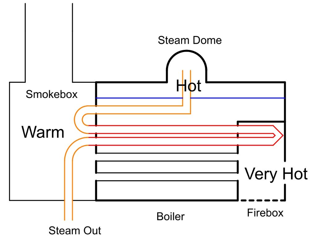

                              #283145
                                Posted by Hopper on 08/02/2017 00:16:45:
                                Posted by fizzy on 06/02/2017 17:21:36:
                                . It dawned on me that it might actually be cooling the steam instead of heating it!
                                Fizz, what makes you think the superheater would be cooling the steam? Is this even possible?
                                From the comfort of my armchair, I would say it's very possible that a superheater might be ineffective, particularly so in a small boiler.
                                Consider this diagram of Duffer's Patent Boiler, a design bursting with possibilities.
                                How does it work? The fire is very hot. Heat from the fire boils the water, and efficiency is lifted by passing combustion gases to the chimney through the boiler, giving it more time to extract heat.
                                Steam gathers in the steam dome at the top of the boiler . The temperature here is much lower than that in the firebox.
                                Steam is collected from the dome and taken out of the boiler into an even cooler smokebox. Here it loses some heat. As steam passes down the superheater tube towards the firebox it is reheated by the boiler, but only to a maximum of steam dome temperature. It might be less.
                                In the firebox the steam passing through the superheater is potentially made very hot, but this depends on how long it stays in the firebox. The hot part of the superheater might not be very effective.
                                Unfortunately, to get to the cylinders the steam passes back through the boiler again. As the boiler is much cooler than the firebox, the steam loses heat to the boiler. If the tube is long enough, all the superheat will be lost.
                                The steam still has to get to the cylinder. As this involves a journey through the cool smokebox yet more heat will disappear.
                                I think getting a superheater to work in a small boiler could be quite a challenge, and congratulate fizzy for wanting to check his work.
                                Hope this is sensible, believe it or not I've been known to get things wrong…
                                Edited By SillyOldDuffer on 08/02/2017 18:51:00

                                  #283205
                                  duncan webster 1
                                    @duncanwebster1
                                    SoD's drawing shows the superheater tubes in contact with boiler water, which is wrong. There is a big flue (or flues), typically 1" or so running from firebox to smokebox, and the steam pipes (known as elements) run down this flue, so no contact between elements and water in this area. The flue gas is always hotter than the boiler water, so whilst you might not get a lot of heat transfer from the flue gas to the elements within the flues, what there is will tend to heat the steam, not cool it. And before everyone jumps down my throat, the flow conditions in models means that the flue gas flow is likely to be laminar, not turbulent as in full size, which is why heat transfer in the tubes is less effective, which is why models tend to use radiant superheaters
                                    #283207
                                    JA
                                      @ja
                                      Posted by Neil Wyatt on 08/02/2017 20:06:23:
                                      I realise it would be impractical in most boilers, but the best arrangement would be to have the 'in' and 'out' superheater tubes in separate boiler tubes.
                                      Have the out tube in the hottest part of the boiler, not the smoke box. Perhaps this is why superheating did not always give the expected efficiency on railway locomotives a hundred or so years ago.
                                      I think Dave is right.
                                      JA
                                      #283218
                                      Hopper
                                        @hopper
                                        I'd have to agree with what Duncan said. Flue gasses are going to be hotter than the boiler water due to incomplete heat transfer from the former to the latter in a single pass arrangment. So if the superheater tubes are smaller diameter than the boiler firetubes, and ideally not touching them, they will be heated by the flue gasses to higher than the water temp. I'd be really surprised if a properly constructed superheater could lower the steam temp. But have no idea what the OP's arrangement is.
                                        If nothing else, a set up like SOD's "bursting with possibilities" laugh arrangement would provide a steam drier if not superheater, which would still improve performance by adding latent heat which could do extra useable work in a steam engine, even though steam temp might not be raised significantly.
