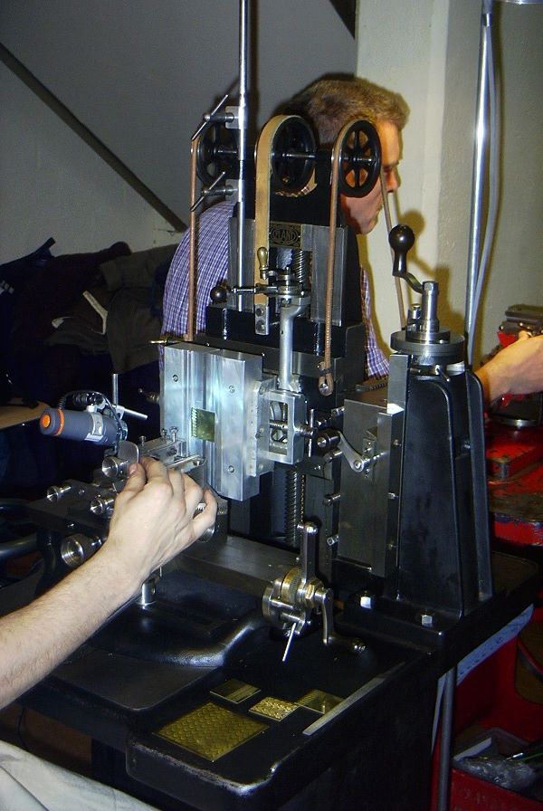

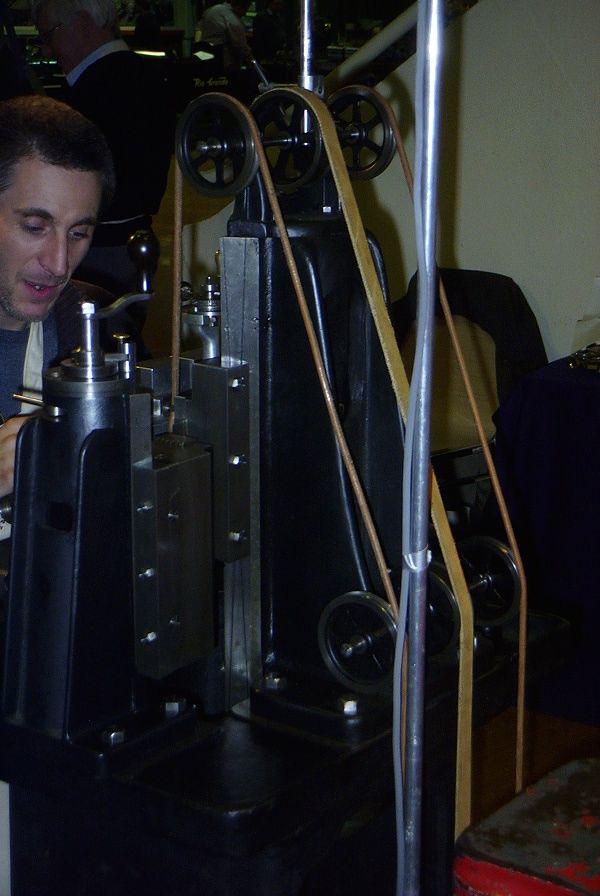

        #563702
        Bazyle
          @bazyle
          There was one on the ornamental Turners stand at Sandown 2012.
          Of course it doesn't have to be vertical so a temporary fitting for a manual shaper might be enough.
