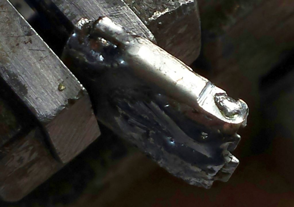

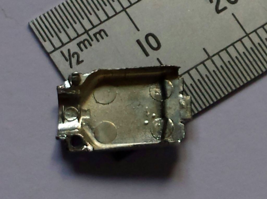

      Not really an electrical connector but a Micro HDMI plug on the end of a lead for 'camera to monitor' cable. (Its about the same size as a micro USB on a phone)
      The cable is supplied with moulded on plugs and I cut off the outer moulding to investigate shortening the connector because with the camera mounted in its special housing there was insufficient room for this straight plug.
      Other connectors of this type usually have a sheet metal folded cover, this one though has two small diecast parts forming a clamshell arrangement. What surprised me though was that the two halves had been soft soldered together, The diecast metal had a whiter than usual appearance so I initially thought it might be tin plated.
      The biggest surprise though is that whilst it is plated (layer of copper underneath) the base metal itself solders as easily with 60/40 as any normal electronic component!
      In the bottom picture you can see where I have filed away a small area then heated it with soldering iron, the solder wetted the surface instantly.
      Any ideas what the metal might be?
      Just out of interest, the cable wired to this 20 way connector has 6 twisted wire pairs each individually screened, plus a couple of single wires, and all in a diameter of 2.2mm!

            Its not like any Nickel Silver I have seen. I am certain its been cast not (pressed, coined or stamped) and if I break a bit off it has the feel of a Zinc based diecasting and the fractured surface is granular.

              Probably Zamac, or some such zinc/aluminium alloy used for die casting, commonly known as "monkey metal", because of its fondness for falling to pieces after a couple of years, or when stressed beyond its very limited limits! Its great advantage is that it is ridiculously CHEAP!laugh

                Ian said that he's soldered to it – I don't think you can soft solder Zamac.
                A possibility that occurs to me is that the two halves of the housing have been electro-formed rather than cast.

                    Electro-formed I'm not sure about but I assume its different to electro depositing. I do not think either are applicable to this part though.
                    I am sure its some sort of casting process in a die, its the easy solderability of the base metal that intrigues me. Its definitely not like any Mazak or Zamak that I have ever come across. The cable is a supposedly better quality than cheap imported ones (but its still imported from China!) and it is a mass produced item.

                              The extreme RH end in the second picture, where I filed a step to expose the underlying metal has the blob of solder stuck to it. Its as white as aluminium.

                                    Ejector pin marks to get it out of the mould suggest it is just a zinc casting.

                                      Are ejector pins unique to zinc castings?

                                          Ejector pins are used on pressure die casting tools as well as zinc casting tools and plastic mould tools.

                                            I'd be surprised if it wasn't AZ91D alloy, die cast. It is a very common alloy used in many electronics enclosures including connector housings all the way to laptop chassis.
                                            No, ejector pins are not unique to zinc die casting, various versions of them are used in virtually all die casting moulds/dies and also injection moulds for all sorts of materials (thermoset plastics, thermoplastics, thermoplastic elastomers/rubber, and waxes.

                                                      Last night I filed through the plated surface (definitely plated because there is layer of copper) and exposed the base material. Later today I will see how easily it tins after being exposed for several hours.
                                                      The casting is what I would call finely detailed, its mostly about 0.30mm thick yet where the two edges of the clamshell meet there is a male/female stepped joint.
                                                      I dismissed the idea of it being Tin because of the cost, also they would not have needed to plate the surface.
                                                      All in all a bit of a mystery.
