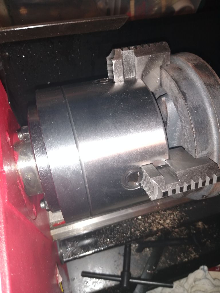

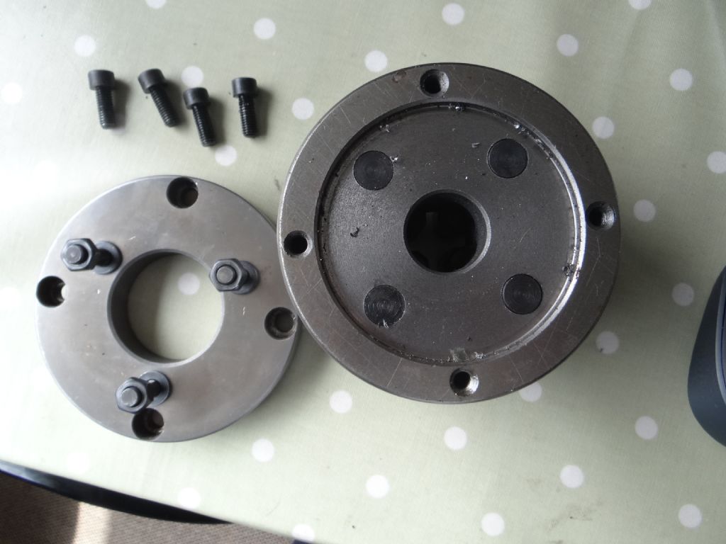

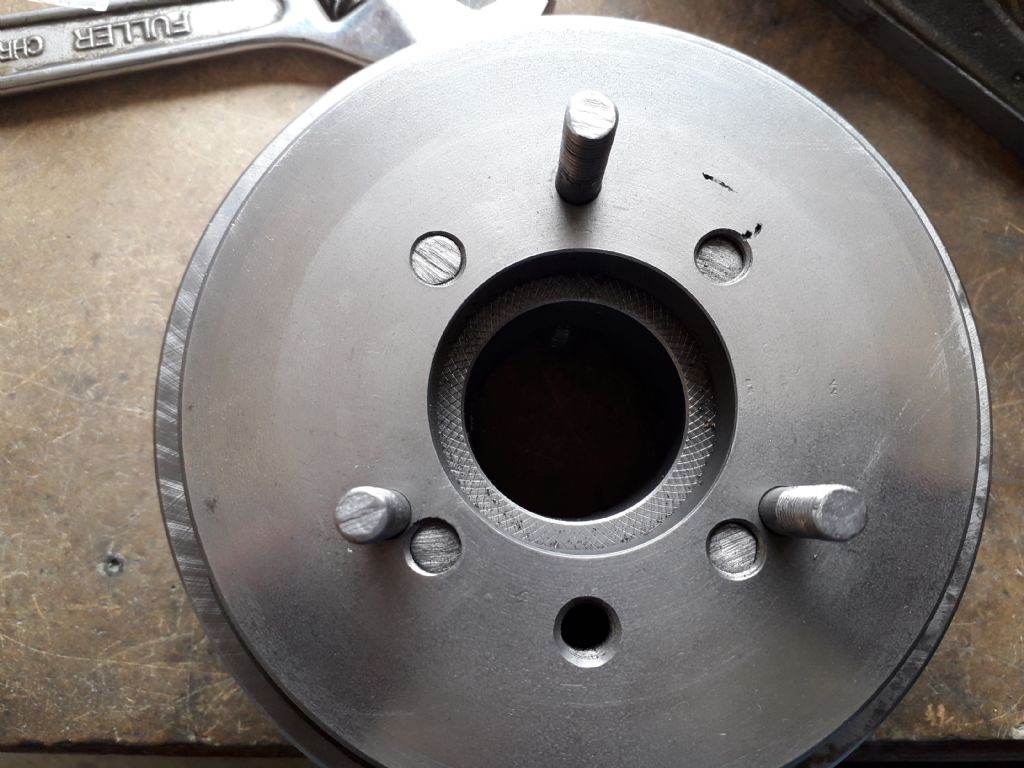

      Hello all. Having got rid of the mini lathe that blew it's motor, I went mad and bought a rather large lathe from Italy. Lathe seems great & pretty accurate for the money. My problem is I want to add a 160mm 4 jaw independent chuck but don't think I'm at the skill level to make my own backplate. All the chucks I can find are either front mounting, or have the 130mm recess I need but have 4 mounting bolts & not 3. Is there a specific chuck I need to look for, or is there an easy way to mount the 130mm recess chucks, like drilling 3 new mounting holes & not using the 4? Cheers

          Hello Arckivio, some more information would be useful, what make is your new lathe, what type if fitting is the spindle, screw on, DIN taper or ???

            It's a CQ9332A. The chuck mount is a 130mm recess with 3 bolts on, I think a 145mm PCD. Thanks
            #413030
              Arckivio
              It would be most unusual to find a four-jaw chuck with three fixing holes
              I think this illustration might help identify what you need: **LINK**
              http://www.boltontools.net/index.php?route=product/product&product_id=2117
              Edit: Although that plate does look a little strange dont know

                Ha. I never came across that because I searched UK only on Google. Even just the backing plate would do me. I also never searched specifically for the code number of my lathe. Don't want to use the brand name . Thanksas this forum has advertisers and they are not one of them lol. Thanks
                    From this I assume the machine spindle has a 130mm register and the chuck backplate has a 130mm recess to mate with this and 3 studs on a 145mm PCD passing through the machine spindle fixing holes ?

                        You can download the manual from the site Michael linked to. As JohnF said it shows the spindle is for direct fit of a 3-jaw. To mount a 4Jaw you need a backplate with 4 holes to it the 4-jaw and 3 tapped holes to take studs or the bolts for mounting to the flange.
                        It should be possible to find a part machined backplate, what part of the world are you in?

                          Thanks for the replies everyone. I was trying to avoid the backplate route but looks like the chuck I want doesn't exist. I have seen backplate blanks so might be easier to start with one of those.

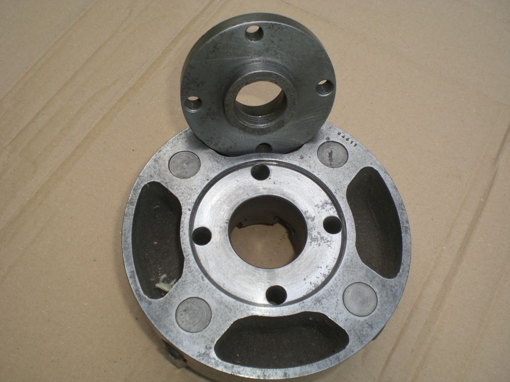

                            For what it's worth, my lathe has a 160mm 4 jaw chuck which uses a backplate with a three hole fixing onto the mandrel.
                            Actually, it's worse than that as the mandrel has a set of 6 tapped holes in it onto which is bolted a chuck adaptor plate. This plate has three holes which allow for a three hole fixing 3 jaw to be directly attached to it. The 4 jaw chuck then uses a 4 hole to 3 hole back plate between the chuck and the adaptor plate. Seems to work ok. And, many years ago, I made an aluminium backplate to enable me to use an 80mm 4 jaw chuck.

                                … Use one of the holes already in the 4 jaw and then drill and tap another 2. In my little head it's a brilliant idea frown
                                I've wondered why bolt-on 3-jaw chucks have 3 bolts and 4-jaw types always have four. I think it's probably done to maintain balance and reduce torsional stress inside the chuck as it rotates. Turning forces are generated inside the chuck by the weight of the chuck body as it spins.  If only 3 fixing points are used the forces may be unbalanced by spinning and also by unequal cutting forces via one of the jaws. I've not attempted to work out how big the forces are, but potentially quite big – trying to stop a freewheeling chuck by hand hurts.
                                If you try a three bolt fixing system can you report back what happens. Three possibilities:
                                • Works with no adverse effects (hurrah!)
                                • Works but finish affected by vibration (Might be acceptable)
                                • The chuck might burst at high-speed. (Tears before bedtime.)
                                Edited By SillyOldDuffer on 09/06/2019 12:00:40

                                  There's always one sad. I understand what you mean by the imbalance and I certainly hadn't thought of that! Wouldn't filling the holes left over with some threaded studding counteract the imbalance created by my new holes? If you're talking about creating an actual weakness, then I know studding wouldn't work and no amount of threadlocking the studs would stop the tears before bedtime!
                                  #413401
                                    Dave it also has something to do with the difficulty of getting 3 holes spaced between the 4 jaws as most 4-jaw chucks are through fixing so you need room for a counterbored hole that does not come too close the the slots for the jaws. The bigger the chuck fixing PCD the less of a problem.
                                    having work off ctr in the 4-jaw will far outweigh any slight balance issues from 3 or 4 fixings.

                                      Google d1-3 flange dimensions, they are very similar. My Myford has a BS4224 fitting, 3 mounting studs. It takes D1-3 chucks with the camlock fittings replaced by threaded studs. I bought these years ago from the old Myford in Nottingham.

                                          I'm not explaining the imbalance very well but picking up on Jason's more practical point about spacing the holes here's a photo of a 4-jaw and its backplate:
                                          Drilling new holes to match may be impossible without damaging the chuck.
                                          Is lack of a pillar drill putting you off making a backplate (assuming one can't be bought)? Using a lathe to drill off-centre holes with a faceplate came up recently. Not as difficult as you think once you know how, especially on a big lathe like yours!

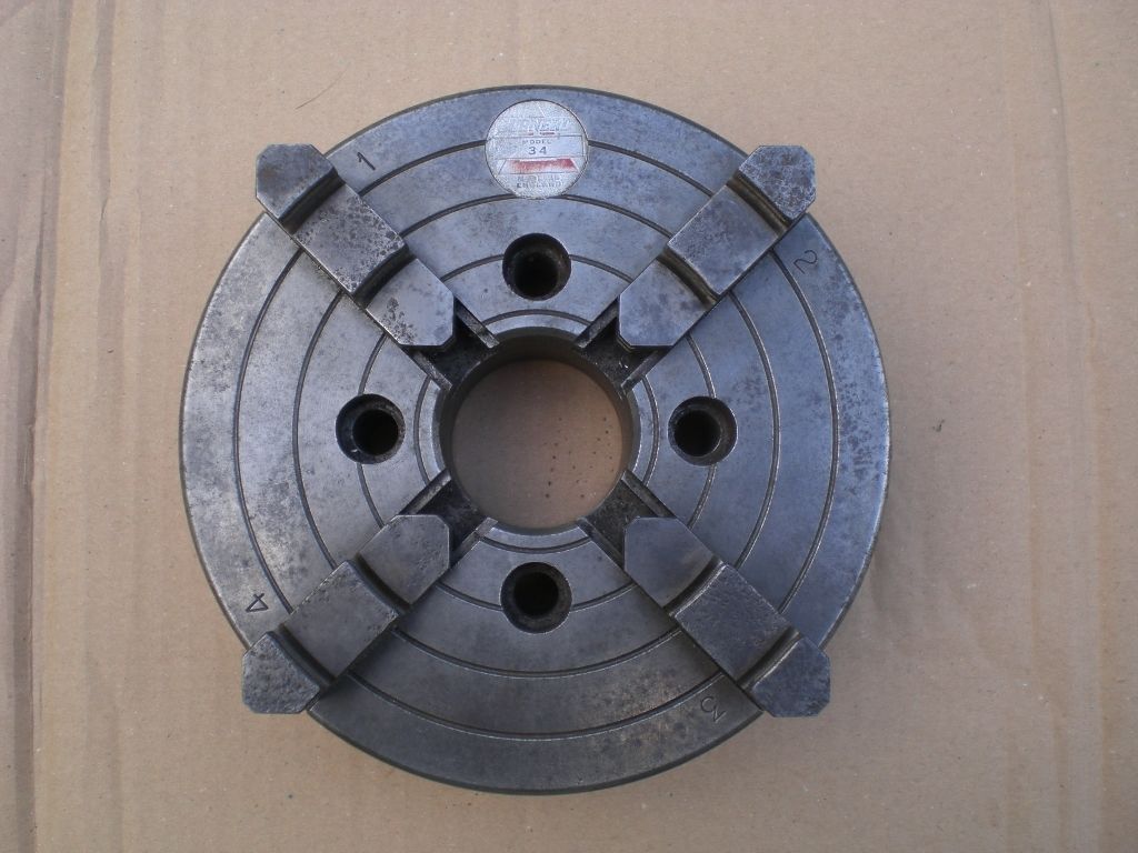

                                              And this is how close the four fixings of a 160mm lightweight 4-jaw chuck come to the 3 flange studs on my lathe, had they been counterbored holes like Dave's they would have clashed.

                                                Posted by JasonB on 09/06/2019 14:44:27:
                                                The PCD of my chuck mandrel is 145mm I think so at least that isn't a problem I'll have.

                                                  Any advice on backplate thickness? I know it has to take the 4 bolts to hold the 4 jaw so it can't be too thin. I reckon an inch might be too thin?
                                                  #413456
                                                    About 15mm.
                                                    What size are the bolts, 1.5 x D should be OK

                                                      The bolts in my chuck mandrel are M8, not sure what the 4 jaw will have as I haven't bought it yet. Thanks for the reply
