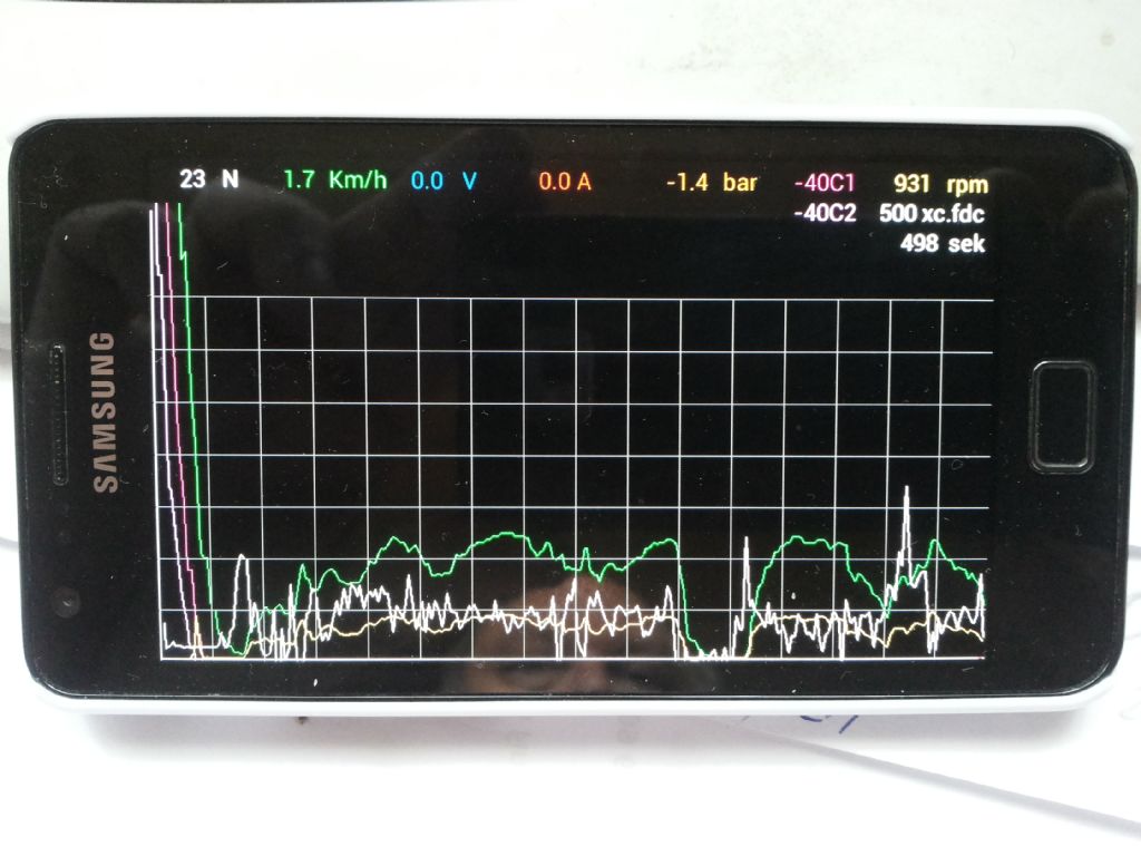

    In between with lot of improvisation I made my first real test with my measurement unit with the dyno and the pulse wheel and so on. There is a picture of the raw data on the quick look display on the phone.

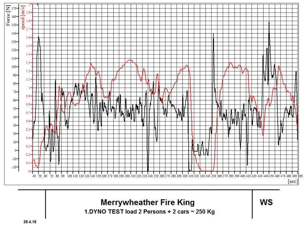

    The green line is speed and the white line is the dyno force. As I know now there is small lash in the coupling bolt and the road surface looked smooth ,but because of pavement it is rough with some noise in the dyno .

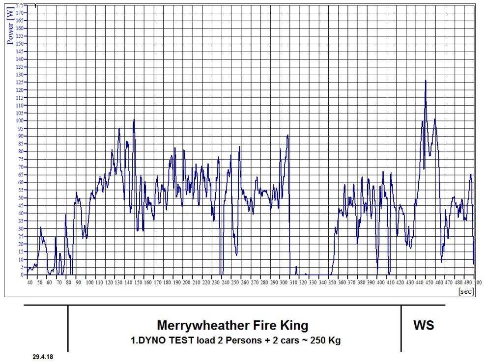

    This chart is the averaged raw data of the dyno and the speed which is calculated from km/h to m/s to calculate the power in Watt. See next chart.
    By the first shot I think it is not bad ,but I have some idea for refinements.
