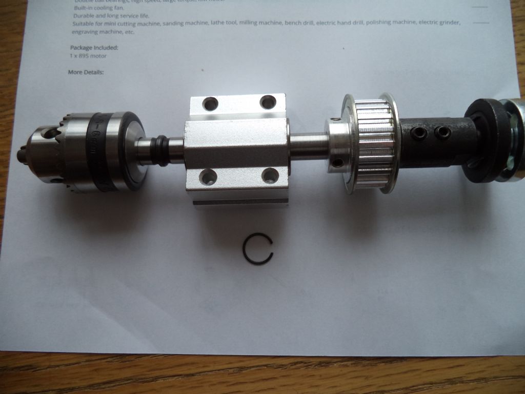

      I bought a spindle and drive belt for a project I'm developing as part of the kit there was a small "C" clip that I can't for the life of me work out where it goes see attached picture, its got something to do with the bearing assembly but that's as much as I can work out there is no obvious place for it to go. Can any one shed a bit of light on this mystery

          I looks as though it should retain a bearing, perhaps the right hand one on the mounting block that doesn't look as though it is fully home.

            I agree, the "C" clip groove might be obscured by the bearing.
            #480416
              I would say it just slips loosly onto the shaft between read bearing and toothed pulley as a crude spacer so the pully boss does not rub against the bearing's outer race. Better to bin it and turn a small spigot onto the pulley boss or make up a thrust washer as position of pulley sets the end float.
              There are usually no grooves in the spindle on these items.

                Hi Brian that was my thoughts but it’s a lose fit on the shaft there’s no groove on the shaft or in the bearings for it to fit the bearings which are flanged are fully home

                  I was thinking it was something to do with end thrust the shaft is a tight fit in the bearings but I cannot see how end thrust when drilling will be restrained I’m intending to use Loctite to fix the bearings better and ditch the clip

                    Hi Stew, maybe the shaft has moved in the bearings one way or the other and there might be a groove hiding under one of them.

                      The clip could not have just dropped off the shaft if that is where it fits.
                      Was the whole thing assembled like that when it arrived ?

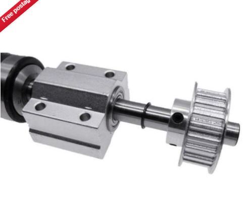

                        To save any more suggestions If you look at the many of these on e-bay etc none have grooves but all have the ring
                        Stew I would say that the larger dia at the base of the chuck taper should go against one bearing to take the drilling pressure and the pulley slid up to take out and play.

                          #480457
                            Found itsmiley From the same set of images to the ones I posted above

                              I think Jason is correct its just a crude spacer to go between spacer and pulley to take some of the thrust, as for the other end I'm going to fit a sleeve between the slightly larger collar diameter and the bearing locating on the inner race this should take up the thrust, I'm unsure wether to fit another spacer between the two bearing again on the inner race so that they share the thrust. I want to see just what duty these spindle will do, there's a few videos of them in use doing light work.

                                If they are flanged bearings then if you attempt to apply end load to the one at the pulley end won't it just be pushed out of its housing?

                                  The clip appears to be a simple spacer, rotating with the shaft/pulley/inner race to crudely prevent the pulley bearing on the outer race. As those components are all totating at the rame speed there should not be a problem. A small diameter washer would suffice just as well.
                                  Are both bearings properly designed to accept axial thrust, I wonder?
