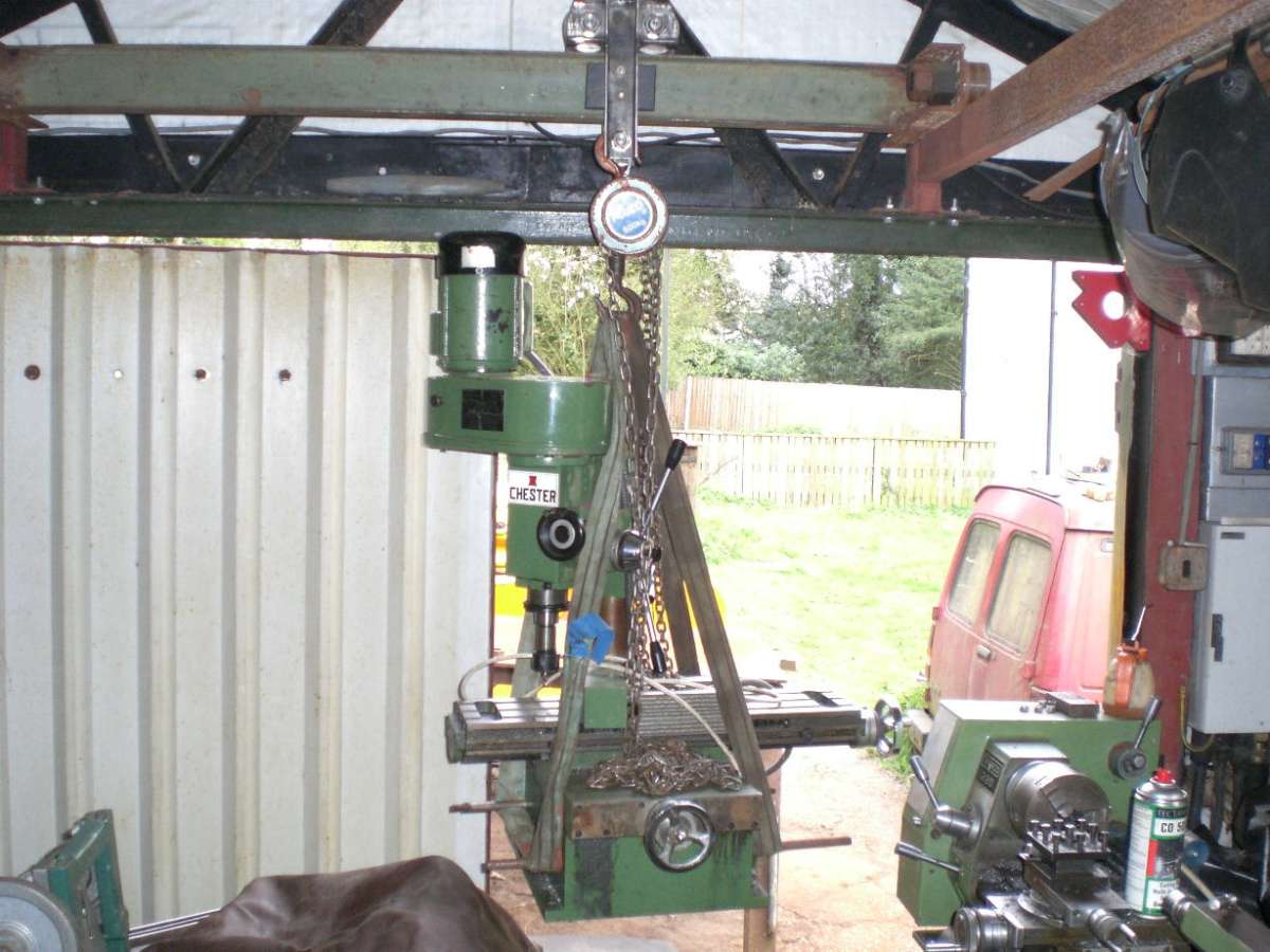

                        I equipped my workshop – which is admittedly cramped – with a simple travelling-crane.
                        The crab holds an ordinary chain-block hung on a bar itself intended alternatively as a potential fixed axle for the top sheaves of a multi-fall block-and-tackle. One reason for this option is to avoid chains banging against delicate surfaces like fittings and paintwork on a miniature engine.
                        It reaches most of the workshop area, with a little manipulating of the load occasionally where close to the travel limits or a partial obstruction like the head of the milling-machine.
                        It can place the hefty chucks for the Harrison L5 lathe almost to the mandrel nose.
                        As a “helping-hand” on the band-saw or bench-drill, it is ideal. Indeed, its first ever task was supporting a two-foot square of thick steel plate for drilling (for a special bench-top)!
                        All “hand-raulic” – no over-thinking about motors, bits of studding in drill-chucks or hydraulics. Maintenance is just an occasional spot of oil on the axle journals and horn-plates.
                        No floor area lost to great lumps of trolley.
                        (The long-travel axles run in cast-iron blocks between steel horns, controlled by rubber pads. This modicum of suspension keeps all four wheels in contact with the rails, on what is effectively a six-foot gauge bogie.)

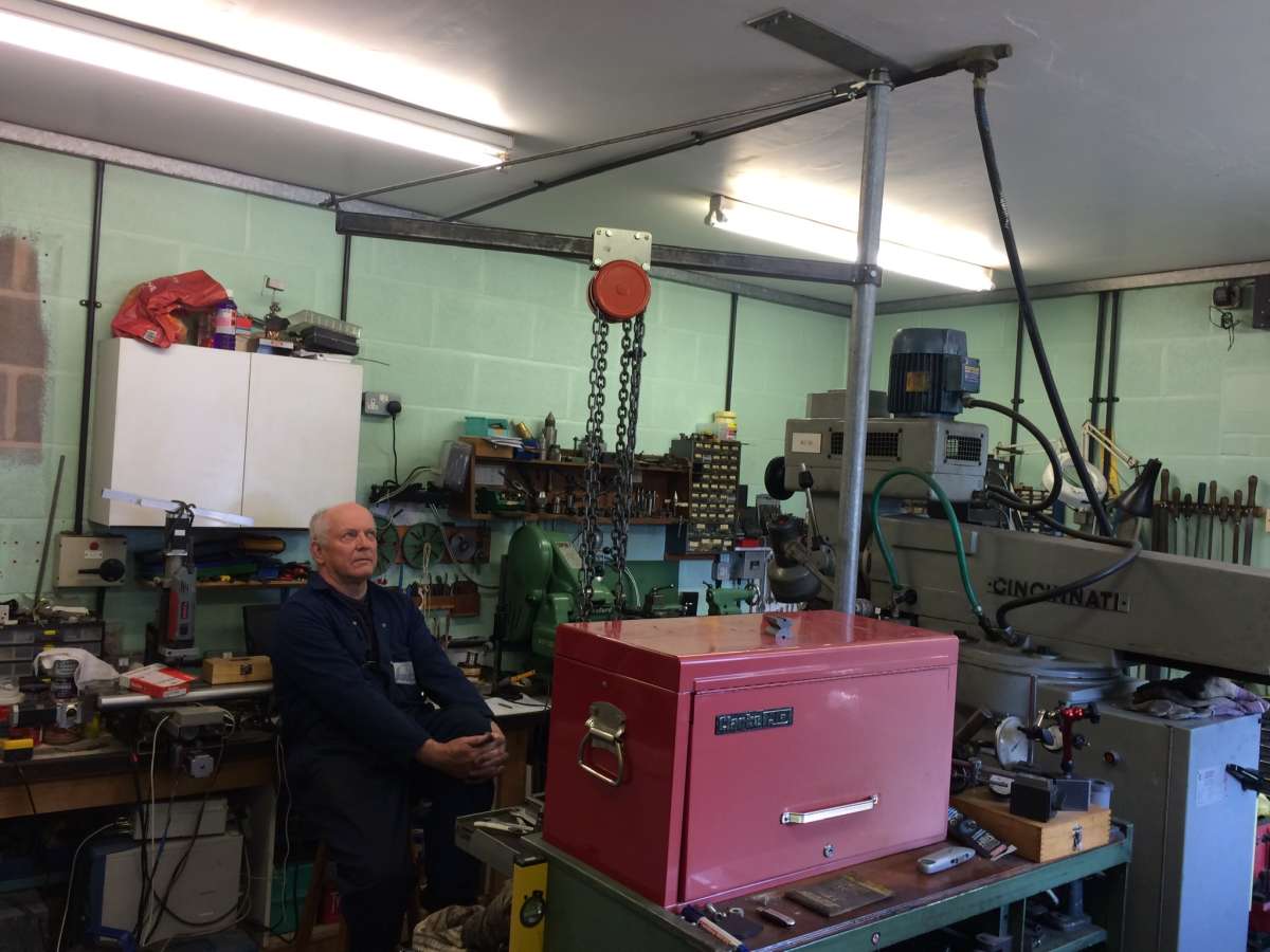

                              I had a similar problem so I designed a pillar crane that uses a Clark 500kg pulley block.
                              It runs on 40mm square box section and has a length of scaffold pole for the upright. The diagonal tie is 10mm threaded rod. The scaffold pole sits in a taper roller bearing on the floor and has a plain sealed ball bearing at the top.
                              I now have two of these units, one for the mill and one for the lathe. Their swings overlap so I can do transfers as well.
