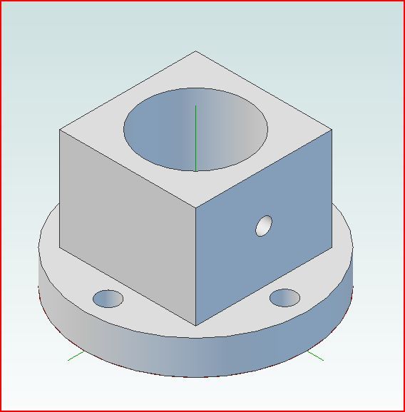

      What is the best way of holding something on a rotary table (I haven't got the rotary table yet!).
      I need to mill the outside diameter of 83mm diameter aluminium round bar to make a flange. What is the best way to hold this, do I need to buy a chuck?

                      If you could give more information it would help, for example a sketch of what you are trying to make showing what needs machining. Will it have bolt holes? Will there be a hole through the middle? Do you need to actually machine the OD or face round one end, or what? Do you have access to a lathe?

                          I need to make something very roughly like this, except this is a picture of a bearing not a flange, but it is approximately the right shape.

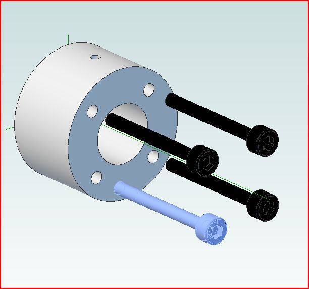

                          A 11/2 inch steel shaft will fit inside the flange, secured by set screws. The flange will then be bolted to a 15 inches diameter wooden pulley.

                            I think I would describe that as a flanged boss or bush. If the 1.5" shaft and 15" pulley signify quite high power transmission you may need something more than set screws to hold it – at least a flat on the shaft or better a key.
                            I assume the plan is to bore the boss out on the mill – how do you get the ends flat and parallel first? But back to your original question, using a mill I think the best approach is to face the ends, drill the centre hole to a suitable diameter for a big bolt to clamp to a rotary table (M12?) so the hole is concentric with the table (would need a threaded fitting for the bolt in the centre of the table), mill the boss down to the flange, spot drill the bolt holes in the right position, remove from table, drill out bolt holes, refit to mill and finally centre the spindle over the hole and bore to size. Not a natural job for the mill (except the bolt hole circle), would be trivial on a lathe. Are you sure this is the right approach for what you are trying to do?

                                Why not make life simple for yourself, rather than buy a rotary table or use a boring head to do the outer diameters as per your other thread just make the part more suitable for production on the mill.
                                Clamp as I suggested on the 83mm OD with shims between the sawn end and MILL table to set the billets sides vertical and then maching the top face flat.
                                Turn it over with the newly machined face on some parallel packing to raise it off the mill table again clamping against the 83mm OD. Drill and bore the internal hole and then simply mill the sides square as there is no reason for them to be round. While set up like this drill the 4 mounting holes.
                                The 83mm OD of the flange is not critical so can be left unmachined.
                                Even simpler would be to just leave it all 83mm dia, drill and bore the hole but tap the four mounting holes so you can pass bolts through with their heads on teh timber disc side

                                              Thanks for all the advice. I should have realised that I can mill the sides square. In which case I don't need a rotary table to do this. On the other hand I think I may need a rotary table for something else,
                                              I will hopefully get this done over the Christmas holidays. Most probably I will cut keyways in the shaft and flange to secure the shaft better. I will write again when (if!) I get the flange finished,
