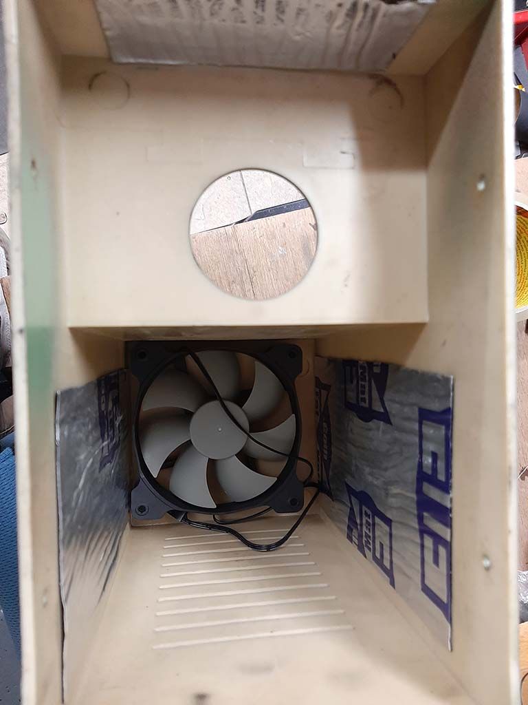

                              Had a look at the current setup.
                              Using a jos stick to see the flow of air, the fan is at the top of the motor and draws air from the bottom of the motor and exhausts out the top of the motor. However what is very telling is until the motor is spinning at about 900 there is little to no air being drawn in.
                              So basicall the motor is starved of air at low speed, just as you said. So I am going to route out a 120/140 dia 12v computer fan and mount that iside the cover with a suitable hole cut and suck air out. I am also going at add some holes at the bottom of the cover so more air can get in.
                              All I need to buy is a 12v supply for the fan
                              Edited By petro1head on 22/02/2020 19:11:12

                                If you use a 12V fan similar to those found in computers then a relatively small wall wart psu will be adequate and they are only a few quid each from the likes of CPC or Ebay etc.
                                Fitting one directly to the motor could be problematical if there is a motor reverse function as then it would be opposing the air flow from the motor. However being aware of this and not running it for extended periods in this mode would mitigate this problem.

                                  Possibly a few holes at each end of the glassfibre motor cover (So that swarf cannot get in) may help extend motor life.
                                  My lathe used to eat Q H worklight bulbs. Took it apart, and filed, a couple of 8mm dia slots om the rim of the "reflector". Bingo! Lamps last MUCH longer; can't remember when the last one failed
                                  ASKING for trouble!
                                  So a little extra cooling air might work wonders in lowering temperatures below some critical value that divides LIVE from DIE.
                                  Howard

                                    Sounds like good plan with a 120 mm computer fan on the inside of the cover, As Martin points out that running in reverse may be a problem running in reverse,
                                    The computer fan will cope at low speeds. How many times will you be running in reverse at highest speeds if a problem switch off the auxiliary fan.

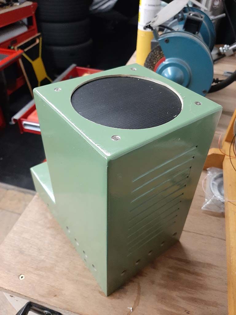

                                      Can't say I have ever run in reverse but a valid point.
                                      So this is what I have done, 120mm Corsair 12v Fan (140 was just a tad too big) exhausting out at the top of the encloure and several 10mm holes at the bottom
                                      I remembered I already have a 12v supply going to the Angle Eye LED around the quill so can tap into that. Jobs done
                                      Edited By petro1head on 22/02/2020 20:31:11

                                        Looks good make sure that the fan has a duct to the top of the motor to get the full airflow over the motor and not bypass it by just ventilating the cover.
                                        #453652
                                        petro1head
                                          @petro1head
                                          Tbh I suspect the fan is probably only a few mm from the top of the motor but will check

                                                      Usual practice on industrial DC motors is to have a separate blower mounted at the non-drive end forcing filtered air through the motor to exit through louvres at the drive end (should be a picture below)
                                                      **LINK**
                                                      The airflow is usually substantial & is frequently monitored using a flow switch downside of the filter to check for filter blockage. The centrifugal fans are directional – they will move air when running in reverse, but at nothing like the output when running correctly – think summer breeze versus winter gale !. A Gildemeister lathe at work had to have the 22Kw main spindle drive motor rewound due to the previous owner having changed the blower motor bearings & wired it running reversed when replaced – both the armature & field windings cooked at the drive end due to inadequate airflow & the rewind cost £5K 10 years ago + £1k for the Baumueller drive repair, as the failed field windings took out the field controller.
                                                      On your machine the airflow needs to be through the motor, not over the casing – the heat is generated in the armature windings & they are what fails. I would look to removing the internal armature "fan" altogether to reduce resistance to airflow though the motor & duct the external fan airflow into the non-drive end near the brushgear. to maximise air through flow.
