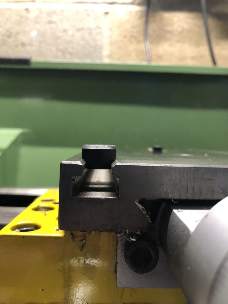

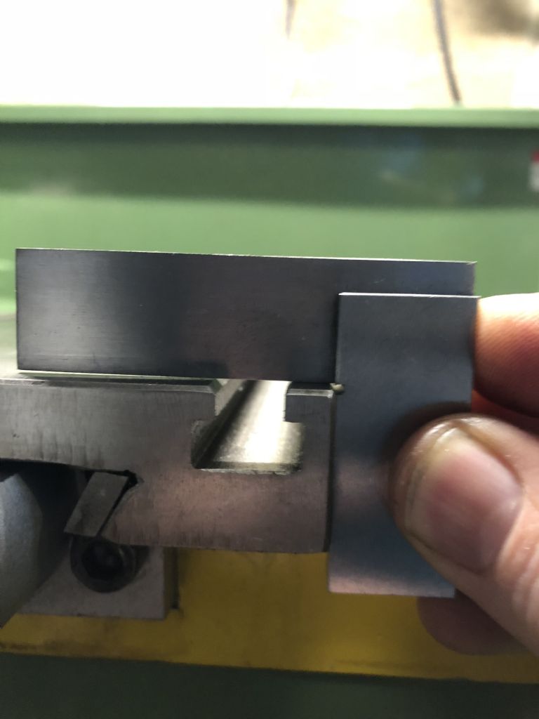

      I took delivery of my WM 240 and have it sitting pretty on its stand, overall the quality is ok, however there appears to be considerable grit like deposits everywhere which I can only think is cast iron from the finishing process. I had to rebuild the compound today as it was super gritty, dismantling it the finish is very poor and the gib is particularly bad, anyway…

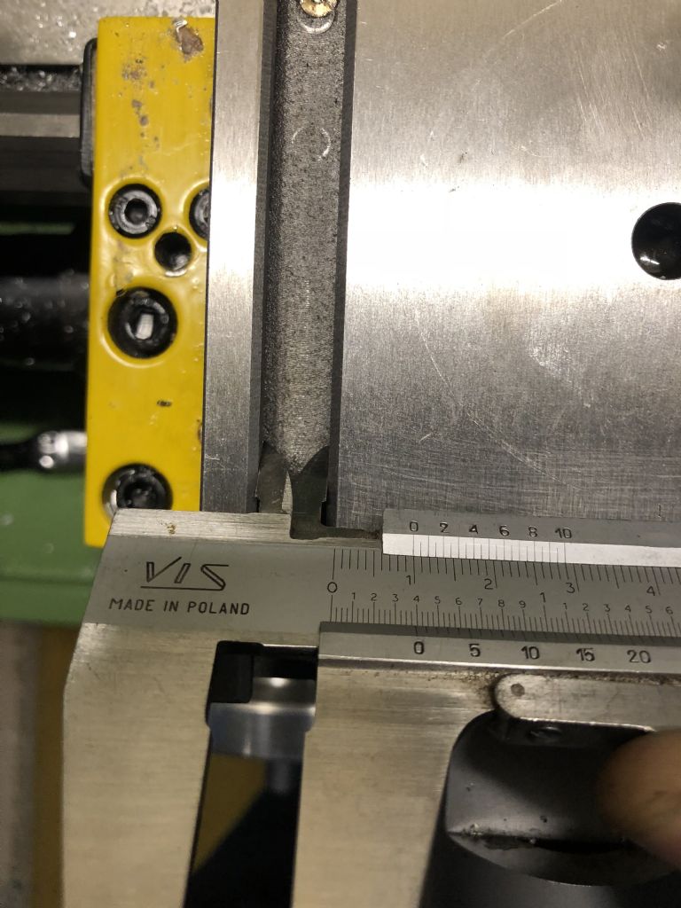

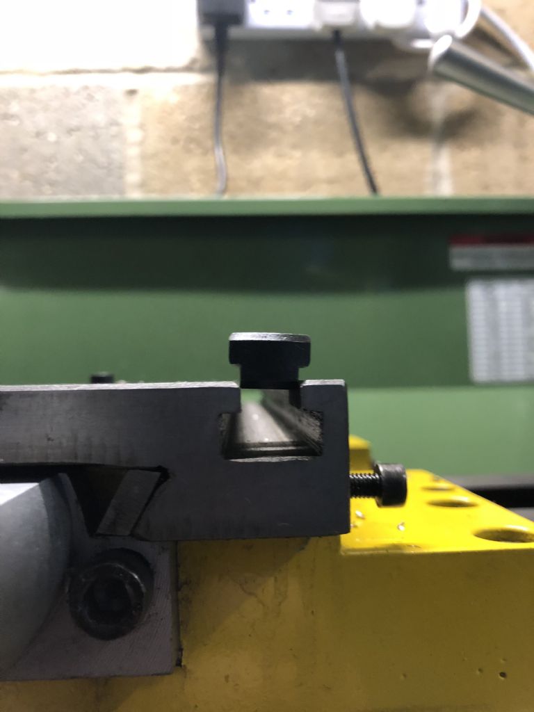

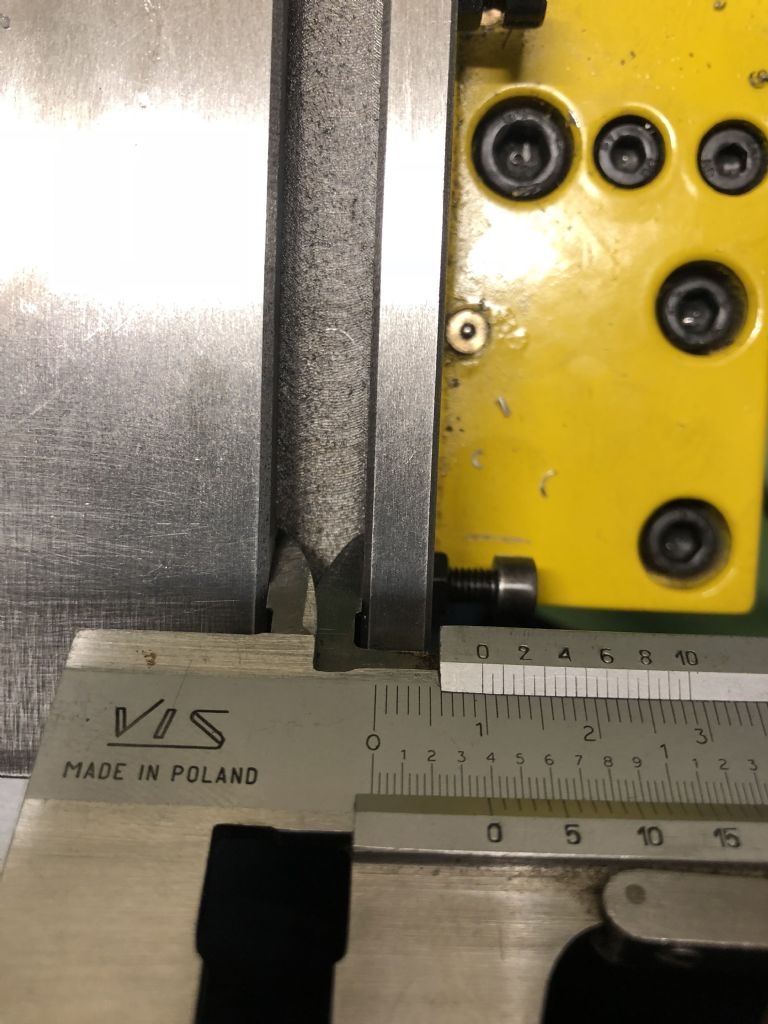

      I ordered the vertical mill slide and cross slide adapter plate, when I went to fit this today I noticed the cross slide isn’t square and the right hand tee slot is out (narrow), I have contacted Warco to see what they can do but wanted to get opinions from an informed community on if this is acceptable, especially the cross slide error and if this will be transferred into the compound, tool post, tool etc.
      Many thanks in advance!

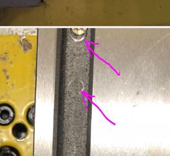

          Second from last photo shows two round marks in the bottom of the tee slot which are likely to have been caused by a bolt or stud bottoming out. The topslide usually has Tee bolts so unlikely to be that, have you bottomed out a bolt when trying your milling attachment? This is not good as it can snap the top out of the tee or distort the whole cross slide.
          How flat is the top of the cross slide as in theory the sides are not critical. Lack of a complete circular mark left by the top slide suggests it's hollow.

              They are all close to the edge, same as my 280 and not been an issue in 11yrs. But if jacking studs or cap head screws into the bottom of the tee slot you are taking a risk.

                I would run a dti across the crosslide top surface in both axis to check for distortion or for slope , out of interest I just did this test on my 1963 Harrison L5 crosslide and the total indicator reading over the whole crosslide slide surface was 0.01 mm which is about what I would expect , I would get in touch with Warco and just ask what the shop tolerances are for the crosslide ,and if yours is significantly worse what can be done about it , I know Harrison back in the day for example sent each new machine out with an inspection test sheet with all the parameters checked against shop tolerances.

                  It's important – especially for vertical-slide milling but also to a degree for compound slide work – that the top surface of the cross slide is parallel to the saddle movement in the vertical plane; otherwise the vertical slide will be out of square to the spindle with all the problems that would go with that.
                  You could test that with a dial gauge mounted so that running the saddle back and forth would show any deflection.
                  Both the cross slide T-slots on my WM250V let a 10mm silver steel bar in with an easy fit – maybe a 0,1mm or so clearance.
                  Your top photo prompted me to put a square against the cross slide edge and top surfaces on mine, and they're also somewhat out of square, though I can't see that it would ever matter given the parallel top surface. I'd not been aware of it in 3 1/2 years' use of the lathe.
                  And mine too appeared to be covered in places with coarse grinding paste when I got it. I washed the stuff off with white spirit and thought no more about it.
                  Edited By Mick B1 on 27/11/2018 09:48:13

                            The marks in the right tee slot were there when the lathe came, the tee nuts and bolts which come with the base plate don't bottom out.

                              It was the LEFT hand tee slot I was commenting on, two rings as indicated, the cap heads that hold the adaptor plate to the cross slide via tee nits would be the likely candidate.screw marks.jpg

                                #382558
                                  So it is, I probably meant to say second up or next from last, it was early in the morning.
                                  However would you agree that they look like a screw or stud has gone beyond the bottom of a tee nut?

                                    Jason I not helping myself here – I did mean the right!

                                      That cross slide is badly warped. It's not sitting on the ways properly and the tee slots are all skewed. Even if you're past your warranty I would raise it as an issue with the retailer.

                                        Posted by JasonB on 27/11/2018 13:57:50:
                                        Absolutely … 100% yes

                                          I'd agree it looks like something has been 'mis-tightened' and I can see that distorting the slots.
                                          In the second photo the other part of the t-slot appears to be ground square but pulled upwards which suggests it's been bent out of shape rather than badly ground. That would also explain the slot being slightly narrow.
                                          This might not be obvious when used in normal lathe mode

                                                Could be that they machined the top surface and tee slots first then used those to mount the slide inverted to machine the bottom and vee ways.

                                                  I would not be surprised if the table was machined from the end of the original billet. A likely case of using every bit of the billet possible.
                                                  In the old days, castings were ‘weathered’ for a few weeks or months before final machining took place, to avoid such movements after machining. ‘Just in time’ methods have rplaced the large inventory of rough castings.
                                                  Same occurs with timber – the ends are often needed to be discarded after seasoning – usually evident by some splitting at the extremity.
                                                  Question: is the bed OK at the other end?  That might be a pointer.
