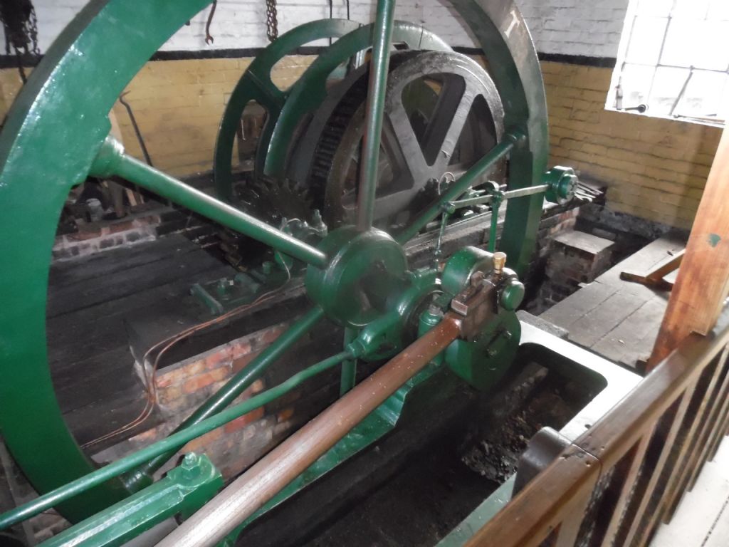

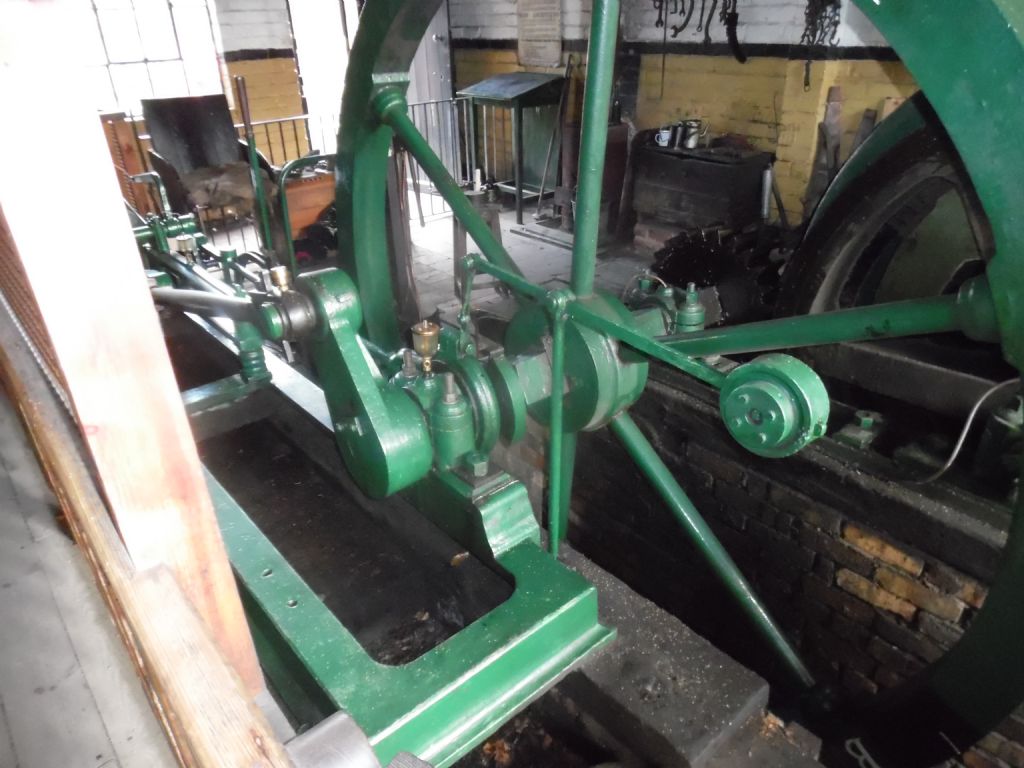

        The winding engine at Blists Hill Museum has a counterweight arrangement which applies an upward force to the eccentric. This seems to be a feature special to that type of engine. I've also seen one at the Black Country Museum which uses a tension spring for the same purpose. I've heard a number of different theories as to what the purpose is. Can anyone give a definitive answer?

          I thought they were something to do with the slip eccentric when reversing the engine

            Maybe it just balances the weight of the metal of the eccentric strap and the eccentric rod. It looks to be quite a weighty mass and it is always acting downwards if there is no balancing weight. this would cause wear at the top but not the bottom of the strap. The direction of the horizontal forces for the eccentric rod are going to be balanced by the backwards and forwards motion of the valve gear.

                My guess would be is that it stops gravity from pushing the cam forward. Consider that the cam is effectively a crank with a short throw. If force is applied in an appropriate direction, the cam can be pushed round. Normally the cam is dragged around by a pin, however, there is nothing but friction to stop the cam moving 180 degrees infront of the driving pin.When the cam goes over its top-dead-centre the weight of the eccentric could potentially flip the cam 180 degrees foward.

                    Some interesting thoughts there. It hadn't occurred to me that the engine had a slip eccentric, but obviously it must if it is to operate in both directions with just one eccentric. I was previously thinking it might have something to do with the need to stop the engine at a precise position to align the cage with the floor, but if it was just a question of balancing the crankshaft it could probably be done in a simpler way. I like the idea that this is more a slip eccentric feature than a winding engine feature. Could it possibly be just to reduce friction so the "slip" happens reliably?

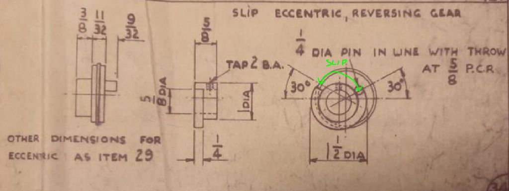

                      Perhaps I should not have called it a cam. I'm talking about the eccentric disk which, if I've understood the mechanism correctly, is not keyed to the crank shaft. It is free to rotate 180 degrees with respect to the crank. May be easier to undertand by considerering that the eccentric can change either plus or minus 90 degrees with respect to TDC of the main crank. This provides the necessary valve timing changes needed to reverse the engine.
                      Engine direction is determing by the direction it is pushed to start with. Provided the engine is not stopped with the piston at TDC the driver can re-start it in either direction by moving the valve gear handle which is then picked-up by the gab.

                        Being pedantic (who me) it rotates somewhat less then 180 degrees between forward and back.

                          I think Pete has figured it correctly in as much as it makes sense that you don't want the weight of the eccentric strap to push the eccentric disk ahead of where it needs to be on the shaft.

                            Yes would probably be about 120deg of rotation if ecc leads the crank by 30deg as the slip is usually the shorter angle between the two positions.
                            But it is free to rotate.

                              Some stationary steam-engines were manufactured with a slip-eccentric screwed to a keyed clamp-plate. This was to set during installation, the permanent running direction for its intended use.
                              The Mann Steam-wagon gear is a slip-eccentric operated by a mechanism on the crank-shaft itself.
                              Note that although the Blists Hill engine's slip-eccentric is rotated round the shaft to work, other ways are available. Examining the drawing (by LBSC?) quoted by Jason, shows that though that eccentric too turns, moving it in a straight line will achieve the same result; and some engines I think including the Mann, were built in that form. The eccentric has a straight slot sliding across flats on the shaft.
