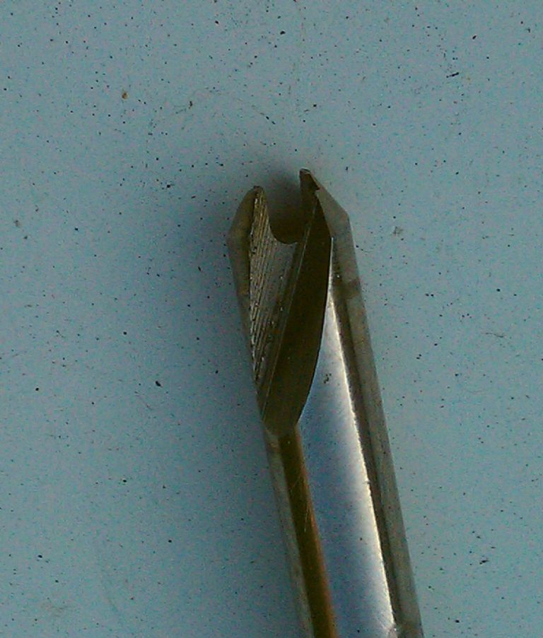

                              Here's an alternative way of dealing with a broken off centre drill.
                              I actually took the bit I broke, ground the notch with a Dremel and was able to recover the part I was making without wasting more than 10 minutes.
