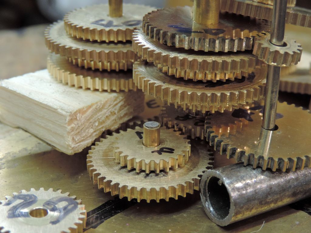

                                        This is where Art Fenerty come into the equation. Art after writing Mach 3 and retiring and selling it on decided to build a clock but wasn't happy with the software out there. Whilst a lot of it looks good, mathematically it's crap.
                                        So Art wrote his own called Gearotic, OK stupid name but so is Apple wink
                                        By taking multiple shaving cuts after blocking out the tooth space whilst raising and moving the cutter and at the same time rotating the blank it can mimic the Sunderland gear planer.
                                        A selection of 4 gears done in bronze, 2 spur and 2 helical's. The steel helical was an early iteration when Art was still working all the maths out and hadn't got the correct helix angle worked into the formulae.
                                        All done with an off the shelf 3mm cutter.
                                        You can also make specials which you can also do by any of the other generating methods listed above but not by using form cutters unless specially made.
                                        Three gears, 13, 14 and 15 teeth but all cut on the same blank. Only 14 is correct but you can mix and match these in any position.
                                        This tooth shift is often done in industry to give stronger teeth or more contact. It helps when cutting low count gears when the pressure angle is low as it stops undercut.
                                        In fact when I cut our version of the Myford screw cutting gears I cut the very popular 20 tooth on a 21 tooth blank to give a far stronger tooth, the ration believe it of not is unchanged.
                                        Standard 20T on the right, modified gear on the left.

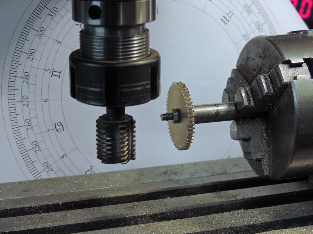

                                                And Duffer's Mk1 patent Medieval version:
                                                Seriously though, Neil pointed out in another thread that I'd over-relieved the teeth on this one. Quite right.
                                                Nonetheless I successfully used the cutter to make eight aluminium and two brass gears, each 1/4" across. The cutter is still sharp but a careful look at the picture shows that one of the lower teeth has lost it's tip. I expect more damage later this afternoon when I try it on a steel blank.
                                                I'm impressed by this method. The cutter is a lot easier to make than an equivalent form tooth for fly-cutting.
