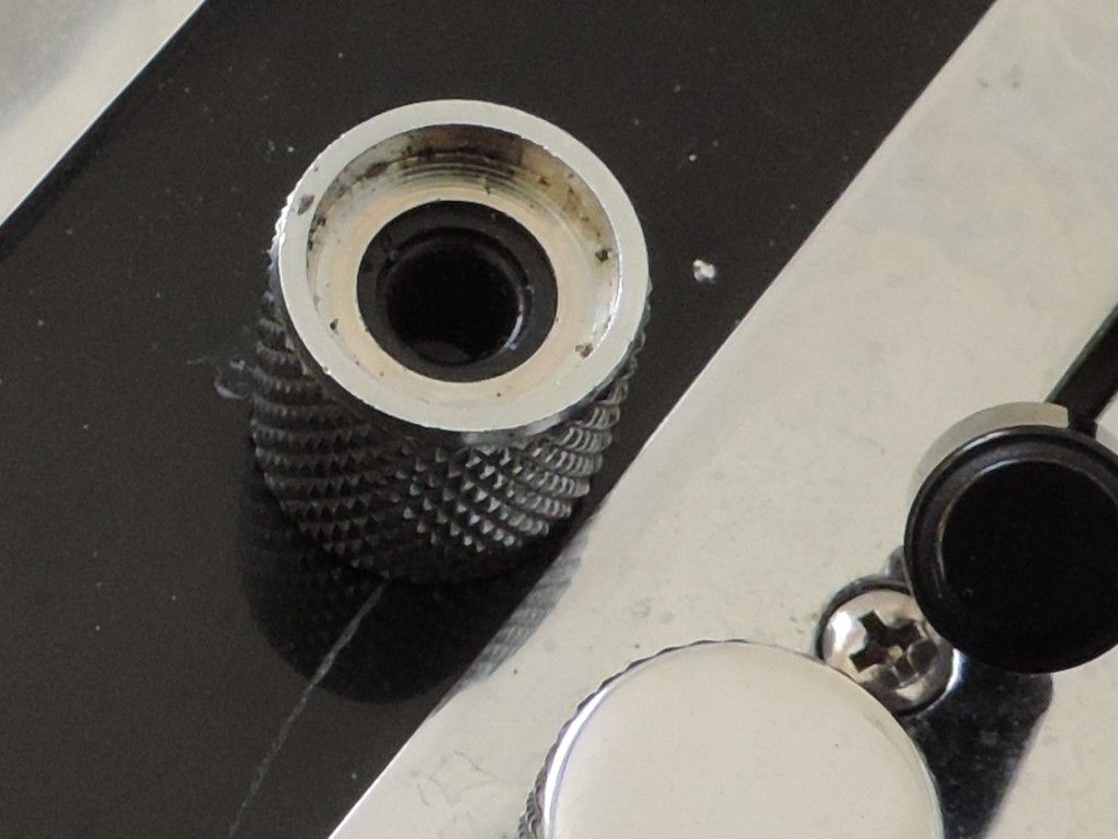

        Hi everyone,
        Are there any plastics gurus on the forum?
        I'm looking for a plastic that is machineable, gives a little and can be bonded to brass.
        I am trying to make some plastic internal sleeves for those brass volume and tone knobs I made. The plastic will be 10mm diameter bonded into a blind hole in the brass and then rotary broached to take an 18 tooth serrated spline (potentiometer shaft).
        The original brass knobs were broached directly into the brass but the tooling to do that is very expensive and differences in tolerance and shape of splines across the many potentiometer manufacturers is surprising, hence the need for the plastic to have some 'give' in it, hopefully one size will fit all.
        Thanks, Ed.

            Hi, thanks Jeff,
            There are no setscrews. The knobs will be just a push fit as per the original and the potentiometer shaft has a split through it's splined length, providing a compression type fitting. The spline will be cut into the ID of the plastic sleeve.
            I've seen examples of the plastic knobs with the brass insert but those inserts are two-part and fixed with a screw under a plastic cap.
            I'll try to get a sketch sorted for later.

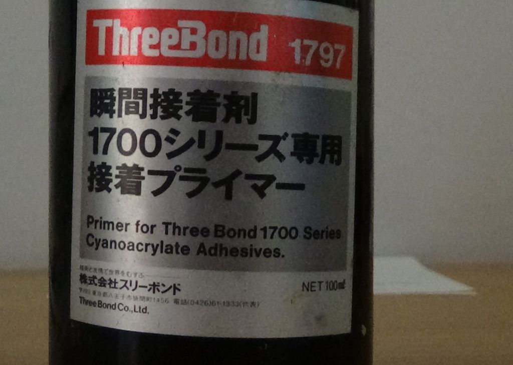

                            I’m unclear about p.acetal but I have in the past used an oxidising primer called ThreeBond 1797. (See photograph and link below.)
                            The label shows it to be for cyanoacrylate adhesives, and I’ve used it to prime polypropylene with some success. The bottle holds 100ml, but how much it cost I can’t recall.

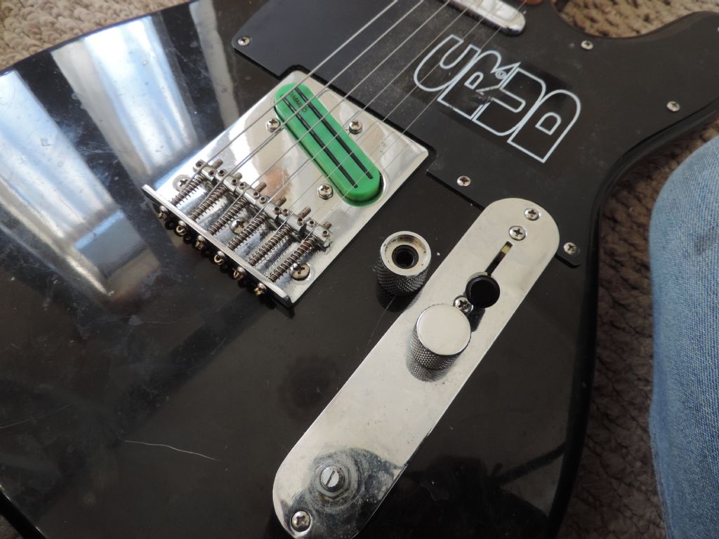

                                                    Just a thought… this here Telecaster on my lap has nickel plated brass knurled knobs with pressed in soft plastic inserts… O.K. it's a Korean Squier, but probably the tightest fitting knobs on any of my guitars and if it's good enough for that…?
                                                    P.S. by 'only a volume knob' I was meaning that some of teh stress/duty observations seemed better suited to 'heavy duty' applications (I suppose the guitar could be meant for Paul Simonon though…)
                                                    Edited By Neil Wyatt on 04/05/2016 18:27:48
