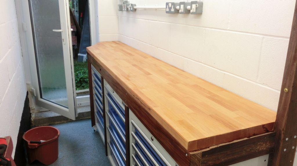

          Hi folks
          I have finally been able to get some woodwork done and the depth of the bench is now 500mm.
          I have had a good look at the SX2.7L, there is a fair chance it will fit. A 3.5 is just too big.
          The Warco WM16B is looking very attractive, its drip tray would fit on the bench,as its only 482 deep, 520 wide according to the website. I have been in contact and they are opening the demo room with gloves and masks mandatory, so I will pop over when I can.
          Its obvious that the Sieg has a deeper vertical casting which is bound to make it stiffer. At the moment the decision may be based on Warco being over an hour closer to my home.
          I have had a look on ebay, but "affordable" machines seem to be trashed, the rest seem a lot of money compared to a new Chinese machine with a warranty.
          Thanks for all the help, I will report what happens when I get round there, hopefully in a couple of weeks. . laugh

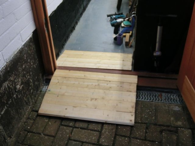

                              Roger Best
                                @rogerbest89007
                                Ramp sorted. The floor should have been higher but the builder gave up before a nice thick self- levelling screed had been laid so I had to do something myself.

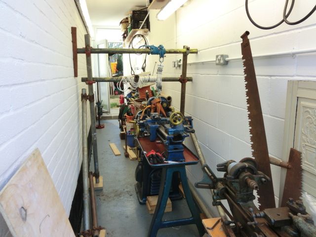

                                              #495772
                                              Roger Best
                                                @rogerbest89007
                                                wink The lathe was disassembled using a ratchet strap, ideal for raising it an inch. Unfortunately it wasn't so good at lowering several feet onto the horizontal sack barrow. Bit hairy that. I just wrapped the tail a couple of times round a pole for a brake and eased it down.
                                                The orange flash in the picture is that strap – very robust and useful.
                                                So I bought the pulley block hoist with the white rope. Utter Sh**. It is CE marked against a standard for electric hoists not manual ones, so you need to be able to pull 50kg on a thin rope. Hence the scaffold pole winch. Technically I think it is illegal and I would have sent it back were it not a collection of useful bits that can easily be improved upon to let me hang a bike from the ceiling.
