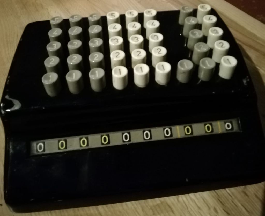

      This picture has been posted in a Facebook group that I’m a member of, along with a query as to what it is.
      Are there any knowledgeable persons here who can shed some light?
      Brian

          Sumlock Comptometer ?

            Posted by Peter Simpson 1 on 21/12/2018 21:09:17:
            But why only numbers up to 5?
            Brian
            #386975
              dont know It might be something special
              So far as I am aware [and I see that Brian has noted] all standard comptometers have buttons numbered 1 to 9 in each column.

                Agree it's a Comptometer – a mechanical calculator. My mum operated one until pregnancy got her the sack. (Me causing trouble even before seeing daylight!)

                  Got it !!
                  See "abreviated keyboards" and  "Comptometer Educator" on this page : **LINK**
                  http://www.vintagecalculators.com/html/operating_a_comptometer.html
                  P.S. My Auntie was a 'Comptometer Operator' at the Austin factory

                    Posted by Bodger Brian on 21/12/2018 21:20:08:
                    Brian
                    The advantage of having fewer keys is it saves desk space. The disadvantage is more keystrokes. Six is entered by hitting 3 twice, seven by 3 followed by 4, eleven was 4, 4, 3. (Eleven was necessary because of £sd.)
                      A bit more internet research reveals that it’s indeed a Comtometerg, with an abbreviated keyboard in order to cut down cost. To enter a number greater than 5, one merely pressed two numbers that added up to the required number. It’s claimed that some operators could work just as fast on such a machine, as their handspan could cover the whole keyboard, which wasn’t possible with full size machine.
                      Thanks for putting me on the right track.
                      EDIT : Looks like SOD & Michael G beat me to it!
                      Brian

                                  another way of adding '6' is to add 1 in the next column and subtract '4' from the original column. I am 72, and used several mechanical and electro mechanical ones at BAC Weybridge. I still have a small collection of them, but no real value to them.

                                      Yes… in my first job at the Equitable and Cooperative Society in 1965… ie The Co-op…I had the pleasure of using one for a full week but not like the one shown in the picture, the one I used had a handle , when you put in the amount to be added you then pulled the handle towards you and this was added to the last total..
