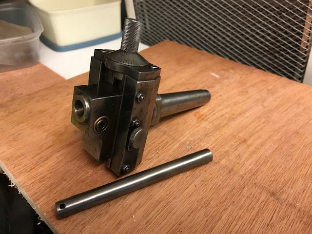

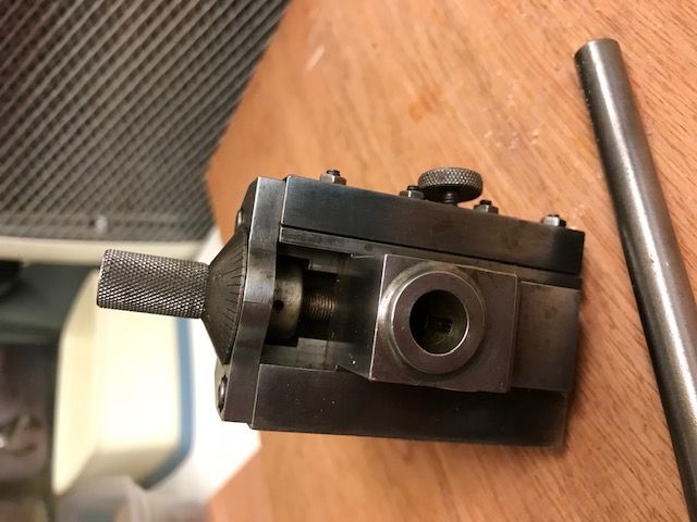

        image.jpegimage.jpegCan anyone identify the attached piece of tooling I purchased it a while ago but cannot remember what for. Also it's a 2MT which does not fit the Drummonds 1MT how easy is to recut / grind a 1MT ? In fact most of my tooling cannot fir the Drummond, do I sell it on and get new stuff.
        #391259
        Clive Brown 1
          @clivebrown1
          It's a boring head designed by G H Thomas and described in ME in the '80s
          I made one with MT3 and slightly bigger all-round. A good design typical of GHT.

            G'day Ian, It appears to be a tailstock taper turning attachment.
            It also appears to be nicely made with the adjustable gibs and graduated offset dial.
            Noway would I mess with the taper, to much chance of ruining it !

              Agree with Clive GHT boring head. I have one identical to yours.
              Can't remember if the MT can be changed. Will check tomorrow.

                nerdThe good news about the taper is I have found an adaptor by Proops on a well known auction site so can leave as is .

                  I would be weary of using a boring head in a long step up adaptor as you will not have a very rigid setup and with little chance of being able to use a drawbar you could find one parting company with the other.
                  #391283
                  Mike Poole
                    @mikepoole82104
                    The taper should unscrew from the body and you can then fit the mounting of your choice. The thread detailed in GHT’s book is 5/8×16 but the builder may have deviated from the design. It is quite a big item to use on a no.1 taper and would really need a drawbar to use as a boring head. Using as an adjustable centre for taper turning would probably be ok but a waste of a much more useful tool.
