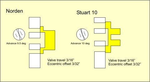

                    > 1) A two cylinder engine, whether single or double acting has the cranks set at ninety degrees to ensure self starting.
                    A 90-degree single acting arrangement won't self a start in all positions, each cylinder has a lot less than 180-degrees of push, so overlapping them guarantees a big dead spot. Look how the admission periods in this diagram:
                    These valve event diagrams show how two engines have admission much less than 180 degrees, and bear in mind that self starting can only happen for the part of the admission cycle between just after TDC and just before full valve closure. This means a 90-degree single-acting is actually less likely to self start than a single double acting cylinder. Such an engine also produces almost as uneven torque as a single-cylinder single acting eninge.
                    The simplest self starter (other than elaborate non-dead centre designs) is a three cylinder single acting at 120-degrees or a double cylinder double acting at 90 degrees.
                    I don't dispute your other points, but as your comment was presumably a reaction to mine about the french engine…
                    Edited By Neil Wyatt on 30/09/2014 17:46:31
